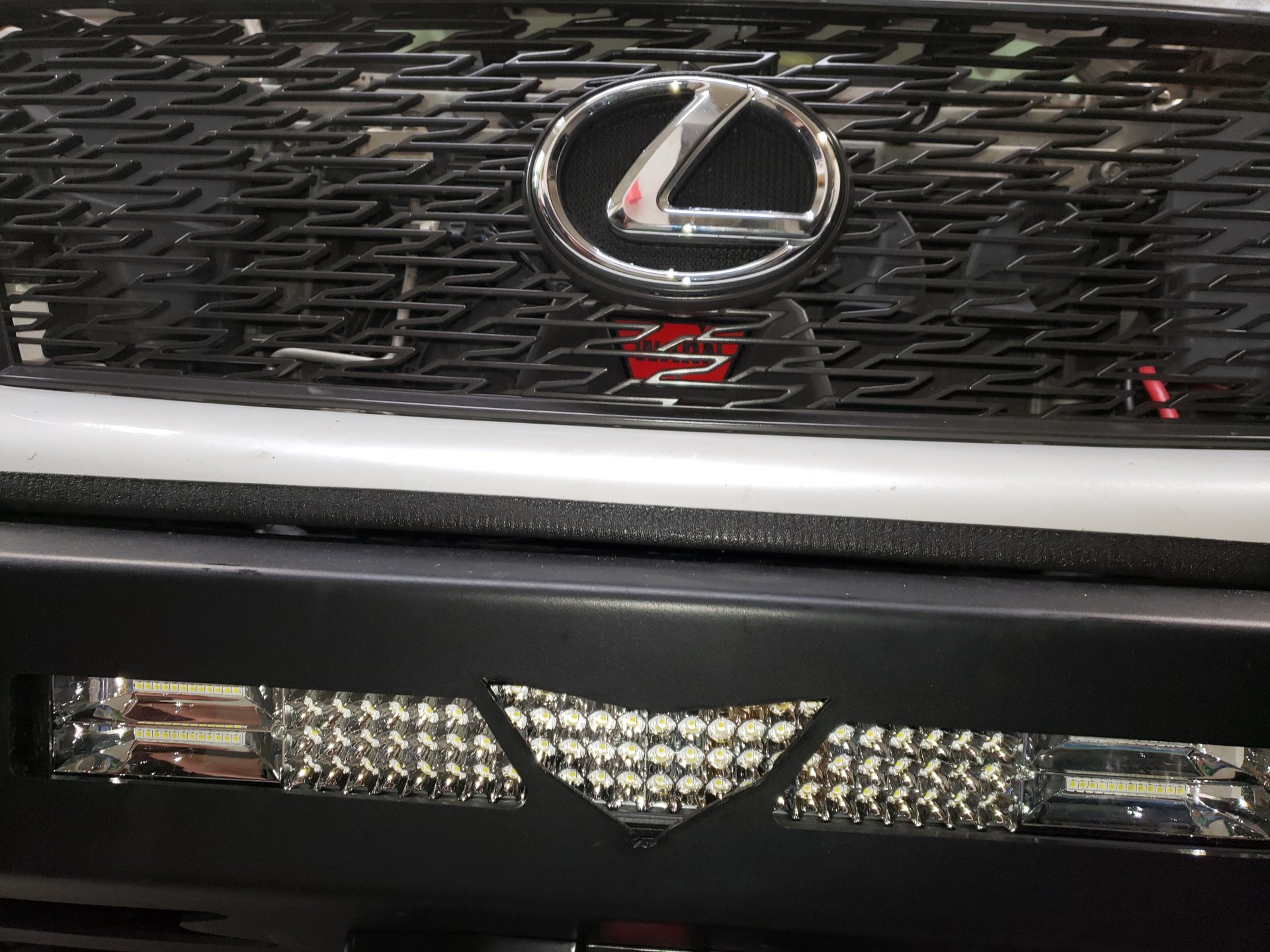

I don't see them, did you lose you headlight washers with the new bumper?
Shhh.... I'm not opposed to logo's, but like I say, I think it blocks a non-trivial amount of light. Put it lower and I'm down. I have Slee and RCI logos on my other junk.
Hmm that sounds painful, is the sponsorship worth the pain?

To get this kinda, sorta back on track, I think the Victory Strike install video was very thorough and helpful. Except for the part about "just install the bumper", lol. I am not about to admit how much time I spent on this, but I did it mostly by myself with the help of a hydraulic lift table and a rubber tire chock to keep the bumper roughly in the correct, upright orientation. I had to drill out the holes in the tie-in brackets for the PS line clamps, but Victory customer support was super helpful with dimensions, and it seems they're on track to fix that issue. For the 5/8" through bolt in the tie in brackets, I have never, ever, even once in my life been able to accurately center-punch the middle of a large hole. So I started the hole with the 5/8" bit, since it self-centers in the bracket hole, and viola, you have a nice, centered starting point. Of course I did this on the second one, after mangling the first one... Super long needle nose are helpful to place the washer and nut on the inside of the frame for those 5/8" bolts as well. There was literally no room for hands around the tie-down hoops. I found it much easier to remove the grill while installing the bumper, as it afforded much better access to the inner tie-in bracket bolts, as well as the winch and control box. Not sure about the 14+, but here's a CL link to removing the grill from the rest of the bumper (Here). I used some body trim molding on the cut edge of my bumper, and even still, I took the body bumper back off several times to shave more plastic off, especially near the wings where it might flex more. All in all, I ran into no major roadblocks installing the bumper, and found all the holes lined up nicely, bumper was nicely finished, and all welds looked good! Looking forward to the extra clearance, protection, and winch mount!
