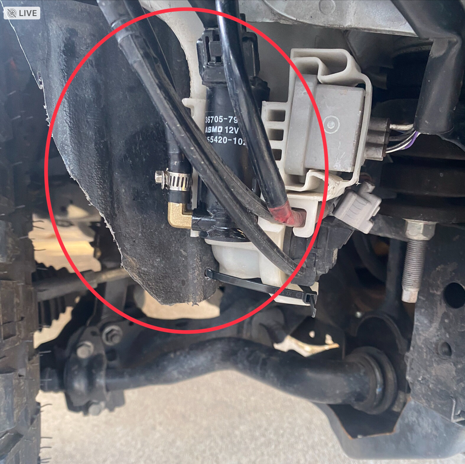

Did you come up with a solution? Waiting to see what to order to cover mine up.

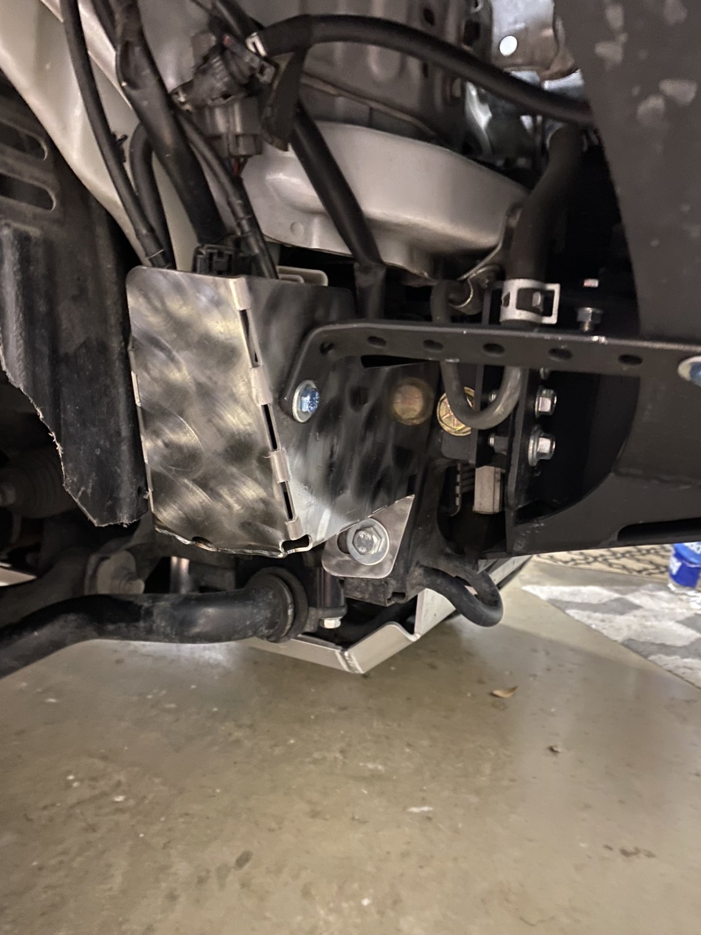

I think I’m just gonna give the CBI one a try, at least for the next dudes that have this issue. It’s measurements are 9x9x9. SSO doesn't list any on their site. It also looks like there is an additional mounting point. So hopefully it doesn't take 6 months to ship.
Just as a heads up, the CBI washer tank skid only works in conjunction with CBI bumpers. Soo looks like those of us with the headlight washers are kinda screwed.
The C4 unit worked great for me.

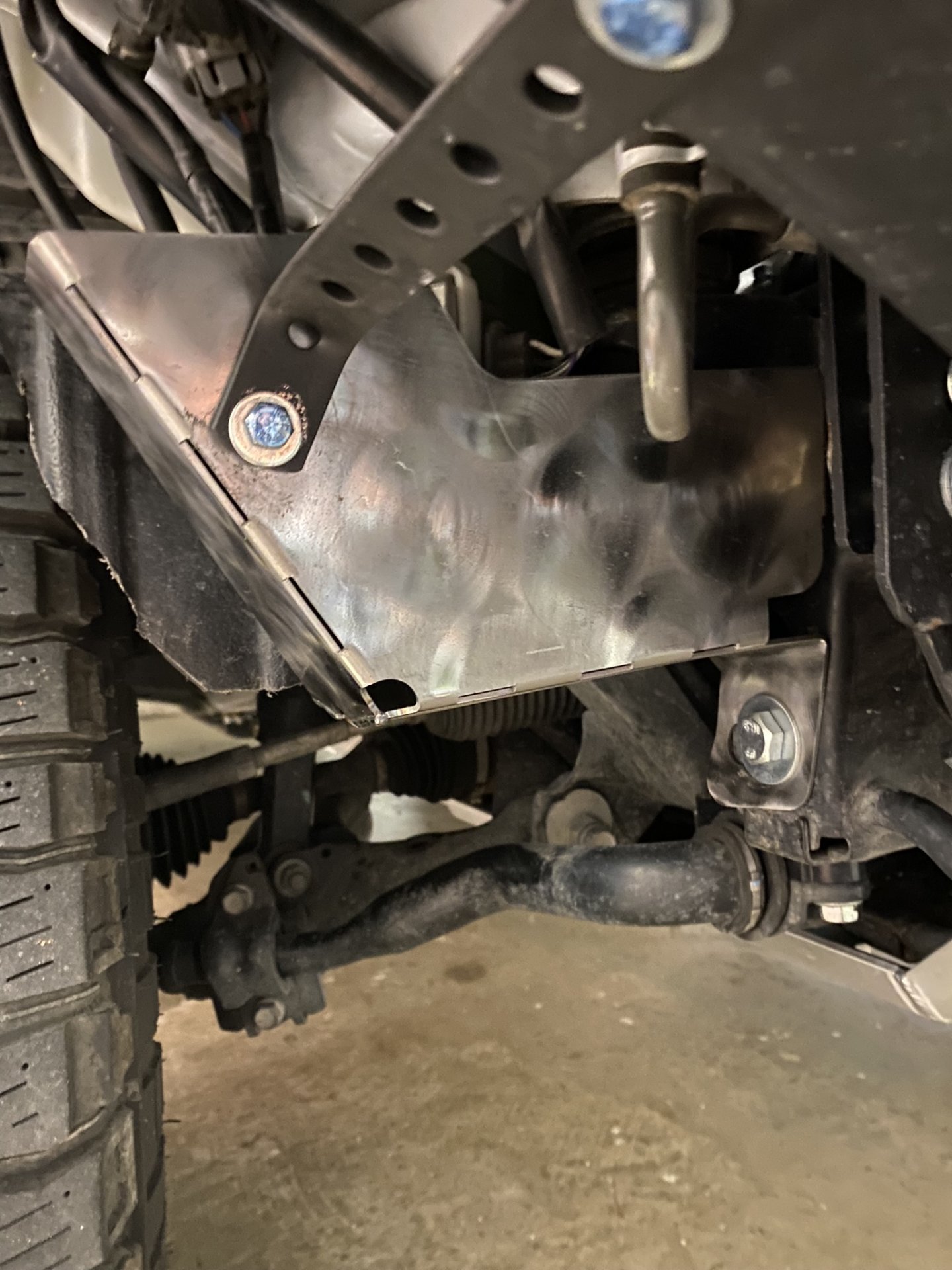

Awesome, I’ll order one today. Did you only have one mounting point to the body, on their website it looks like there are two. I'm not sure what tire size you have, but does it look like it’ll rub with 34s or 35s?
Look back on this post and you can see what I did. I cut off the upper mount on the bracket because i didn’t want to have to take out the 5/8 bolt or drill the hole in the bracket out to 5/8. A stud could be welded on the end of the 5/8 bumper bolt and you could use both mounts. I made the other mount out of a Garage door opener pull bar.
I just want to keep a stick out of the hoses and tank wires.
I’m running 275/65/18 Kenda tires. They don’t rub the box. I do touch the fender plastic occasionally. I need to get the heat Gun on it .
