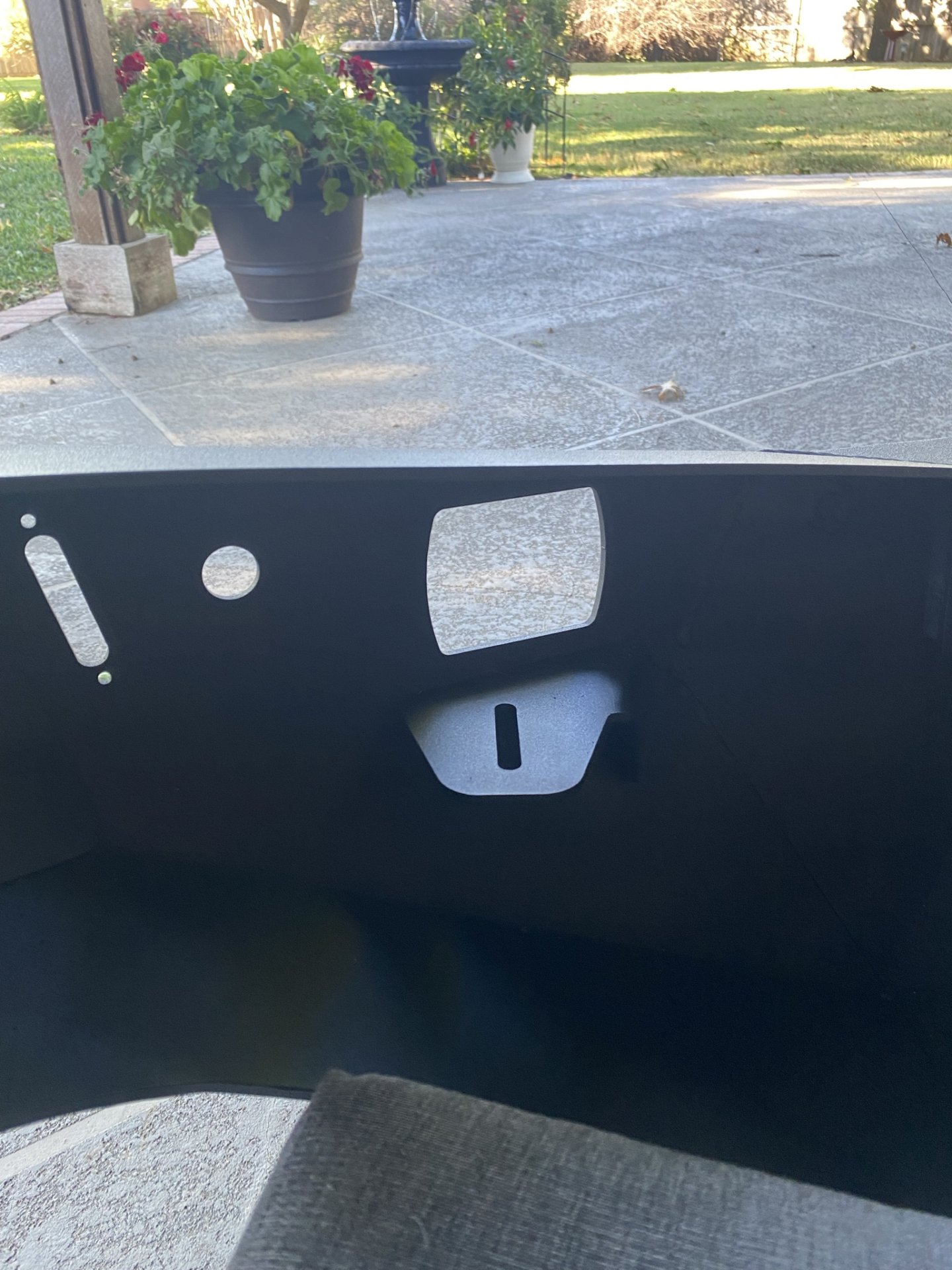

You will need to modify the brackets of your fog lights because the slot in the bracket in the bumper is not in the center. Use washers to raise the height as needed. Mounting everything to the bumper first saved my sore hands.

Yeah I found that issue Friday night. One would think that would have been better execution in the design phase.
Huge apology for this issue. The team is looking into why we have a batch like this with the brackets offset. Not sure how many were affected, but we will be sure it's handled.

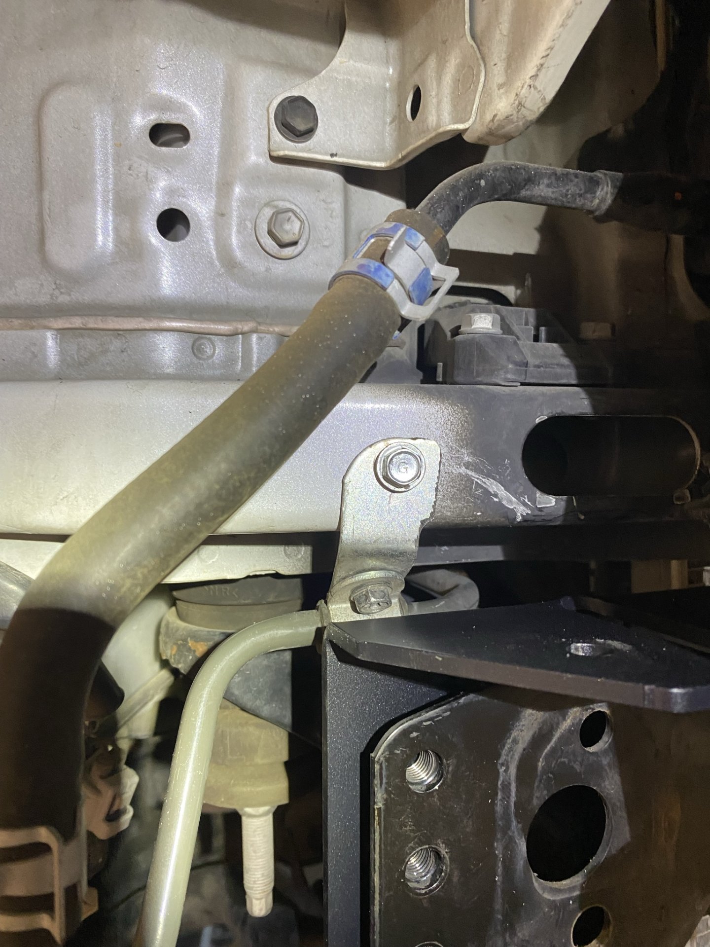

A couple more installation issues to be aware of.. if you are installing a winch be sure to place the frame horn reinforcement brackets on the frame prior to mounting the bumper up. With the winch in place (Warn Zeon 10S) we could not get them in to position and had the remove the bumper to do so. Second the same brackets did not come drilled for the “P” clamps to secure the power steering lines so unless you have a 90 degree drill motor and a zephyr bit you may want to pre drill those.

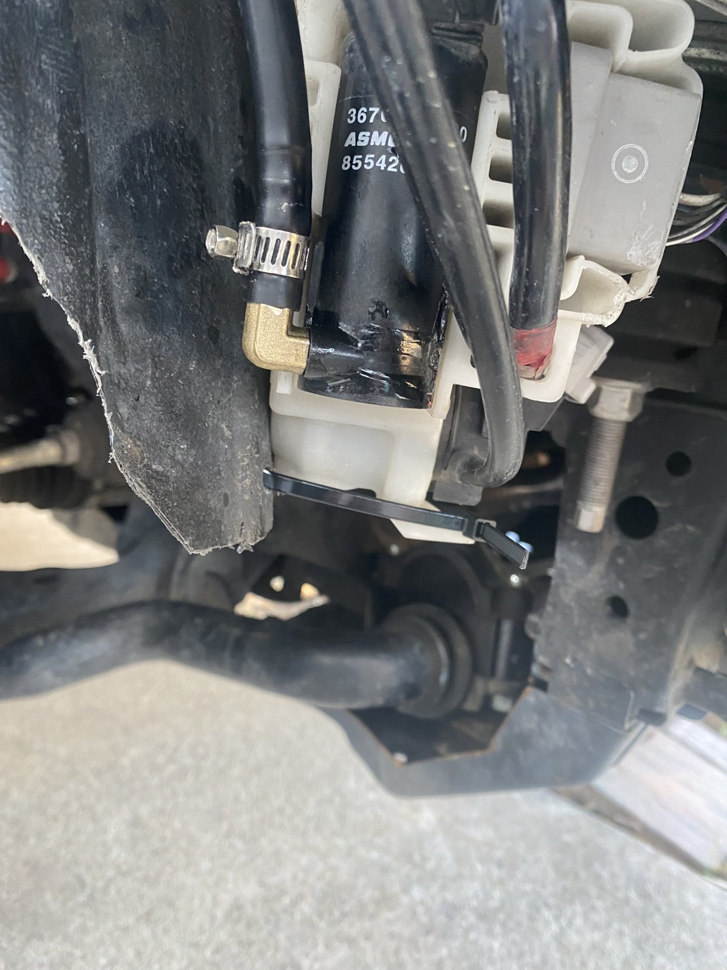

Washer Tank Skid. I am adapting a C4 part to cover my washer tank hoses. While fitting it in place I broke a very brittle head light washer outlet . It was very sloppy plumbing as OEM no issue for the first 100k until someone cut the bumper off a perfectly awesome car. I thought the head washer pump would fit better behind the skid box/plate if it turned a 90 upward just out of the pump. Pictures if progress. 5/16 x 1/4 brass elbow from Amazon.
Yeah, those brackets first is the move. Also, that bracket now includes the hole for the P clamp. We apologize for it not being there on your tie-in.
