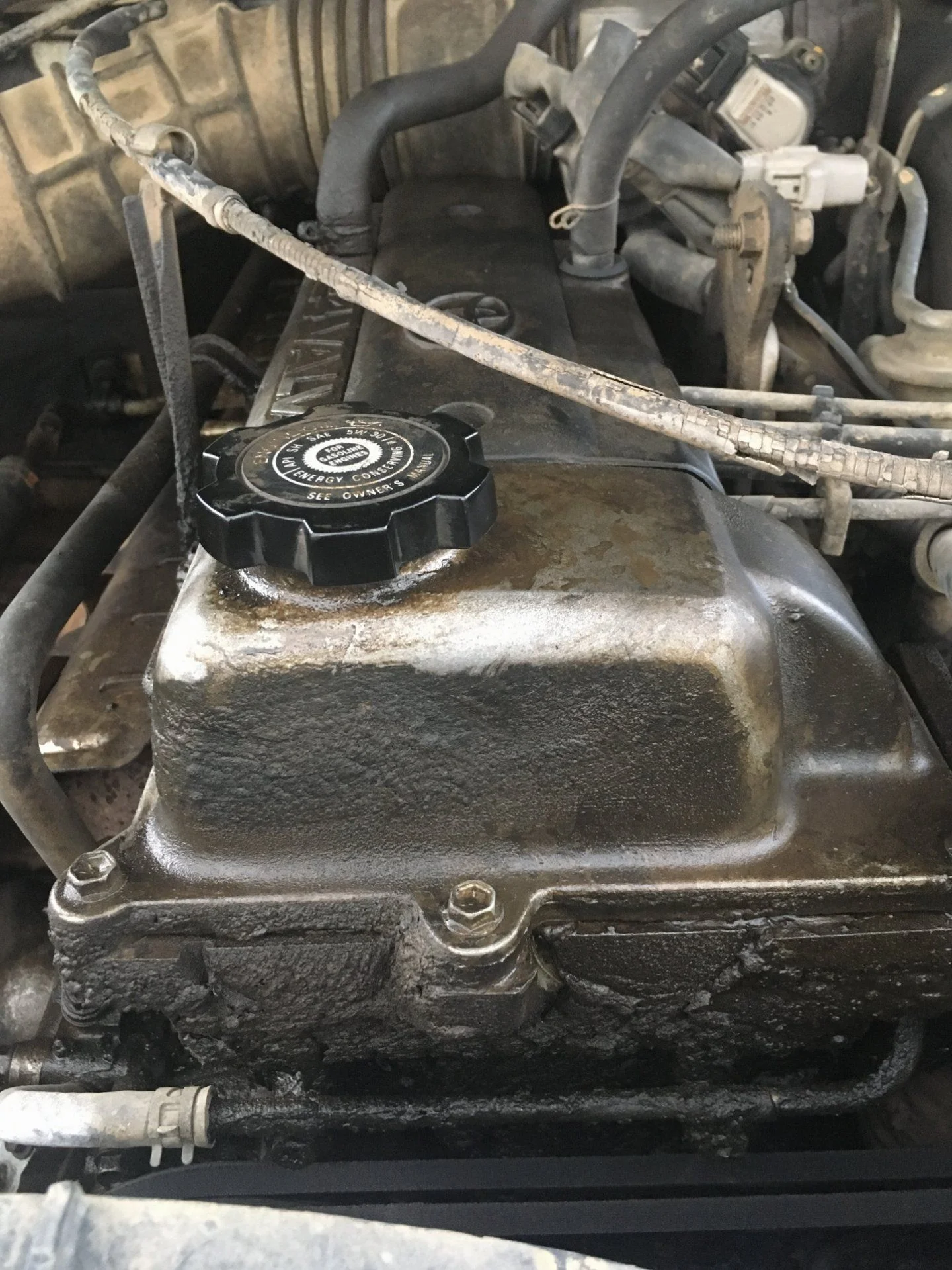

I am going to attempt to either repair this myself this weekend, or pay to have it done:( I am afraid that i will break something, or it will go wrong and then I have my truck stuck in the garage at work. That will be bad come Monday. I have the o ring for the Distributor and a gasket with spark plug donuts. I have looked thru the FSM and i could not find exactly the pages that related to this job. There is a section about removing the head I am guessing that i could just follow those pages and stop when the valve cover comes off. The worst part is that the whole top of the motor is covered in a desert dust/oil mix that looks like it will take hours to clean. I don't have running water accessible where the work will take place. I am pondering brining it ti my local mechanic, but I am afraid it will cost $600!! is there any thread on here that is a write up that i could go off of?

how bad is the leak?
First thing I would do is take it somewhere and power hose the engine. Spray some degreaser and then do it all again. Working on mucky engines not only pisses you off but you also risk getting dirt and sand into the engine. Once that is done take a few photos of where the different bits go and then get on with it. It is not a complex job by any stretch...
If you have basic hand tools, this job is perfectly achievable .. Just set aside 2-3 hrs max(if your not a experienced gear monkey) and your good. Just take the air cleaner tube off, 4 bolts on throttle body (set it aside) then the valve cover gaskets.. You might as well replace the 6 spark plug grommets/seals and the pvc valve and rubber grommet..
My first question too! When I did mine I learned that the bolts at the back of the cover were barely finger tight.

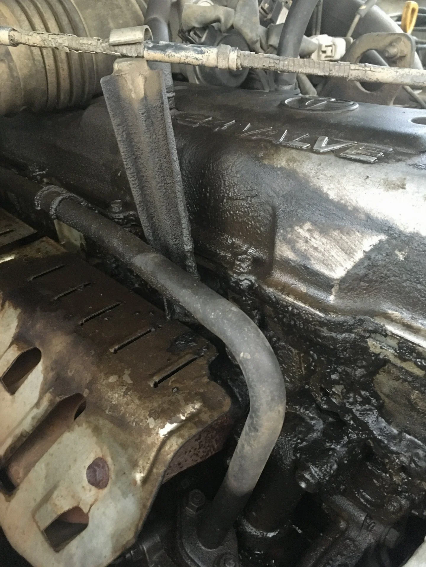

Yep, that's been leaking heavily for quite some time.
What you are going to find is your Valve Cover Gasket has dried out, gotten brittle and is broken in one or more places. The new one should stop the leak (from the valve cover) 100%, but you've got some serious engine cleaning to do. Your throttle body gasket is probably metal and often times can be reused, but they are not expensive (less than $20.00) so might as well replace. Dizzy O-ring and Oil pump Cover are other areas that tend to leak oil over time, might look at them later, but most of your trouble is the VCG.

I found the leaking dizzy o-ring created the biggest mess over time. It would drop down onto one of the belts and the belt would then help "distribute" the oil all over the place.

I am guessing that I will have some serious cleaning to do. My plan is to spray down with simple green and let it sit for a few hours. Then spray again after work and hit it with a garden hose or pressure washer. I am a bit worried to blast with and serious pressure I am thinking he wide angle pattern should work. He other alternative is rags and elbow grease which will take take days I fear.
