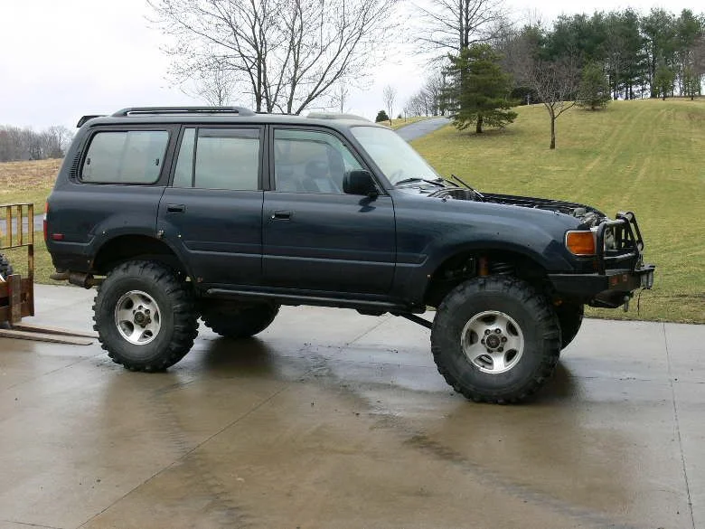

I have been scratching my head and can't figure this out :hillbilly:. How are you gonna put on the front drive shaft? Looking at the picture above, looks like the exhaust pipes are on the way. Shed some light man! Looking pretty good man:clap:! I wish I could see that thing in person.
See page 5 pic with truck and deere test...... It is close. I have a wee little dig on one pipe from a test run in wellsville. I had the truck airborn. The one pipe needs moved up about 1/4" but it is so rare I will just bumpstop that corner to avoid the dinging.

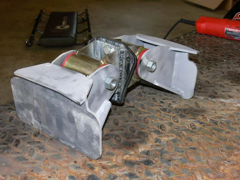

hey kirk, any chance you have these brackets up for sale, im about to order the adapter kit and wondering if i should bother with the ones from marks.
You are the first person asking. I wonder if the motor placement would be the same since you are mating a different tranny via a different adapter. I would be willing to sell you all the flat parts if you want to weld them up. The bushings I used are from a jeep application pro thane brand. Summit racing part PTP-1-502
