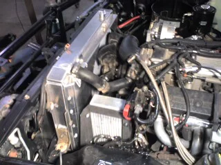

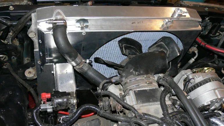

I have more pics to post of the Ron Davis radiator and the install of the PCS tranny control. Will try to get them up tomorrow.

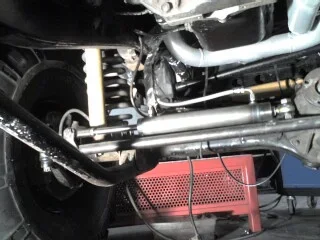

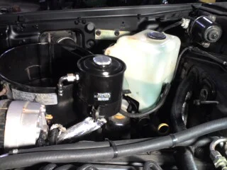

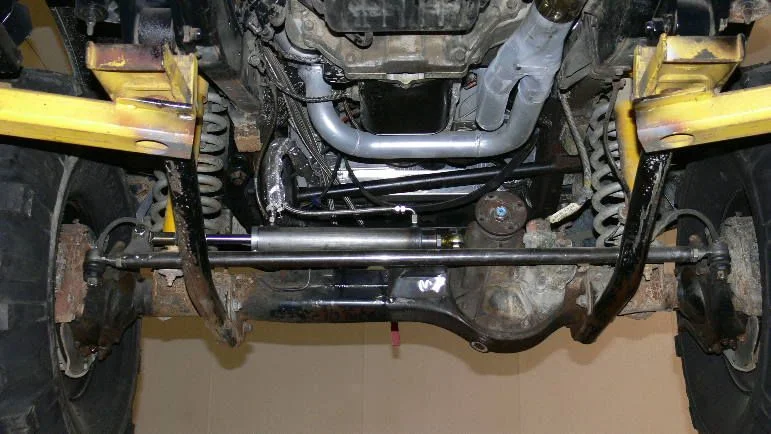

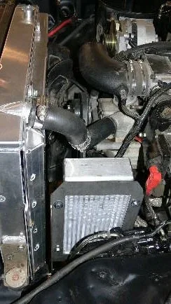

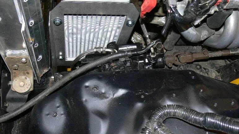

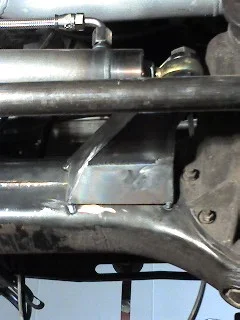

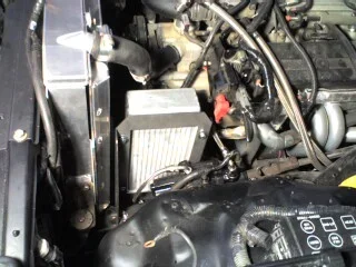

Here are some pics of the ron davis radiator, mega tranny cooler, egr can turned into a mega p/s reservoir and ram assist steering.
