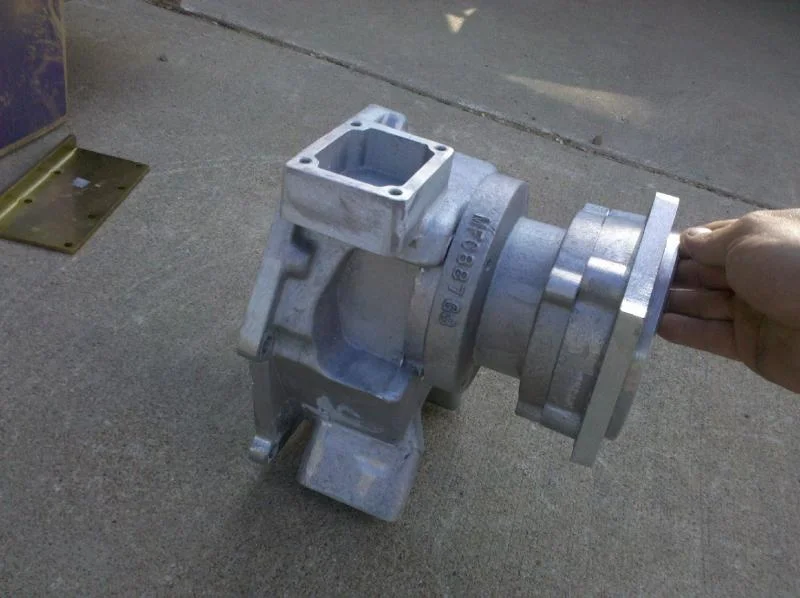

I should be pretty close to not having to mod the driveshafts. I am keeping the HF2A. Wont know for sure till the adapter arrives from the kangaroo express in about 3 more weeks. the delivery time sux from Marks adapters.

Here is the adapter. Fresh from Australia.

Does the shaft that comes with the kit slip over the output shaft of the tranny or does it replace the output shaft of the tranny?
So does this adapter work with all chevy auto transmissions?
No. The one he is using is specific for the 4l70. Advanced Adapters has kits for all trannies. I bought adapters from them for my FJ40 project hooking up my 700R4 to my NP203 and then to my 3sp case.

KIRK; did you order from AA, or straight from AUS?

Had to go through AA. I paid extra to have it drop shipped from Aus. AA did better this time. I have had probs in the past with them but I am changing my take on them.
