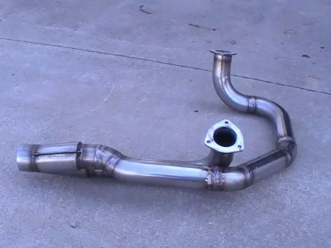

Working on the exhaust right now. The y pipe is about complete. I have to run to work and cut some SS header flanges b/c the did not have them at summit in ss. Will post lots of pics tonight on the exhaust
Kirk

HEY REGARDING welding those header flanges; if you want minimal warpage, get a piece of square aluminum hollow stock .500" wall or so, and bolt the flange to that while welding. It dissipates the heat and minimizes warping. A little extra work, but worth it in the end. If you got a mill/drill press it shouldn't be a problem..

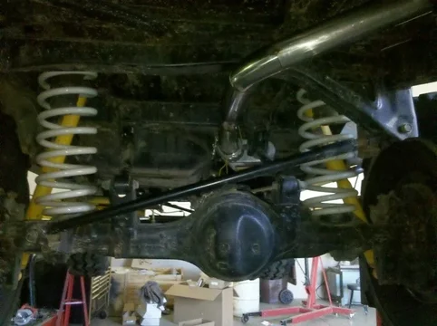

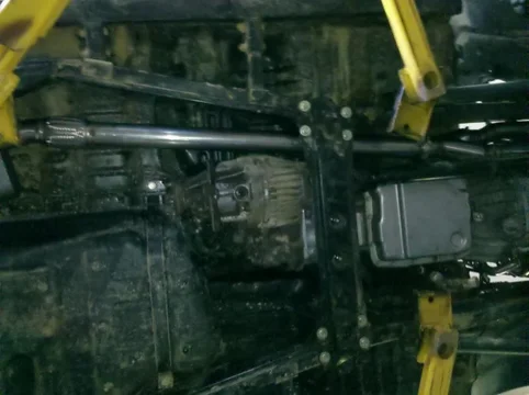

Well I had to take out the rear heater hose lineset and reroute. It was in my way of progress to run the single pipe back to the muffler. So I intend to keep moving on the exhaust then I can redo the rear heater hoses later in the game. More pics tomorrow
Kirk

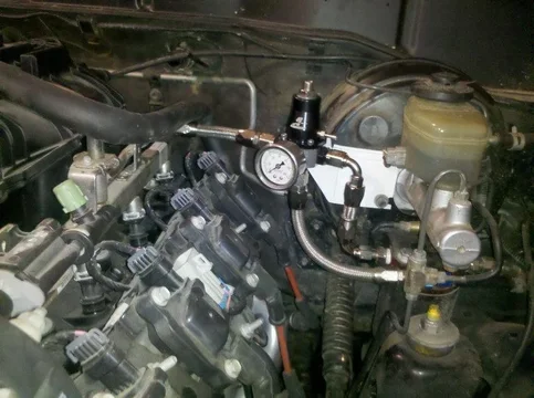

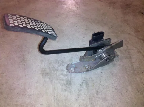

Made a little progress this week.
Drive by wire pedal, mounted oxy sensors, mounted fuel regulator.

did you ever do anything with your rear heater hoses? Are the ones you removed the ones by the transfer case right around the frame rails?
Turns out I poked a small hole in mine during the install; the one in the trans tunnel. OOps.
I'm thinking about deleting the rear heat entirely.
