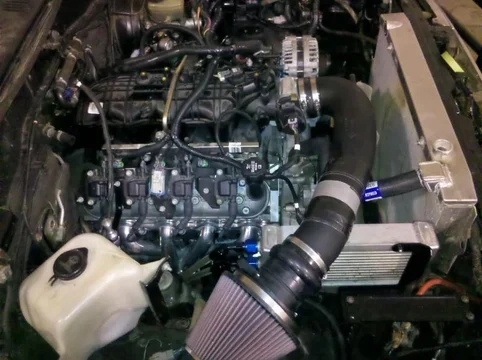

Air intake tube path. Building aluminum airbox.

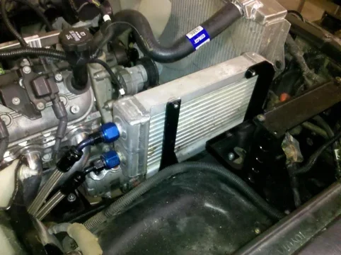

Tranny cooler mounted and ready.

The update is I have a little headway on the airbox and it has been a f*ker to get a ductwork/filter/airbox design that I like. I have made 3 airboxes in the last couple weeks. Busy at work and havent been putting in the garage time as well.

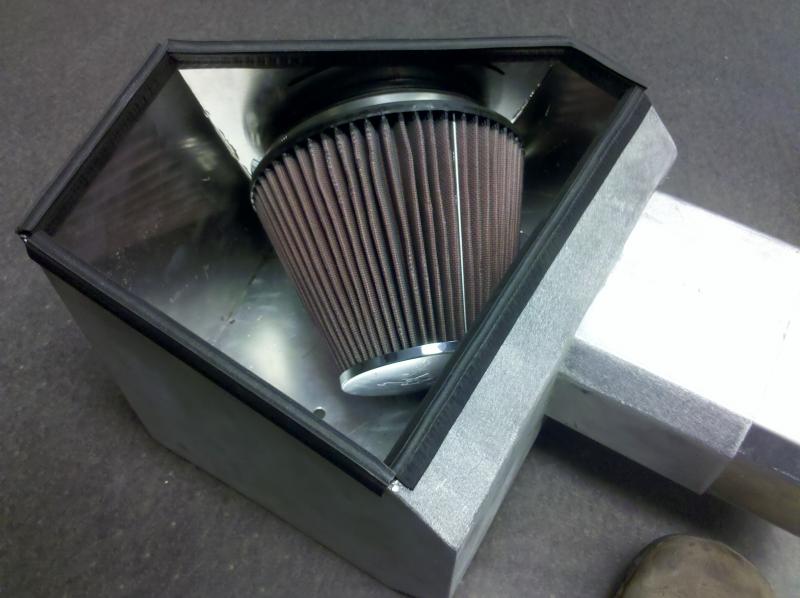

Here is what has been slowing me down. This is almost finished. Put the latches on it tonight and a couple more welds. Also the PHH bs never ends. I have the rear heater plumbed up and it was a PITA.
Getting closer. I have another issue with the dipstick tube that is giving me fits and will require draining the oil and taking off the pan. Grrrrr
Here is a pic of the inside. The rectangular tube is the start of the snorkel project.
How does the filter seal to the box? It looks like you've got an outer portion screws to the box and then attaches to the filter inside the box? I need to make the same thing and I'd like a better seal then just cutting a hole and sticking the tube end of the filter through it...
there is a hole in the alum slightly larger than the maf. On top of that is a aluminum adapter from K&N to go from the GM maf to the k&n cone. A rubber gasket goes in between to be water tight. i dont know if you can buy it individually. I bought the alum adapter at summit racing in the closeout rack as a 2006 GTO cold air induction kit.

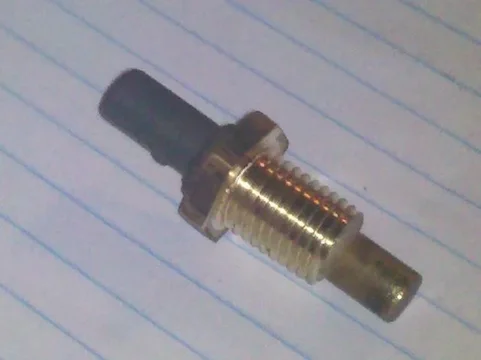

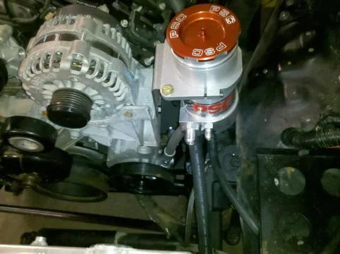

Pics of PS reservoir and finished airbox. I still have some work to do in the intake tube. Getting my fan spacer back fron the zinc plater tomorrow. Getting down to really fine details. I am also working on the toy water temp sensor. I turned it down and am putting a 1/4"npt on it so it threads right into the LS heads.
Factory toyota water temp sending unit re machined to fit right into LS2 cylinder head. Thread is M12 x 1.5
