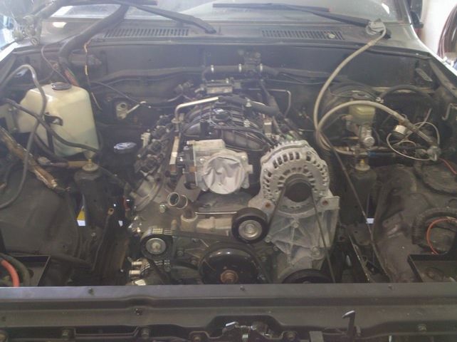

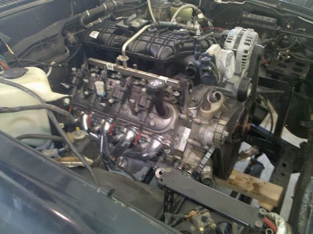

Well I had some time last night to finish weld the motor mounts and paint. I also changed out to the camaro oil pan while the motor was out. I should be able to roll right along now. Exhaust is next.

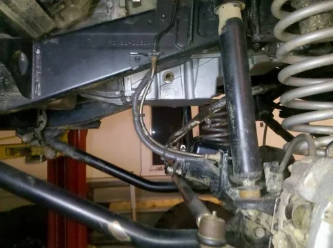

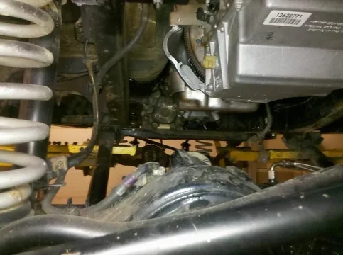

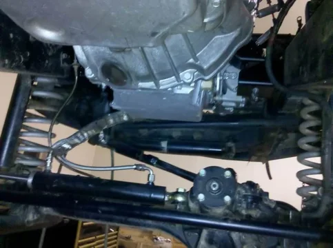

I'm wondering about front drive shaft clearance to the transmission pan...
Mine is only going to be 2.5"... I may have a problem...
6" lift with 39.5" swampers. I will shoot pics and post of my slee dc driveshaft mocked up and post.
I will notch my pan in the back a little just for my sanity. It is clear now, but in ohio we often get weeds, branches and mystery things wound up in the driveshafts. I went thru a mudhole once and came out the other end with a mattress wound up in my old 40 series.
Well, yeah, a 6" lift will probably clear it! :clap:
I am really interested to see the front pumpkin to oil pan clearance and tie rod clearance on the low lift vehicles. Just another thought popped in my head. When I was leveling my engine I set mine dead flat. Maybe you guys could tilt the engine upwards 1 inch maybe two. going towards the front of the truck to gain oil pan clearance. It would help a ton.
