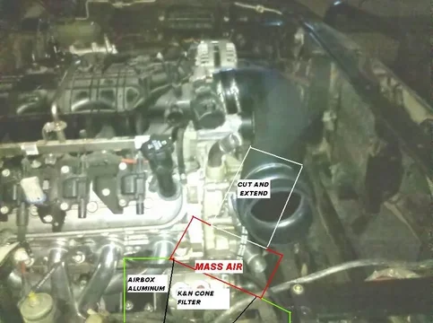

06 GTO K&N intake and airbox plan- Scored an open box kit at summit for $100!

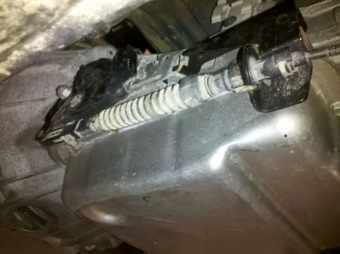

GM shifter cable idea using stock toyo shifter.

Here is the plan on the airbox/maf/piping.

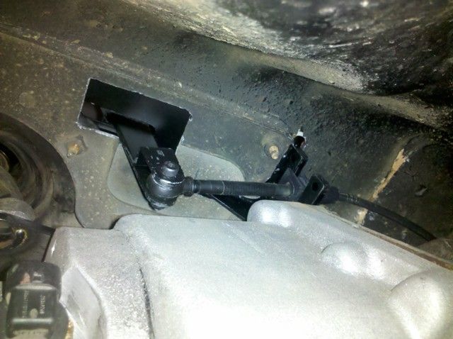

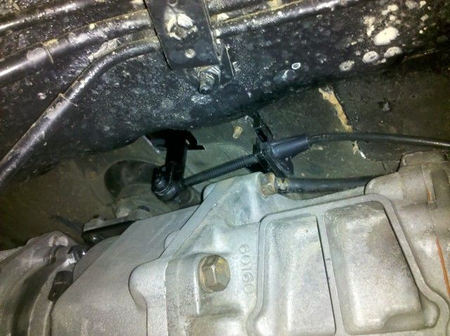

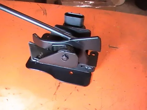

1991 80 series shifter modified to accept Chevy Trailblazer shift cable

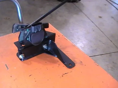

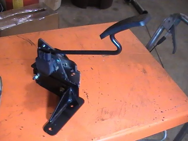

Electric throttle pedal assy, Bolts to steering column mounts

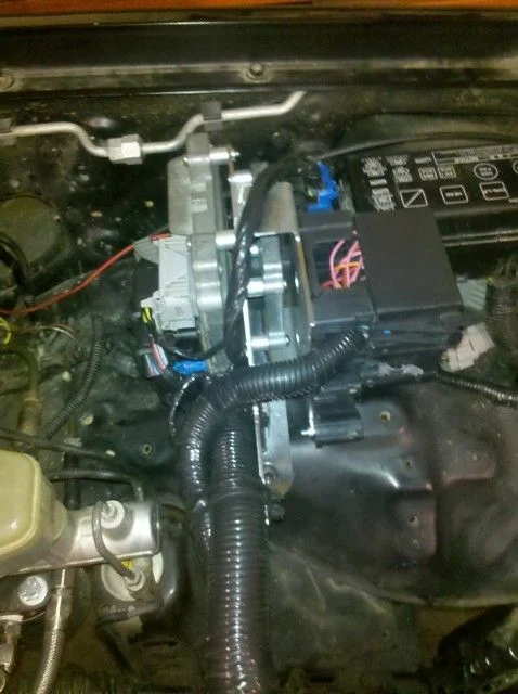

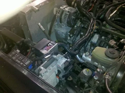

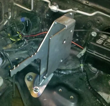

I test fit the harness I had altered from the factory trailblazer SS. It worked out nice and fits pretty good. The ECU,TCU and Relays are going to be mounted in between the master cylinder and the underhood electrical panel.
The transfer case shifter relocator bracket from Marks is not correct. I have to redesign and make new to get it to fit in the original position.

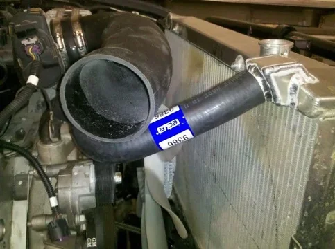

For radiator hoses I ordered a set of Trailblazer SS hoses. My thoughts are they should go in the approx direction of the Toyo in and outs's. If they are off course I can move the inlet and or outlet easily on the aluminum radiator.

This bracket holds the GM ECU TCU and Relays needed to run the LS2. Mounts where the ABS used to be. I will powder coat this and permanently install the wiring harness. I am making one more bracket that attaches to the engine coils bolts and secures the main body of the harness to the engine.
