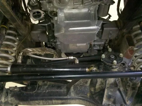

After some research tonight I believe the next try on the oil pan is a 05-08 ls2 corvette oil pan. It has the oil filter on the driver side away from the driveshaft and the overall depth is as shallow as it gets.

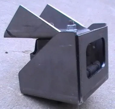

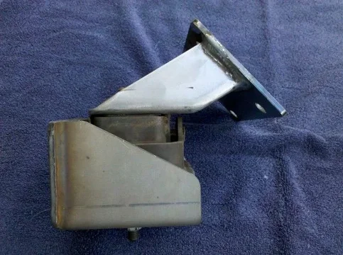

Here is my mockup for the engine mounts. They were close. Couple of tweaks to them and I should be able to have them in this week. The rubber is from the trailblazer ss and I kept the concept of how they fit up similar to how gm had them mounted to the ls2.
Looking good!
Those mounts are very similar to the Advance Adapter universal mounts. however I like your "boxed" approach a lot more.
I also like the use of OEM stuff. With my current swap (not an '80) I am utilizing as much of the OEM parts as possible to make a road side repair easier. That is something that few people who do these swaps think about.
Looking good!
I always trust a OEM designed part over an aftermarket universal. The A/A mounts I have never liked that bushing they have used for years. It must work b/c they have sure sold lots of them to the jeep world.
agreed the mount is not what I want for this application... Leave that type of isolation to body mounts...
In the marine world that type of mount is used often for power plants.
Engine mounts are in. Finally tweaked in all the pieces. I will finish weld once I pull the motor.
I will have these for sale soon. I am going to make about 10 sets and put on the self. Price will be $150 per set powdercoated without bushings.
