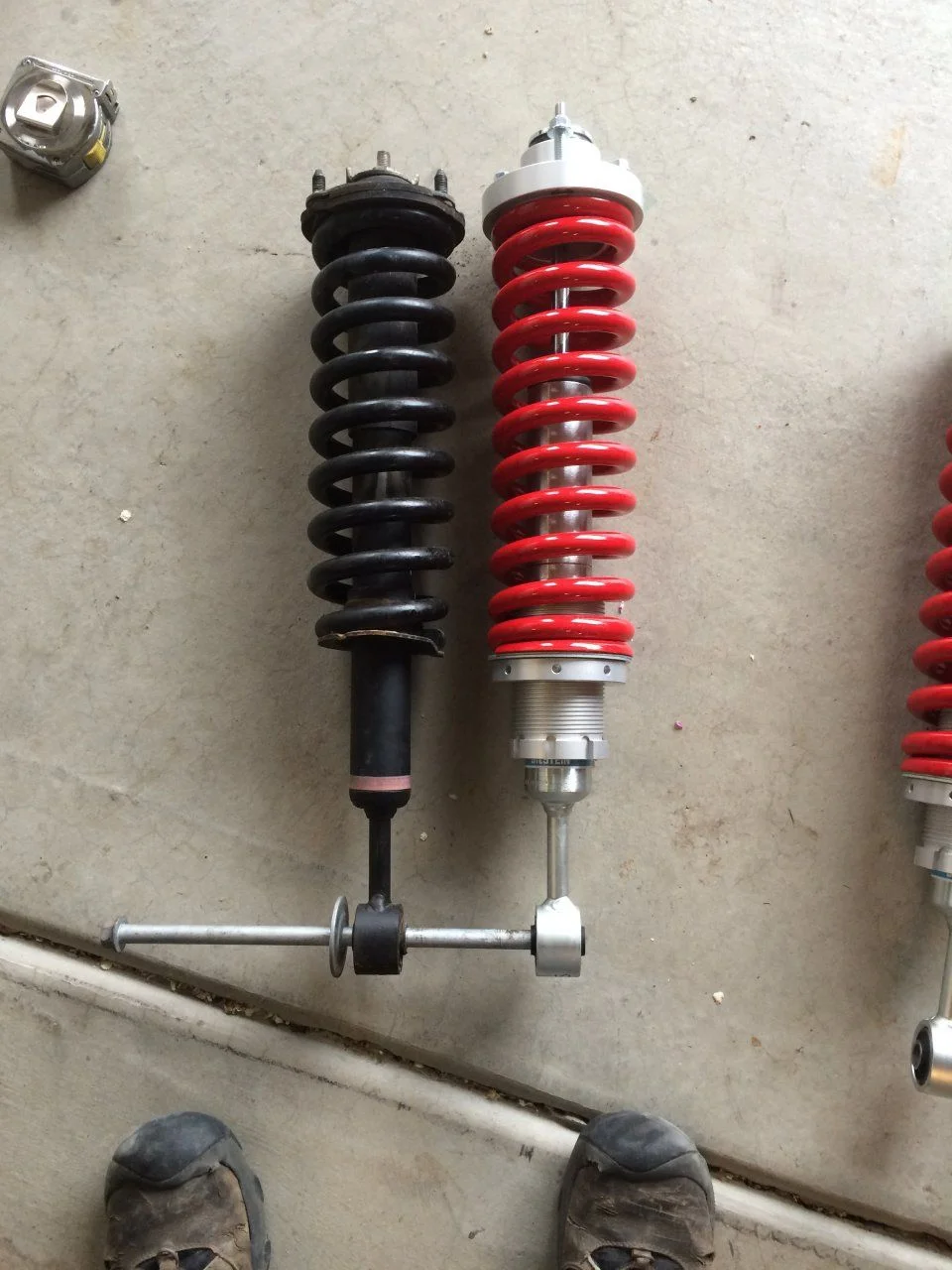

  • ToyTec 3" Ultimate Lift with Bilstein 5100 front shock and Boss rear shocks
  • ToyTec Superflex rear coils

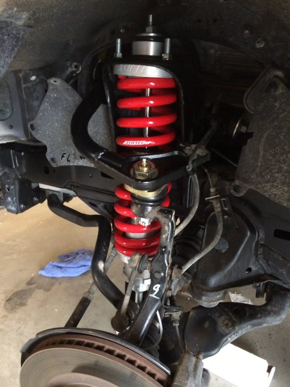

  • SPC upper control arms

A friend and I installed the everything except the roof rack in about 6 hours. Here are some pics.

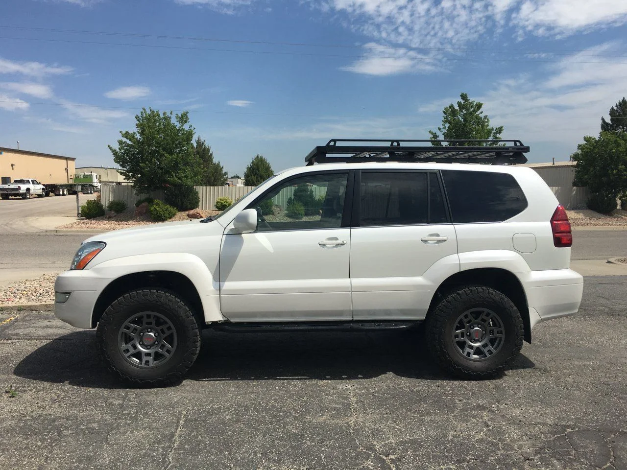

Here's the final results.
Here are some measurements from the fender wells.
Before:
  • Front driver - 34 1/8"
  • Rear driver - 35 3/8"
  • Front passenger - 34 1/8"
  • Rear passenger - 35"
After:
  • Front driver - 38 " (was higher but I adjusted down 1/2")
  • Rear driver - 38 1/2"
  • Front passenger - 38" (was higher but I adjusted down 1/2")
  • Rear passenger - 38 3/8"
I absolutely love the way the truck rides. It is a little firmer than the original sport setting, but in no way harsh. It is so much smoother over bumps and overall is a big improvement compared to the stock 160,000 mile stock suspension. It actually rides close to the wife's stock GX460 yet still retains that "Lexus feel".

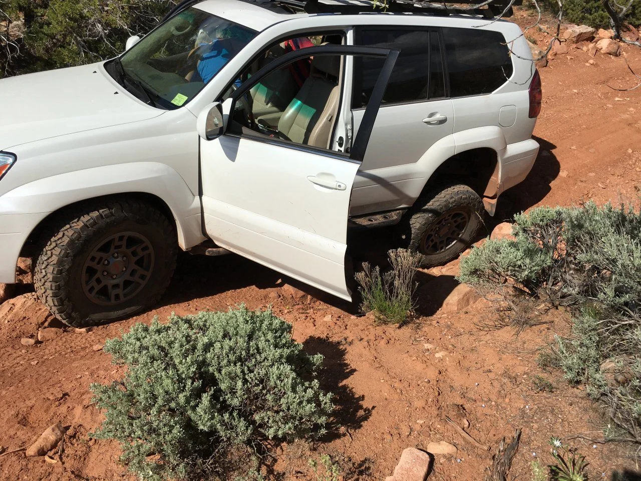

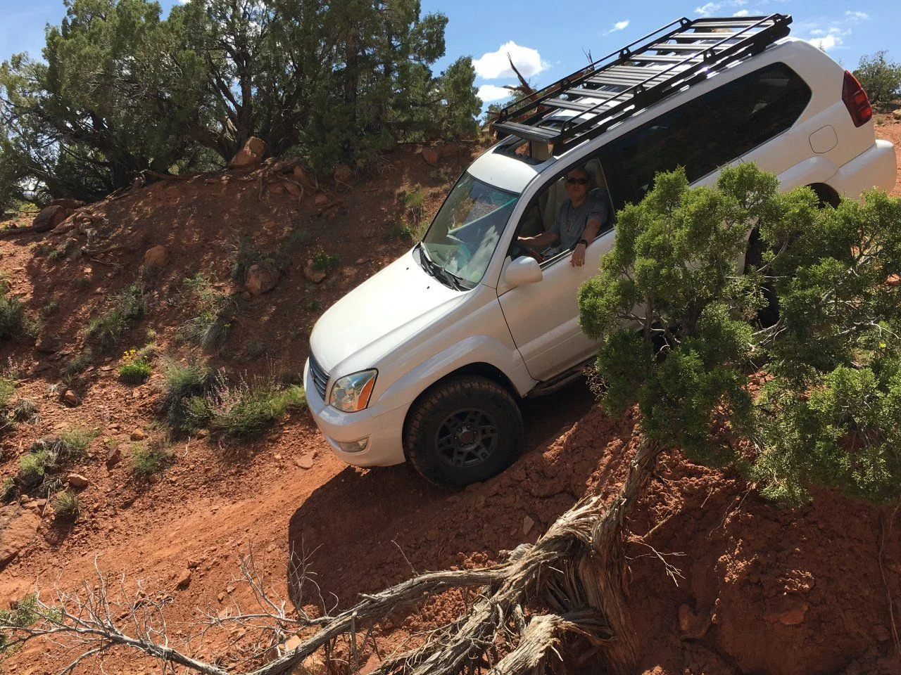

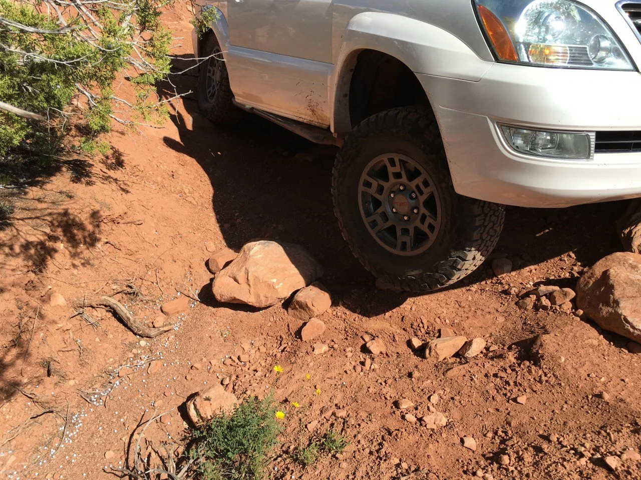

Took the GX and the family to Moab over Memorial Day weekend and it performed great. I'm going back over the July 4th weekend to have some more fun. The family no longer complains about going off-roading with me! I'm very pleased with how the truck turned out.
