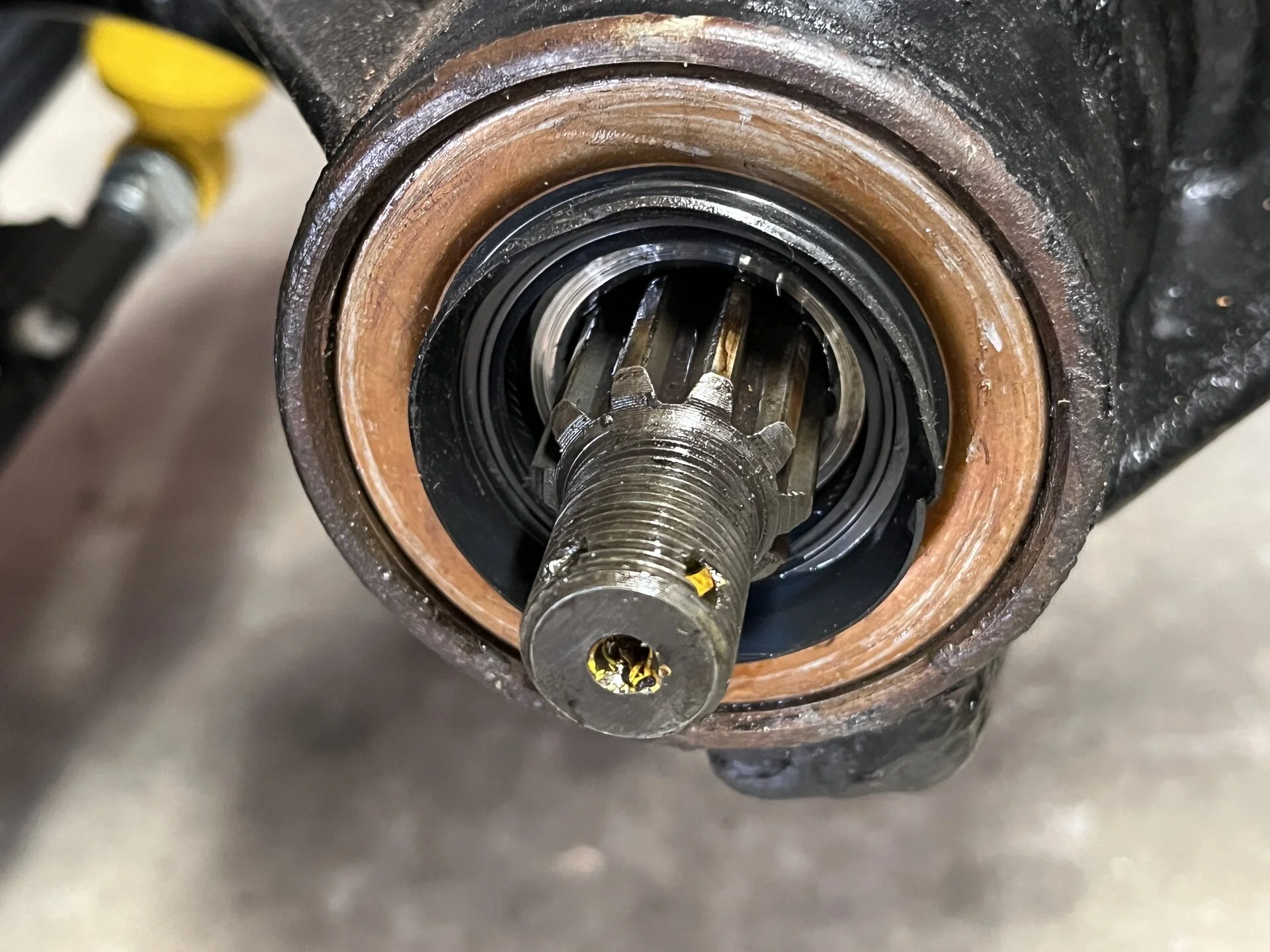

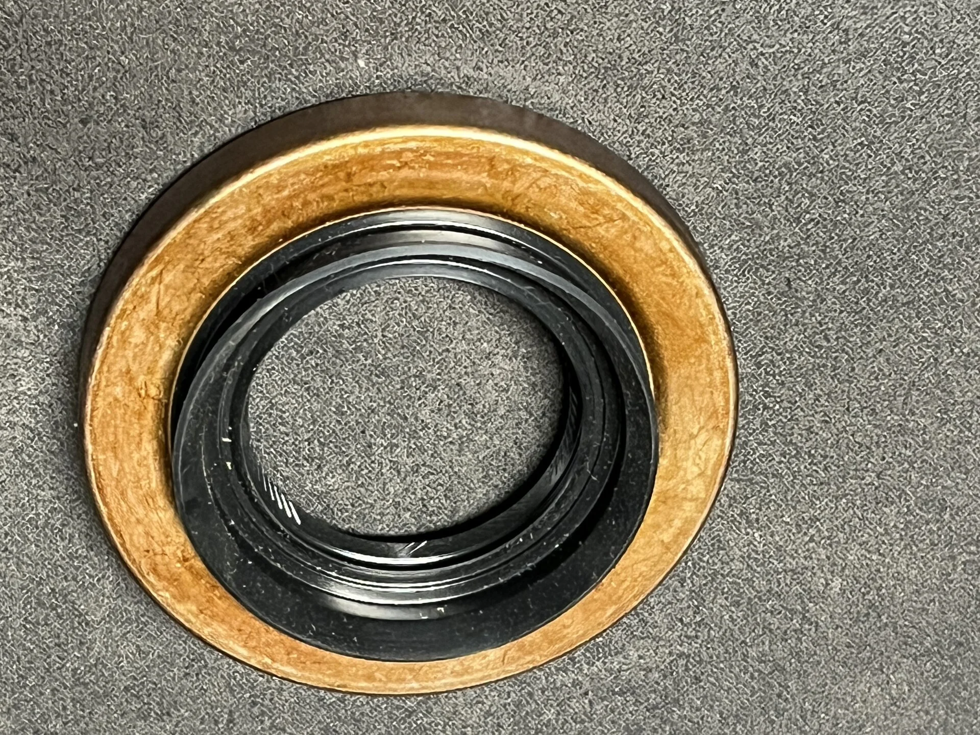

Replacing rear diff seal. Part number shows 90311-38028 in my parts book. I have one of those seals but it looks different from what is on mine. First picture is before I remove. 2nd picture is of the part I have. Can anyone tell me if this is correct part? I thought it was leaking but looking inside it looks dry. Just thought it would be a good idea to change. Might have been changed before and maybe correct one is was not used. Thanks..
@JackA thought seal has been updated to what I have. Just seeing if that is everyone else’s experience.

How's the surface on the flange look where the seal rides? Did you test fit the seal to the flange before installing?

Staked nut would be good as I had to also use a different seal than came out of it.
Seal that came out was an NOK TB387411X3

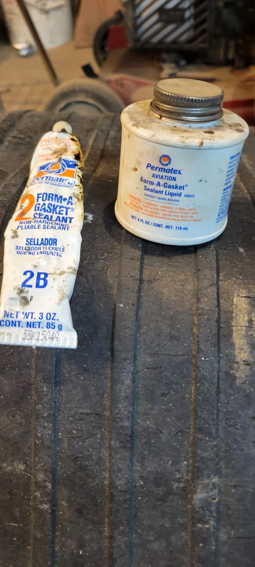

I use permatex #2B non hardening sealant in this application. I believe Toyota offers a similar product. Or you could use Aviation sealer, but its a pita for future cleanup. There is slight movement between the pinion splines and the pinion flange. Regular rtv dries hard so at some point the hard sealing rtv breaks apart from the splines because of this slight movement and allows gear lube to pass thru. Non hardening doesnt do that. The nut and washer needs non hardening sealant too.

Not sure what you mean lower part of the splines. If oil is coming past the splines it will be leaking at the pinion nut. If it coming out behind the dust shield it's leaking between oil seal and surface on the flange. You say it has low miles but if sat for a long time still possible has surface rust even in AZ. I have transmissions stored in a garage. I keep oil in the and spin the input shaft with the transmission in gear just to keep oil on the gears. Still haven't seen a picture of the surface on the flange. The nut being loose when you removed the cotter pin meant something wasn't right. Preload doesn't go away from lack of use.
