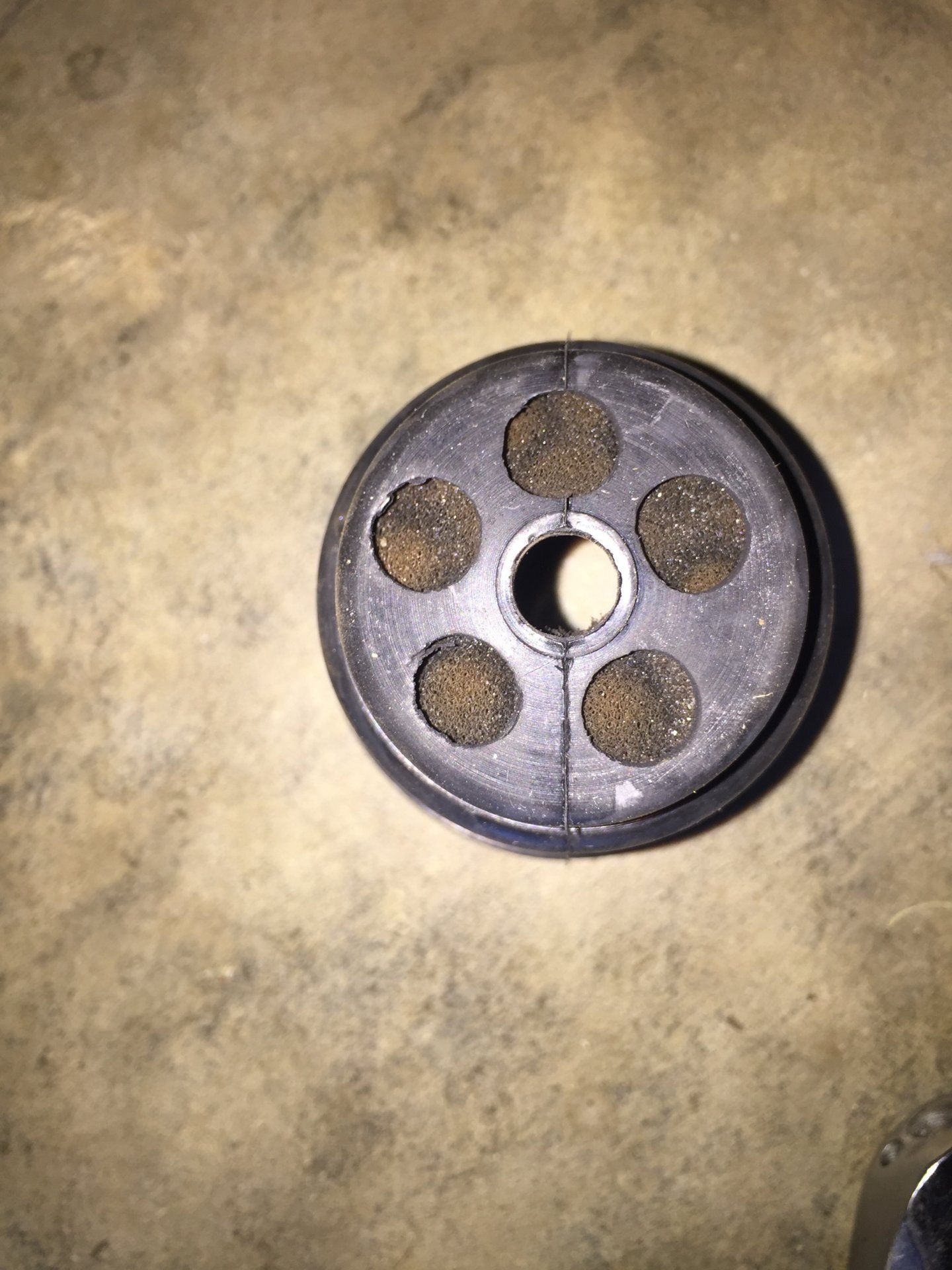

Yep - not exactly clear as to why it's there - dust sheilding to keep stuff from getting in the booster? I guess to be clear I was thinking a whole replacement boot assembly could be valuable. There have been several posts over the years about replacing that.
The issue here is that my booster is a replacement part as opposed to a reproduction part. It's unlikely the assembly is interchangeable.

I just wanted to follow up as I ordered the 67-72 brake booster boot mentioned above to give it a shot. Not an exact match, but I think it will work!
Here is the new Chevy boot (right) verse old ripped Toyota boot (left)
The little "filter element" from the Toyota boot fits perfectly in the Chevy boot:
The boot fitment on the booster is a bit loose at the base, but not so much that it pulls off or migrates by actuating the pushrod by hand.
I'm going to run it for a while. I'll report back if I run into issues.
