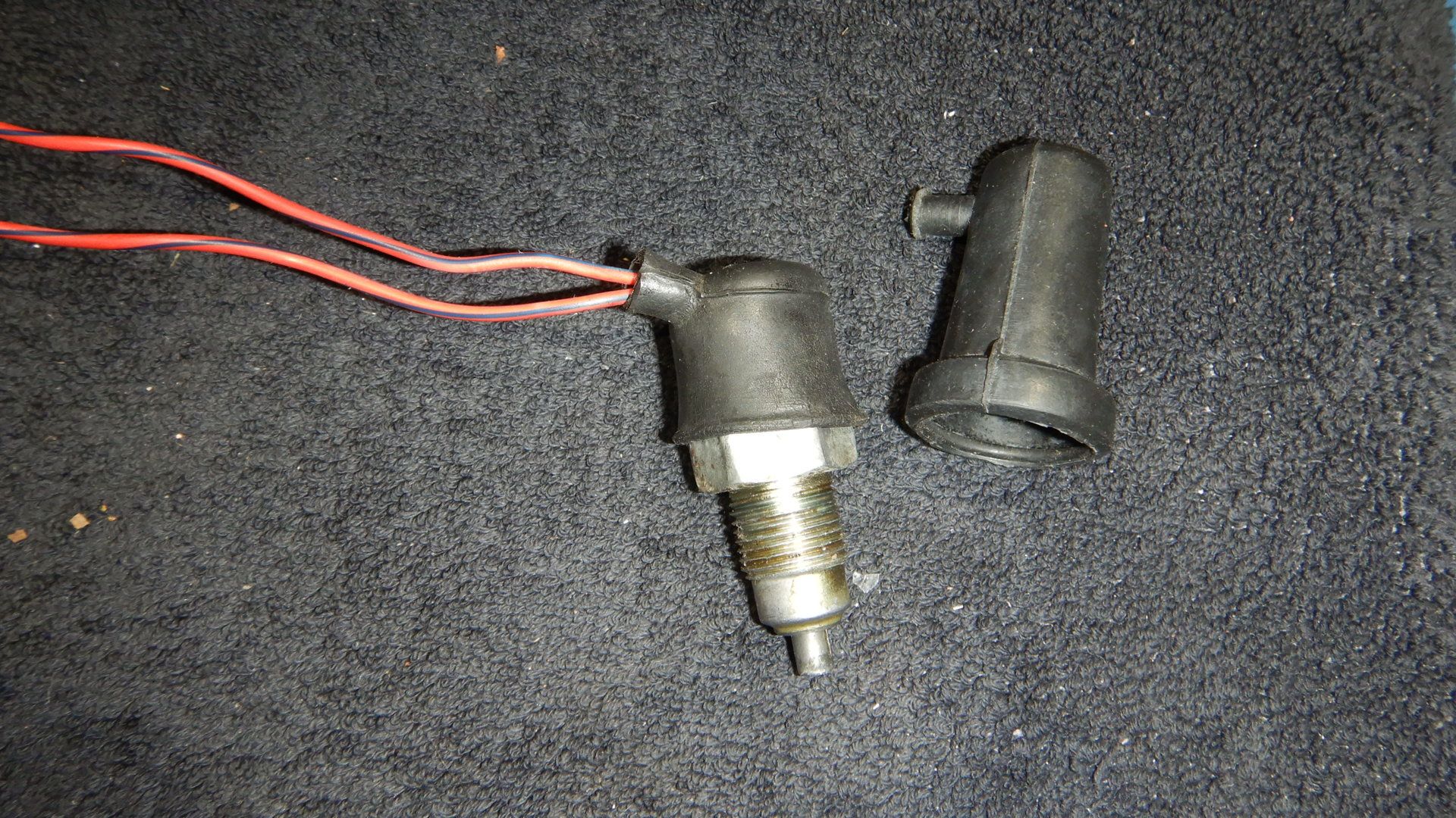

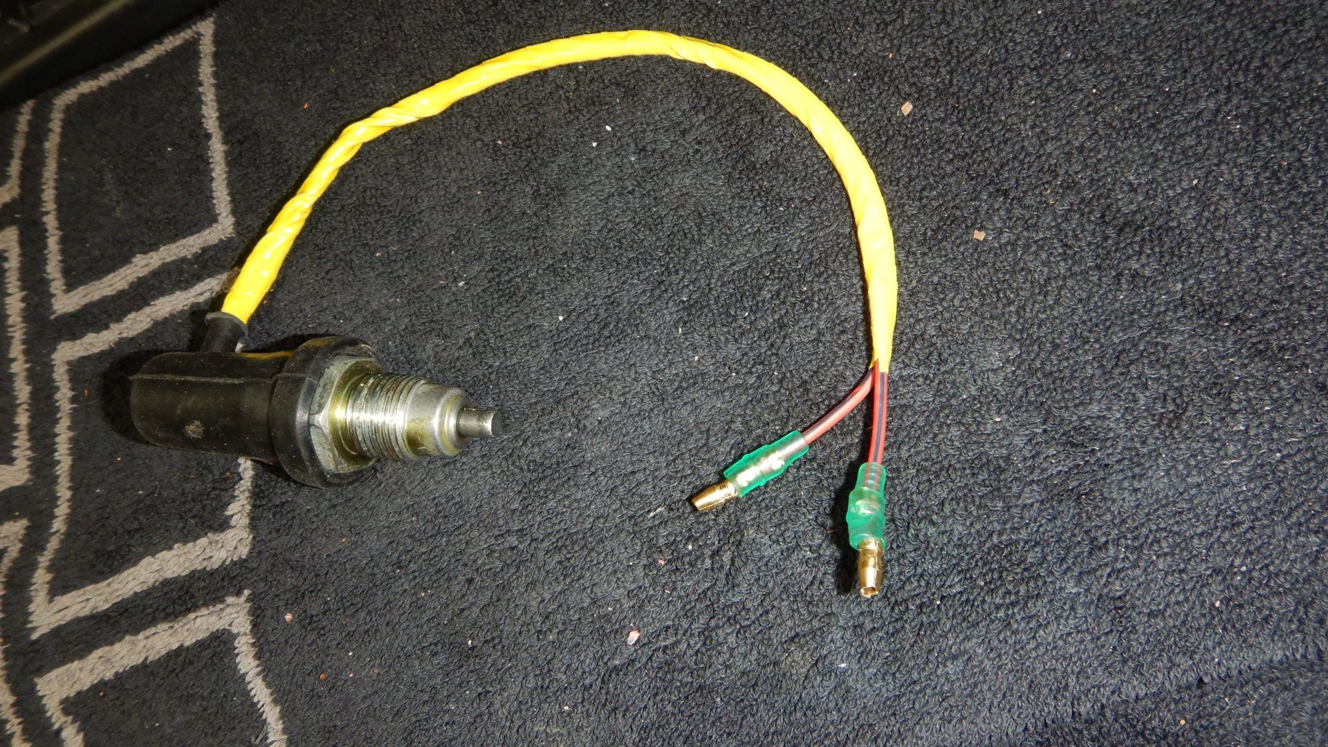

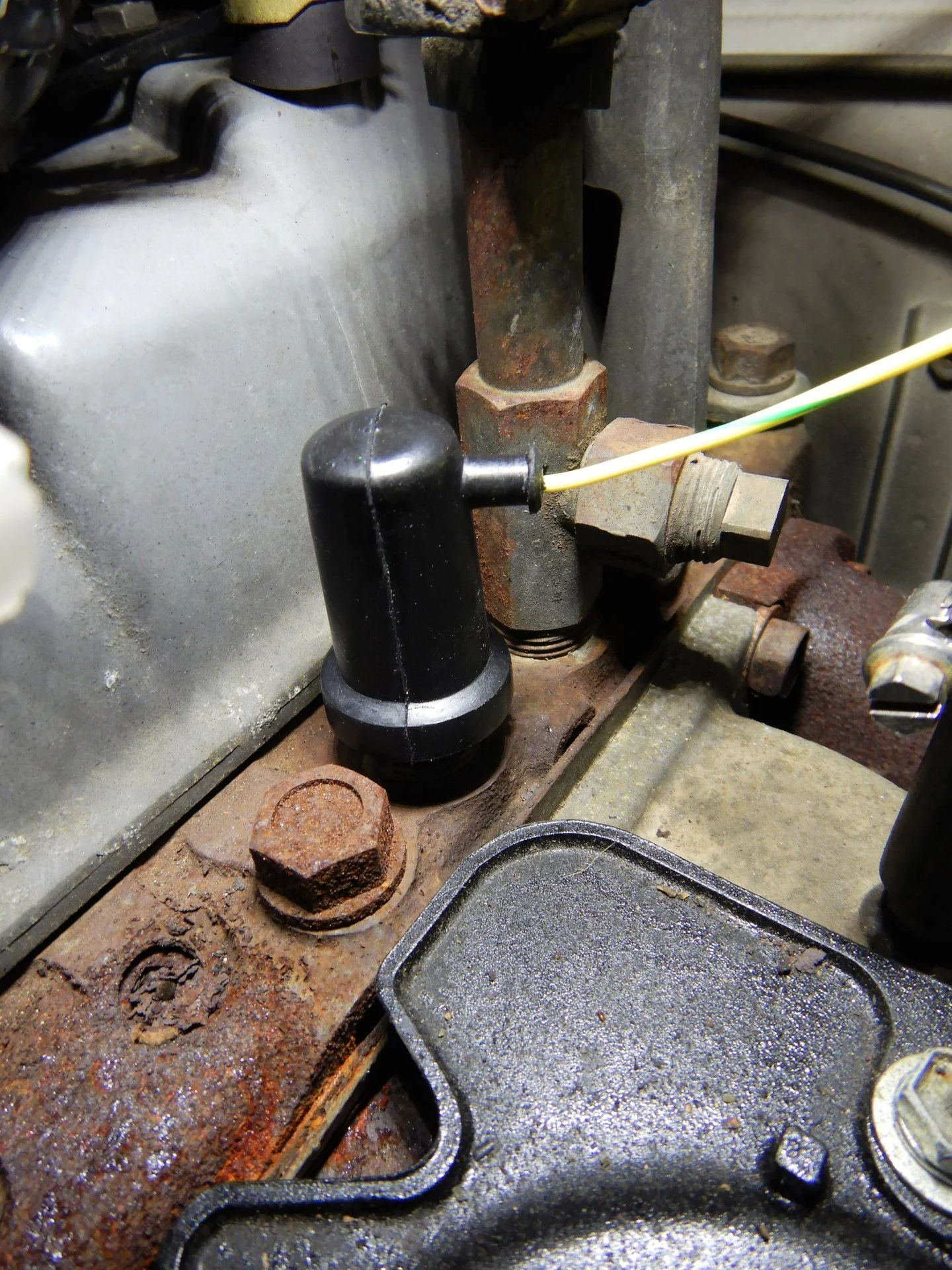

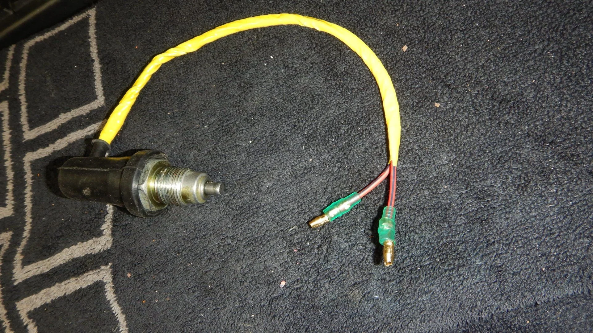

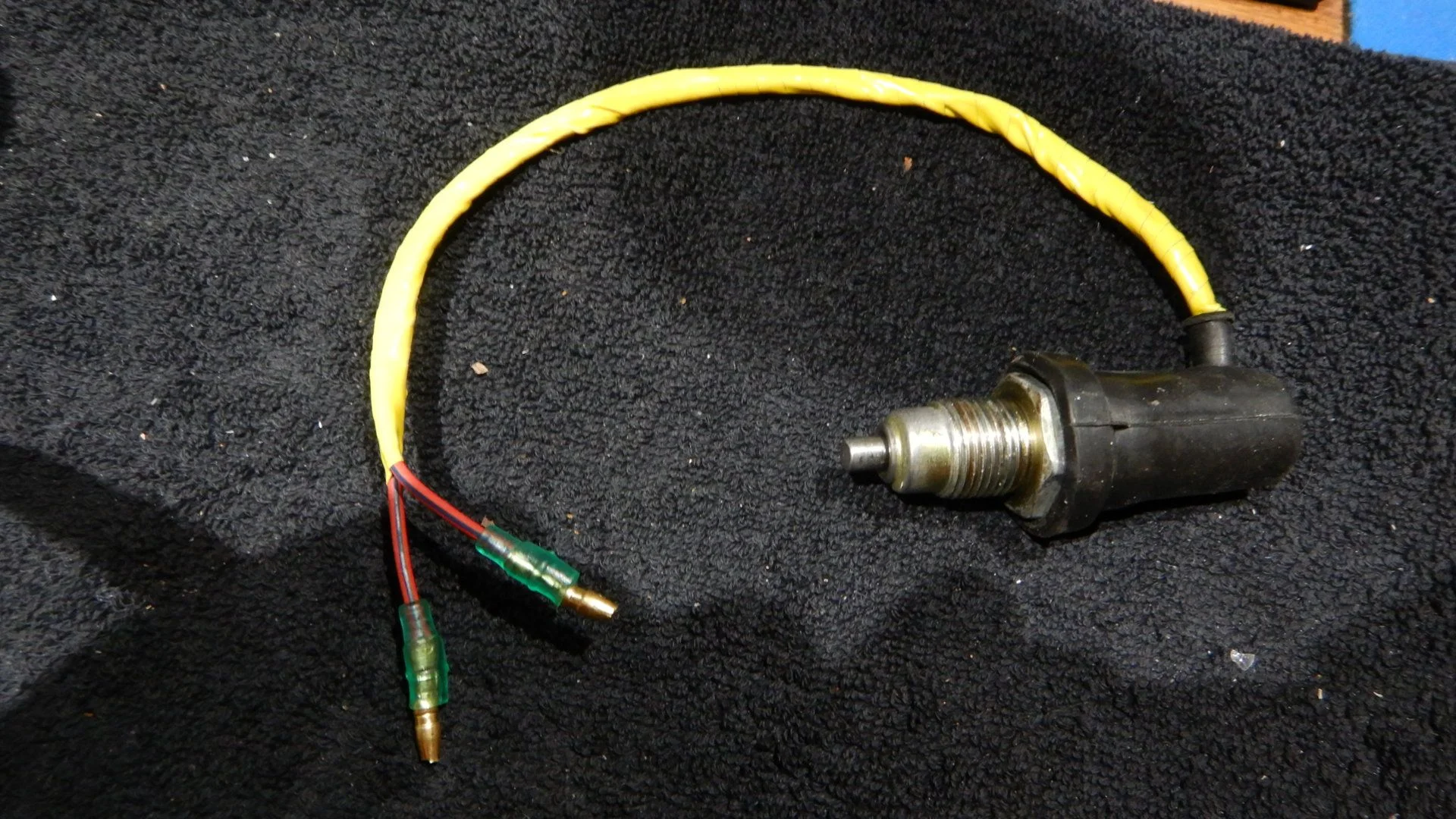

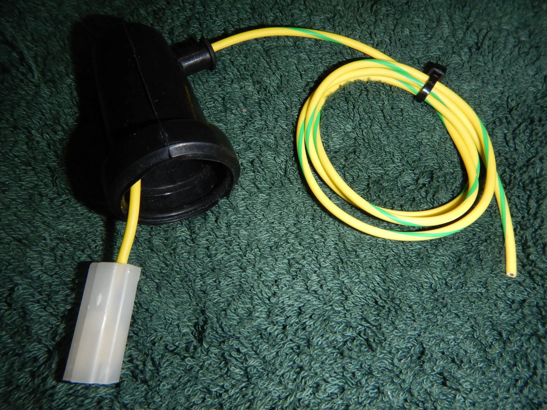

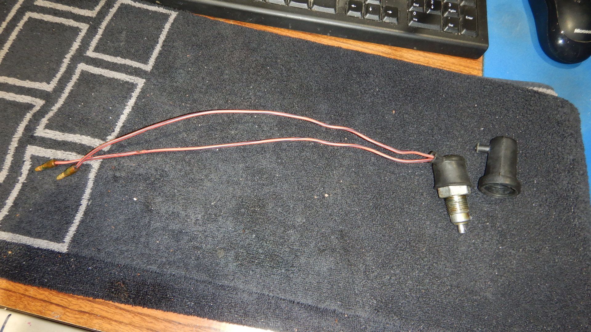

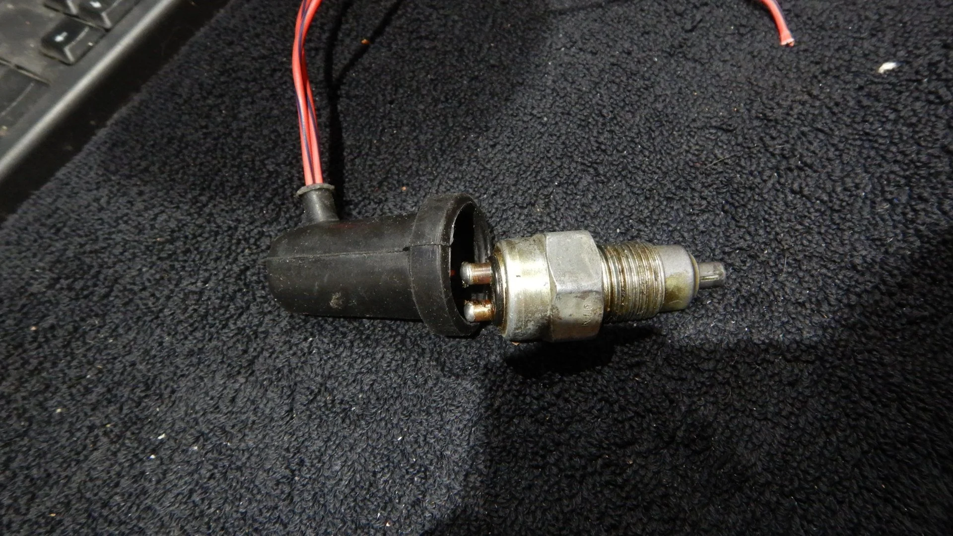

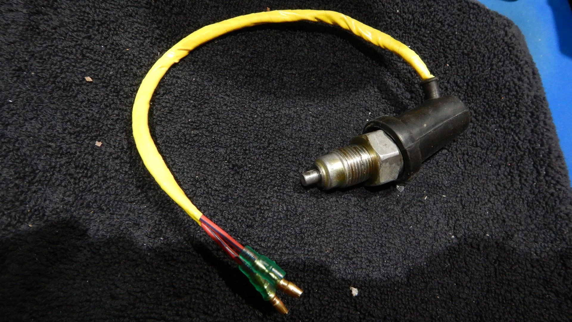

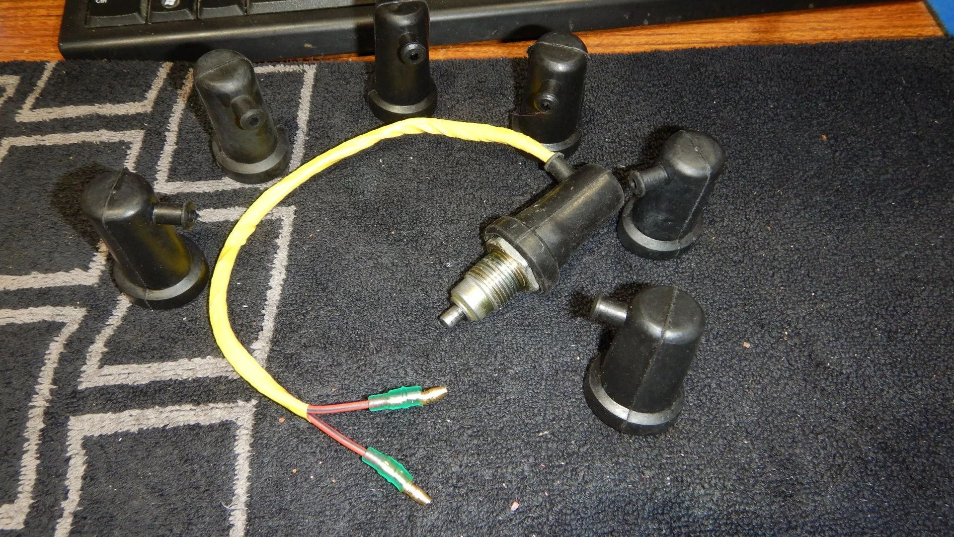

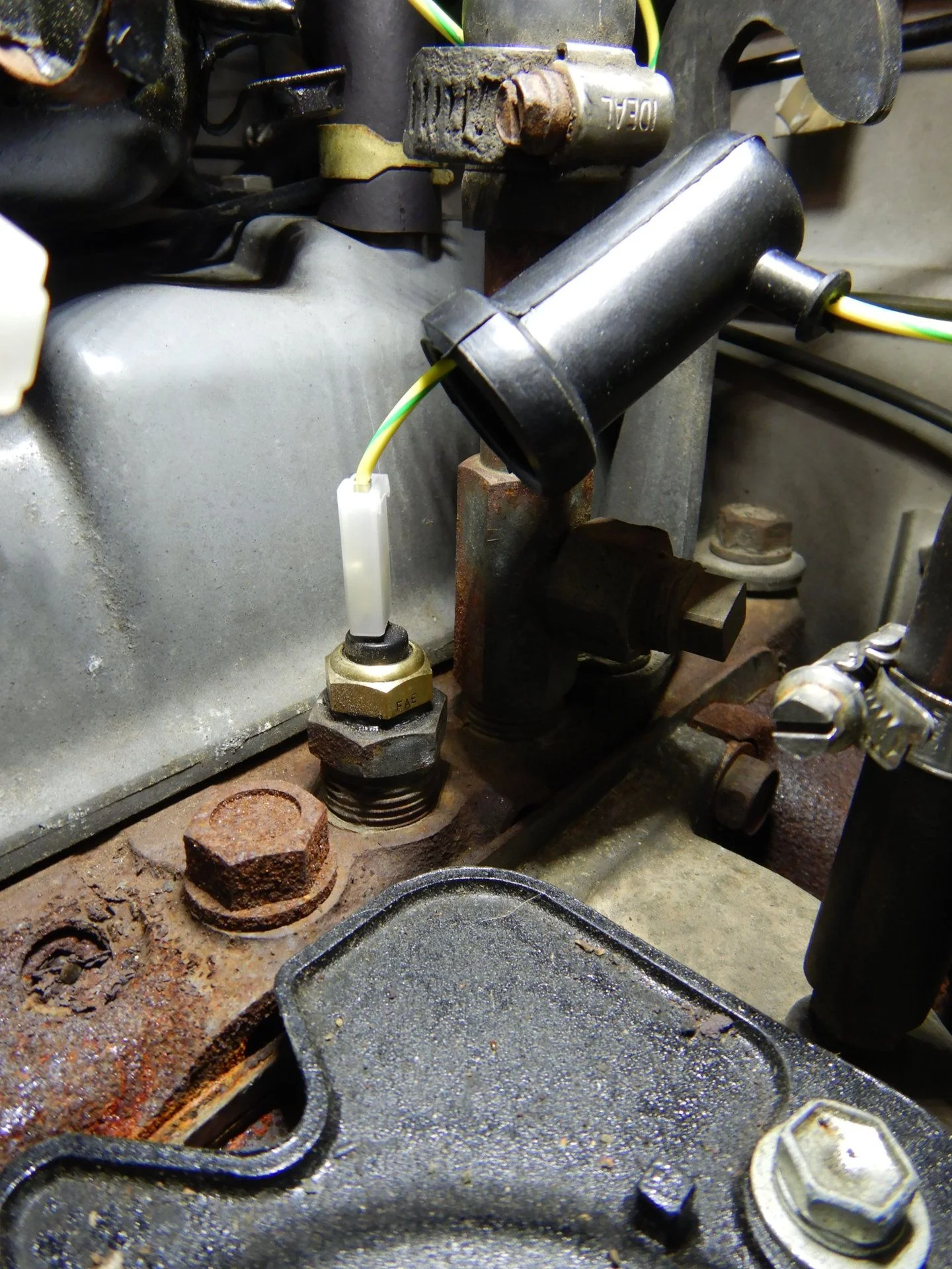

Reproduction Back Up switch rubber boot cover
if u have a 24mm HEX back up switch or other sensor or switch , such as the water temp. guage sender union on a 2F Cylinder Head
its measures 1 7/8" inches tall or 48cm tall
made from solvent resistant EPDM Rubber , the Test subject in photos is a Back Up switch from a 1978 Fj40 H42 Transmission
I re-designed the original slightly by making it slightly taller to the wires would not get crushed and fatigue on the solder joints , hence giving it more room inside for a various applications line the water temp sender gauge on the 2F cylinder head etc.......
Very nice Matt. It is absolutely true that the hard angle on the wires forced by the cramped factory boot contribute to premature wire failure at the solder joints.
Most switches end up being replaced because of wire failure long before the actual switch wears out. This boot should help folks out who would like to repair their old switch but despair when they look at how hard of an angle the wires face with the factory boot.
