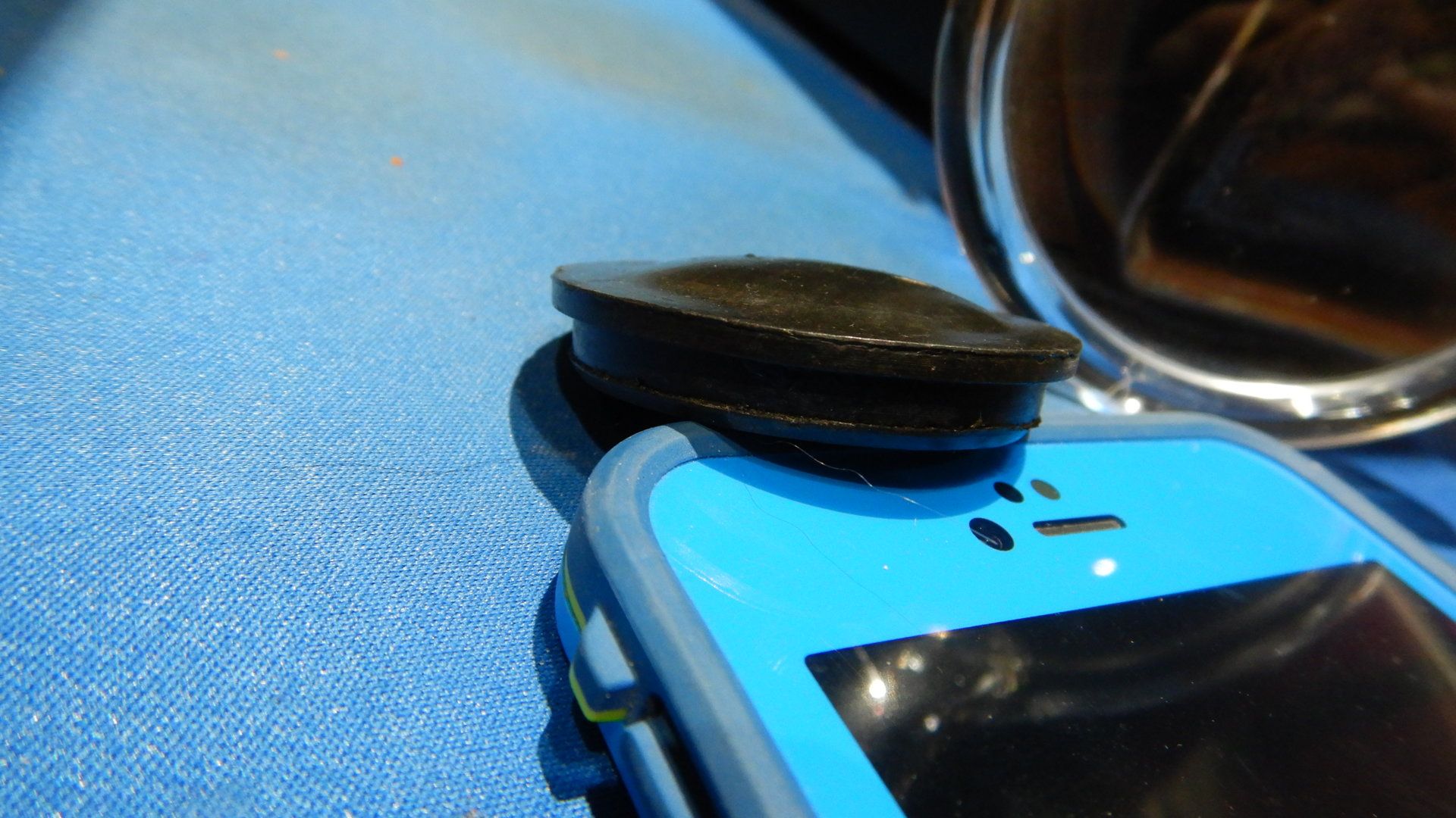

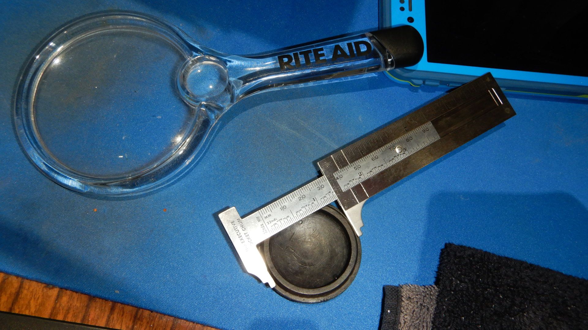

Note : the inner contact surface is rim to sheet metal side surface hole 41mm
- No evidence of a Toyota OEM part # , i Just Sonic Cleaned it real quick
- the lip on the upside is 42mm
- the outer flange or sealing surface lip / overlay part is 46mm
- this plug is for a 40mm hole exactly
- the plug is oddly beveled as maybe shed water like a drip-edge surface when installed upside down as so ..........
- does this look familiar Roger ?
Well Matt, you win the prize! That is what it looks like and it has the right dimensions. If you want to sell it let me know by PM
I like prizes :princess:
Sell it to u ?
Naaaaaaaaa..............
