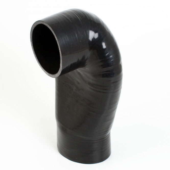

One thing we discovered was that the engine runs a little hotter than we wanted it to. Got up to 240 a couple times. In talking with DJ and Jeremiah from Proffitts, we were told to use standard fan instead of the electric. @cjmoon and @tornadoalleycruiser loaned me a fan to start mocking this up…. Unfortunately, I will have to come up with some other air intake. The hoop is about 1 inch larger than the fan outside diameter. If I recall the fan is about 18.5 inch OD. Anyone seen a tighter right angle turn for the intake?
One I used:
Awesome.... Thanks!
