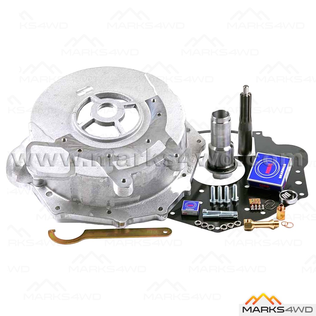

We use the marks adapter kit to an H55f, which puts the V8 forward enough to keep the H55f and drivelines in their stock position. They call it the "extendomatic" adapter, but it does the job very well and is a great solution to your problem.
How much difference in depth? Been looking all over online and can't find anything... picture in instructions looks like an inch or two?

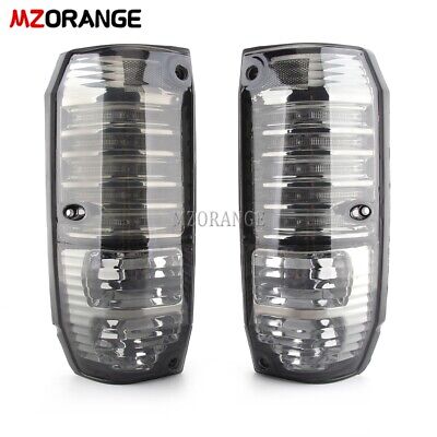

So, remember those tail lights that did not fit.... this is the first time they have had issues with the fitment, but clearly, they were not made for 73 series.
Well, they gave me the option to return them... TO CHINA..
So they are for sale. $100 shipped to you. I paid $126. I think they look amazing and wish they would work for me, but it appears the only option I have is to go with OEM lights. Any takers?
Follow the link and it says should fit 70,75 and 78 series.
Pretty sure these are for the 76/77 hd versions or the LJ/KZJ 77/78 aka the 4 door models
