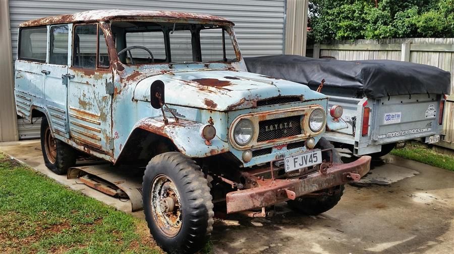

So the FJ45V Land Cruiser Wagon is finally getting sand blasted next week. I also fitted some temp tyres/rim close to what I will end up running. They are 285/70R17s on 17x8 0 Offset rims.
I thought I'd share some photos of it in it's current state before I started removing everything. The front panels will be left as is and turned into wall art for the shed as something to remember the cool patina by.
The worse of the work is the roof/gutters and A pillars. I think the rest of the rust repairs is your usual bottom of doors, sills, and rear sill rust repairs. Then fold up a new skin for the tailgate. Hopefully my budget can keep up with the repairs. BMV Engineering will be doing all the work. Here is a link to their facebook page BMV Engineering

Overall it's came back better than I expected, but still a massive job ahead to fix the rust properly. We took it past BMV Engineering yesterday and while he has happy to fix it, he reckons building a whole new matching body from scratch will be easier and similar $. I was never planning on a full stock resto, so I'm kinda liking this idea.
Question is then do people see it as a brand new FJ45V, or just a replica??
It'll still be on the stock chassis with stock vin number but have coil over suspension, 2uz-fe v8 & 5spd auto.
What do you guys reckon?

Hey Twisty, If you are sticking with the 'rest-mod' idea go with the new body and a new chassis. Stick the 45V and it's original chassis in the corner of the shed and do an original restoration at some point when you are old and grey. If you didn't want to spend the coin on a new 45V body and chassis. You could look at doing a FJ55 - still a cool truck and you can still cart the family around. Cheers, Ben
