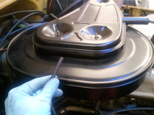

Air cleaner fittings
Mr Shane (AATLASX) has provided me with a "new" air cleaner assembly.
I finally set about installing it today.
It fits (Shane, you were right!).
However, it is missing two nipples that my old one had.
One here:

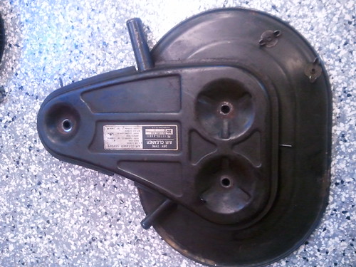

The old one:
Untitled by t i g, on Flickr

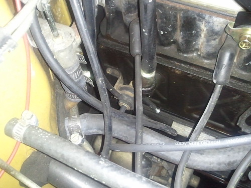

What should I do with these vacuum tubes? One comes off the disty and the other to what I think is the high-altitude sensor (near the PCV valve) on the same side of the engine as the disty. Here:

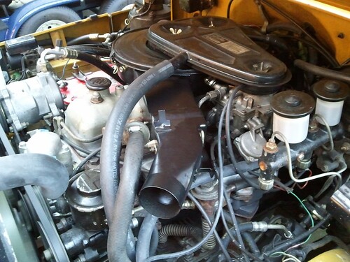

In the end, I used my old upper and the new lower.
The 'old' upper is not actually in that bad of shape. The old lower was a rusty POS, so AATLASX's new one makes the whole thing look nice.
Untitled by
Nice compromise. You definitely want those ports hooked up.
