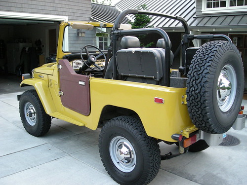

Got a bunch of random stuff done today:
  • Took pics of for-sale stuff and posted here
  • Installed new seatbelts
  • (re)Installed Tuffy Box
  • Fitted my Pakistan half-doors
  • Tried to determine why i'm still leaking coolant but failed (didn't try that hard):crybaby:
Comments & Pictures below...

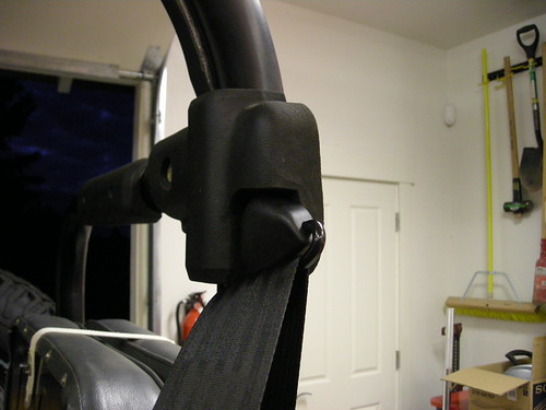

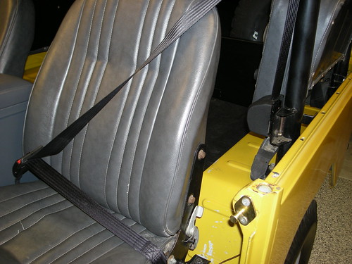

A few shots of the seat belts. Really exciting stuff. Bought these from CCOT and they work fine. They tend to "grab" more (the tensioner) when I go over bumps and the belt grabs my shoulder, but i kinda like it.
The nut welded to the roll cage where the belt attaches to the top part of the roll bar on the pass side was stripped. My metric die set does not include a 11mm X 1.25 die. I ran around trying to find one locally but no joy. I screwed an old bolt in to the "back side" of the nut and cut enough of the threads where the new bolt finally went in cleanly. In the meantime I ordered a 11mm x 1.25 die from Snap-on so I'll have one next time.:mad:

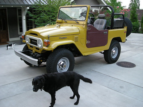

Here's the tuffy box, seatbelts and half-doors in one pic... When in Reverse, 2nd and 4th the shift knob *almost* touches the box. I'm gonna borrow Bull's torch and bend the stalk a bit...

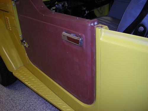

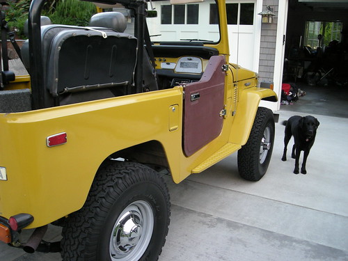

If you look closely you'll see that i've only installed the front two bolts for each hinge on the drivers side. This is because the paki doors don't quite fit right. I need to elongate the holes in the hinges about 1/4". The passenger side is fine.
Note LE the 18 year old kitten and Kona the black lab with a small brain.
Note the gap at the rear of the doors? This is with the strikers Eshan provided on the correct sides.
Just for kicks, I tried reversing the strikers. I put the left one on the pass side and the left one on the drivers side. Makes for a perfect fit.
If I get some weather stripping there won't even be any rattling...

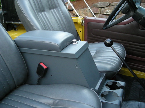

How wide is that box? No radio din correct?
6.5".
No radio in the box. The cheapo Kenwood the PO put in is just fine and is old enough that someone would be nuts to steal it.
