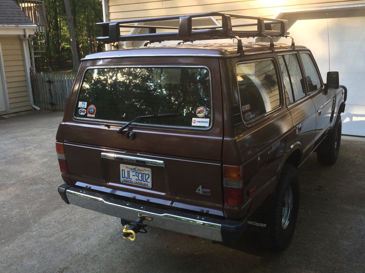

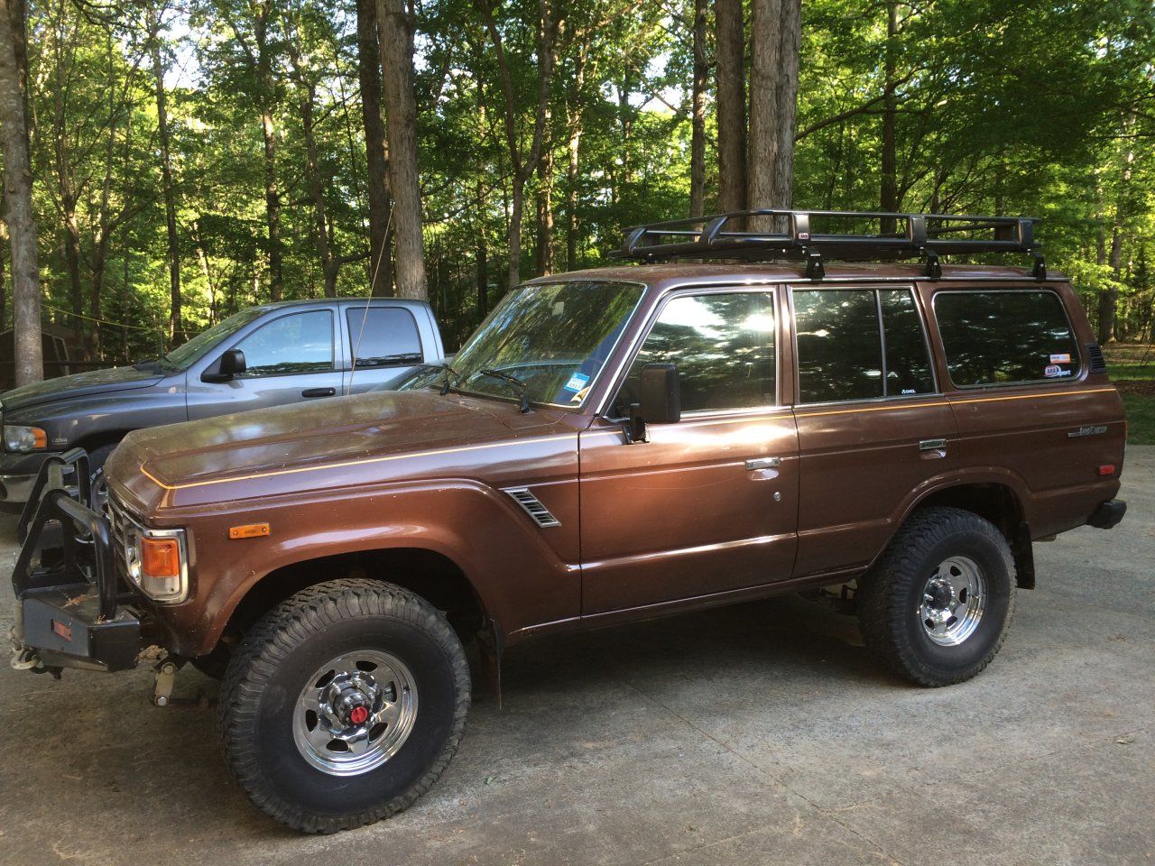

I put a roof rack on the Turd this week. It's the ARB for the 100 series so it's about 4" narrower than the 60/80 series racks. Eric @forrest5000 has more of these for sale if anybody is interested. I used Trail Tailor clamps and fabbed up my own extension brackets to span the extra 2" on each side.

View attachment 1250337 View attachment 1250338
Looking good! It defies logic that the 100 Series rack is narrower than the 80 Series. The 100 feels so much bigger.
it's because the 80 and 60 have rain gutters and the 100 doesnt
