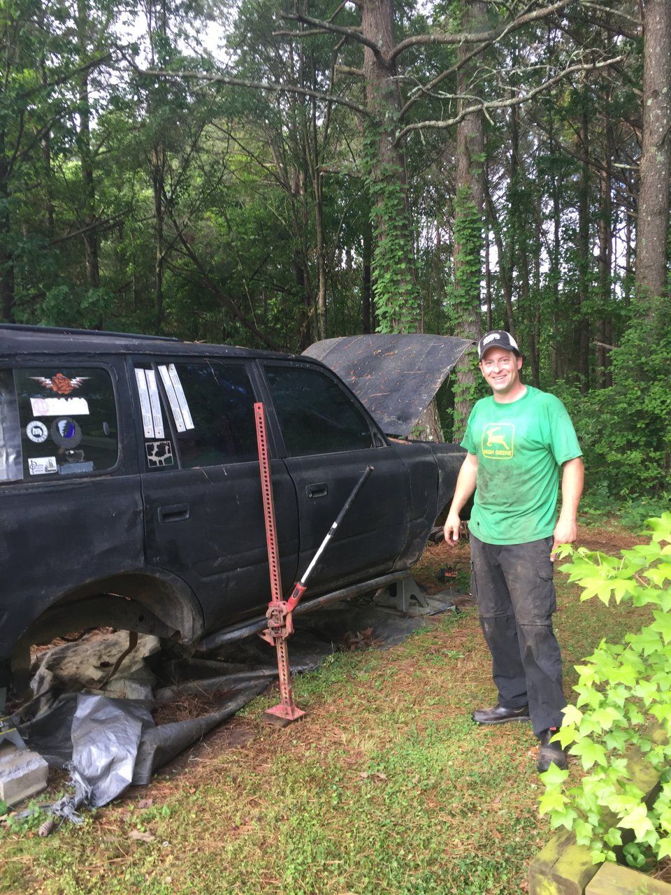

Robbing the raisin early this am so my wrenching can continue at home..... Stay tuned
A huge thank you to @beno for the parts hookup and letting me bare the torch of the epic Mrs CDAN mod. I will be back for sushi with more time to hangout and catch up. Be well dude.
A huge thank you to @beno for the parts hookup and letting me bare the torch of the epic Mrs CDAN mod. I will be back for sushi with more time to hangout and catch up. Be well dude. View attachment 1252102
Awesome to see you as well bro and thanks for the party favors.
The Raisin will live on in other people's trucks. As it should be.
@Teddy is coming down Friday to grind some sliders off I hear.
