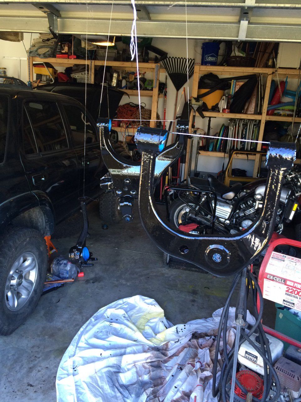

Of course I COULD be at The Relic Run, but instead I'm sucking down toxic smoke while burning out some bushings.
Yes indeed.
Doing uppers and lowers.
Inner and outer tie rod ends.
Upper and lower ball joints.
And wheel bearings on the left.
Everything but the wheel bearings (already done) on the right.
Wow!
Pressing those upper ball joints in/out was a pain in the butt :(
UCAs are so expensive for the aftermarket ones :( But, I think I am lazy enough to pay the $$ for them to avoid the stock UBJ work.
Wish I was closer to come help or just watch you do it :)
The ball joint wasn't too bad. The outer race on the bushings was real PITA.
Today I'll clean'em up a put the POR15 to them.
All wire brushed, sanded, degreasesd, and acid etched. Now just drying in the sun before taping and paint.
POR'd
Chassis Black tomorrow night then back together.
