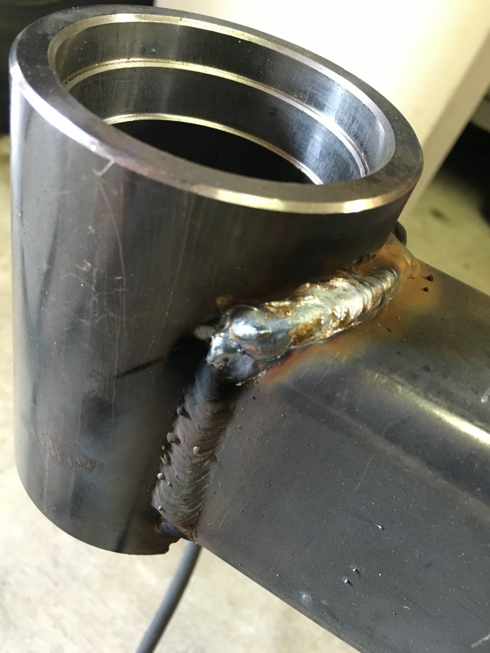

Got the arm cut, notched, and welded to the spindle shell and worked up a simple jerry can holder. There are gussets in place now that are not in the picture but it will be bolt on and removable hence the rigged up angle clamp. Kinda working with what I had here plus I'd like to make switchable accesories. Tube for the tire carrier next
No. Do you foresee tipping over front first? Build it internally if you think you need radiator protection, otherwise people will wonder when jeep made such a strange 4- door. But we all know my opinion is pretty worthless and I've done some stupid things despite the best advice not to. :rolleyes:
I have felt my rear suspension unload a few times before, so yes, it would be functional. Not at Uwharrie, but at Rausch Creek.
Think it looks that bad? It's going to be slightly taller than what I had before, similar to the orange one. I'll build the wings later this year.

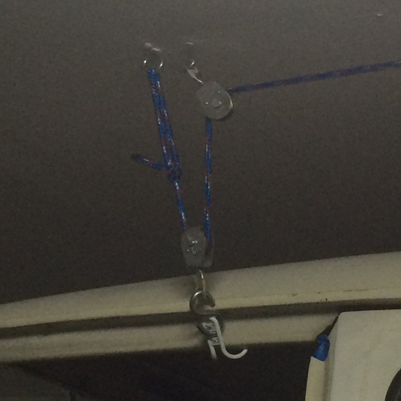

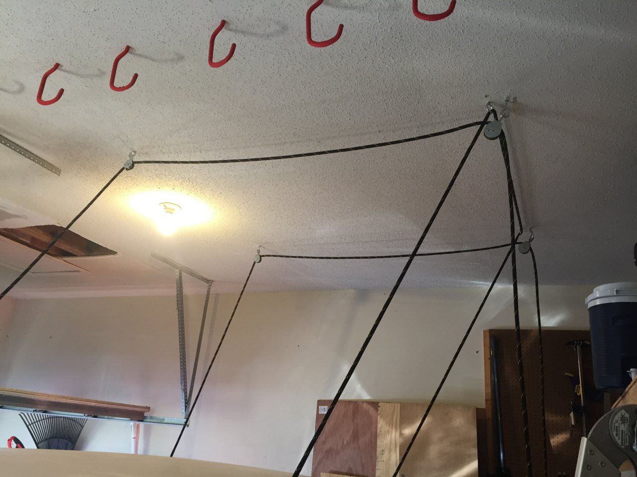

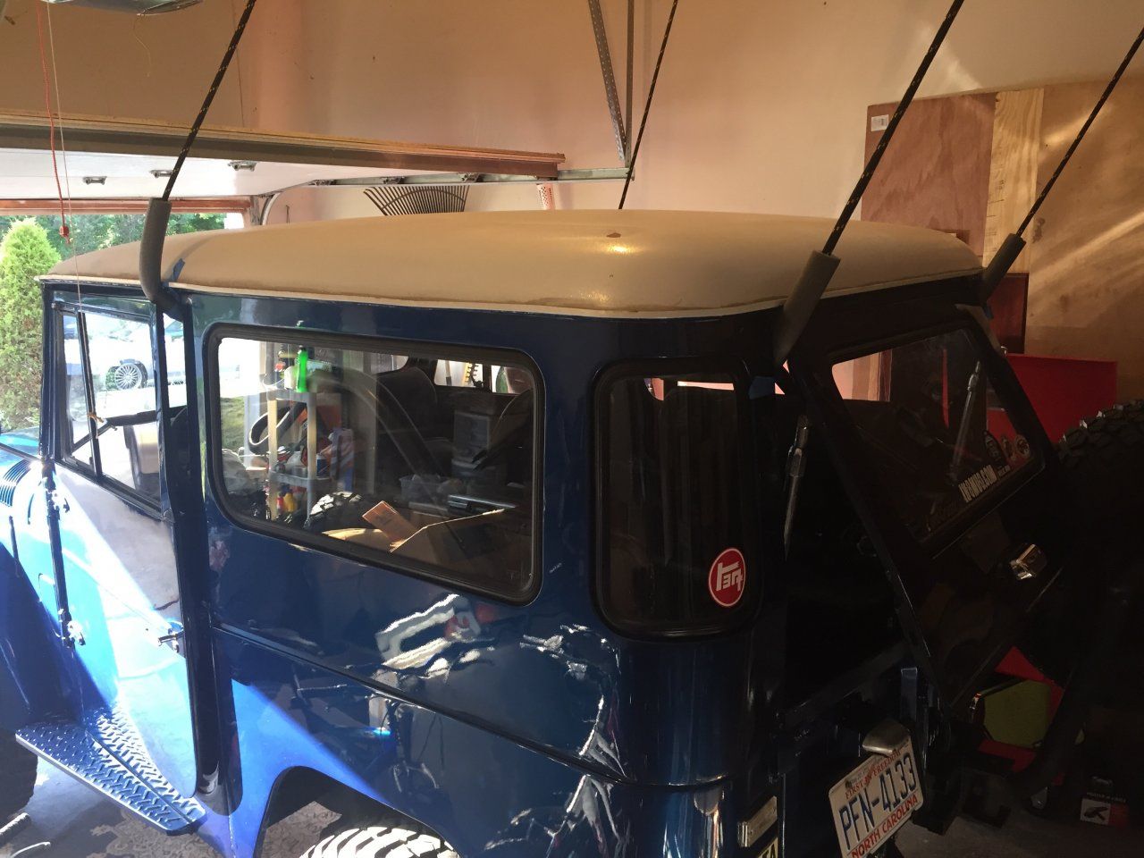

On another note, critique of my simple top lift/storage setup? I can't try it all the way until I have a couple of spotters...
Basically it's a rope tied through the top with pipe insulation to allow the rope to move 'freely' as its hoisted up. Couple of pulleys allow for the pullers to be in the right spot as the top swings back (the truck can be moved back most of the way but not all the way...
Thoughts? Prayers for anyone standing under it?

There are/were lots of threads in the 40 section on these (5 or so years ago when I last checked). I ended up going with an electric hoist from Harbor Freight and some seatbelt material. I had plans to go a different route with 2x4s that would go through the door openings in a V shape with the point out the rear doors but never got around to it. Best wishes!

Add an additional reduction if you'll be pulling by hand.

I'd love to see a pic of the setup or a reference thread that talks about the HF option. I've been chewing through threads and seems like the Amazon storage option for $130 is the preferred option if shelling out investment dollars. But electric is very appealing.
I hope to pull my top this summer for the first time. If and when I do I'll first need a hanging storage spot... So I'm glad to hear there are local examples and experienced engineers nearby!

I was able to pull the top off my 76 Dodge Ramcharger ( far heavier than a 40) with a pulley system with 1/4" heavy nylon rope and a series of mini block and tackles. It picked up from 4 corners with a double block and tackle at each point ( 4 pulleys on each corner)
It ended up on the wall in one line and tied off to a cleat. I had my mother operate it and she pulled it up with one hand. She was impressed, I told her that I had indeed been paying attention when I went to school. It really is an easy setup, pulleys are our friends :)
