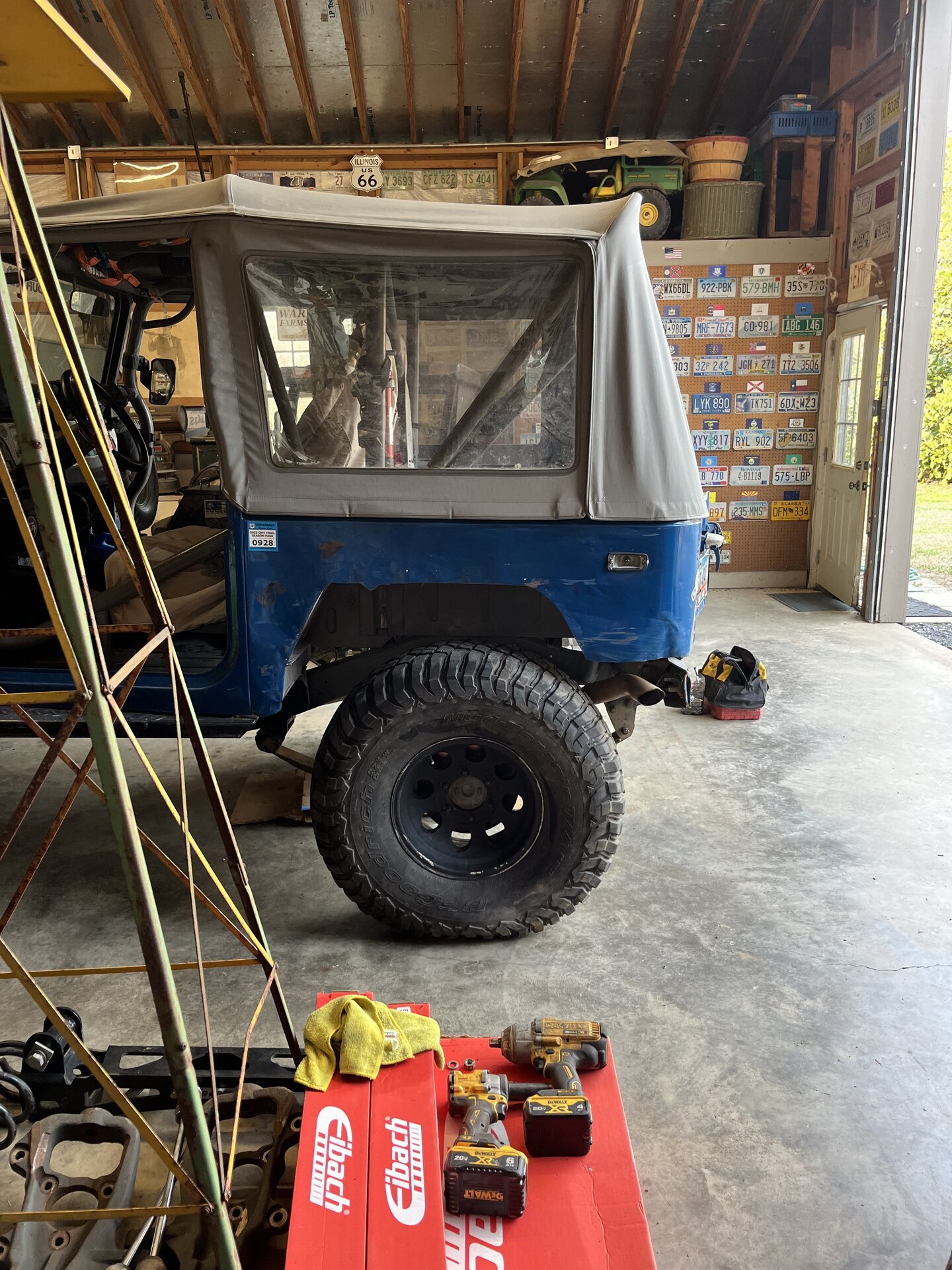

Finally touched the blue 40, I haven't even started it since I went to Leatherwood, Ky in it in November and it twisted the rear driveshaft.

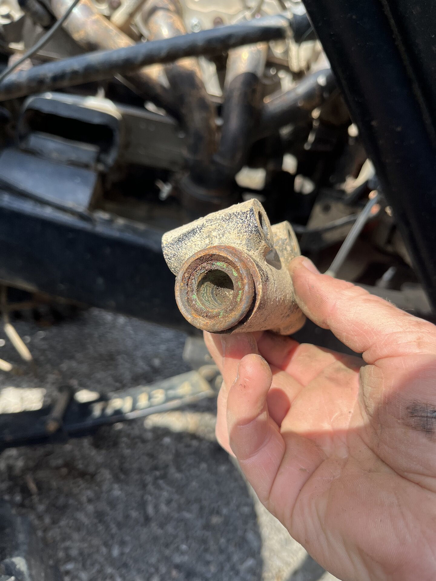

Sunday I flipped the rear springs for a 4"ish stretch in the rear. And discovered the clutch slave cylinder was completely rusted solid and the water pump is leaking. Guess that's what get for ignoring it for 3 months.
Goal is to replace the pinion seal, build a new rear driveshaft, extend the rear frame to axle brake line, cut the quarters, replace the water pump, replace the clutch slave cylinder, and hopefully reattach the air line for my ARB that got ripped out when the driveshaft went in to orbit.
This all has to get done before I go to Stoney lonesome and Hawk pride March 13th, while simultaneously moving and changing jobs. Seems easy enough....

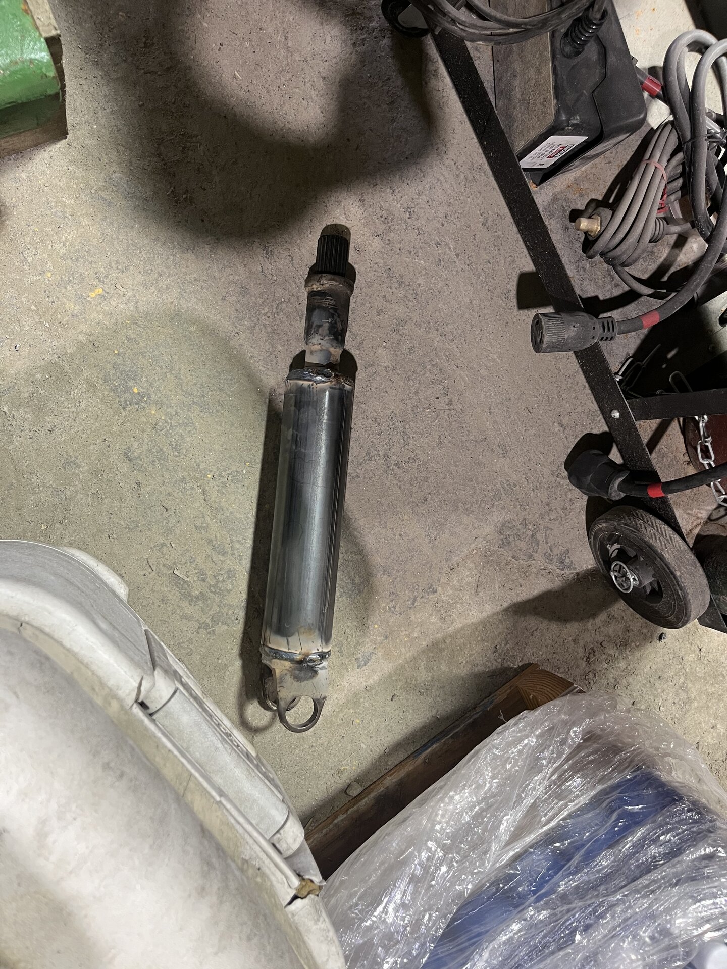

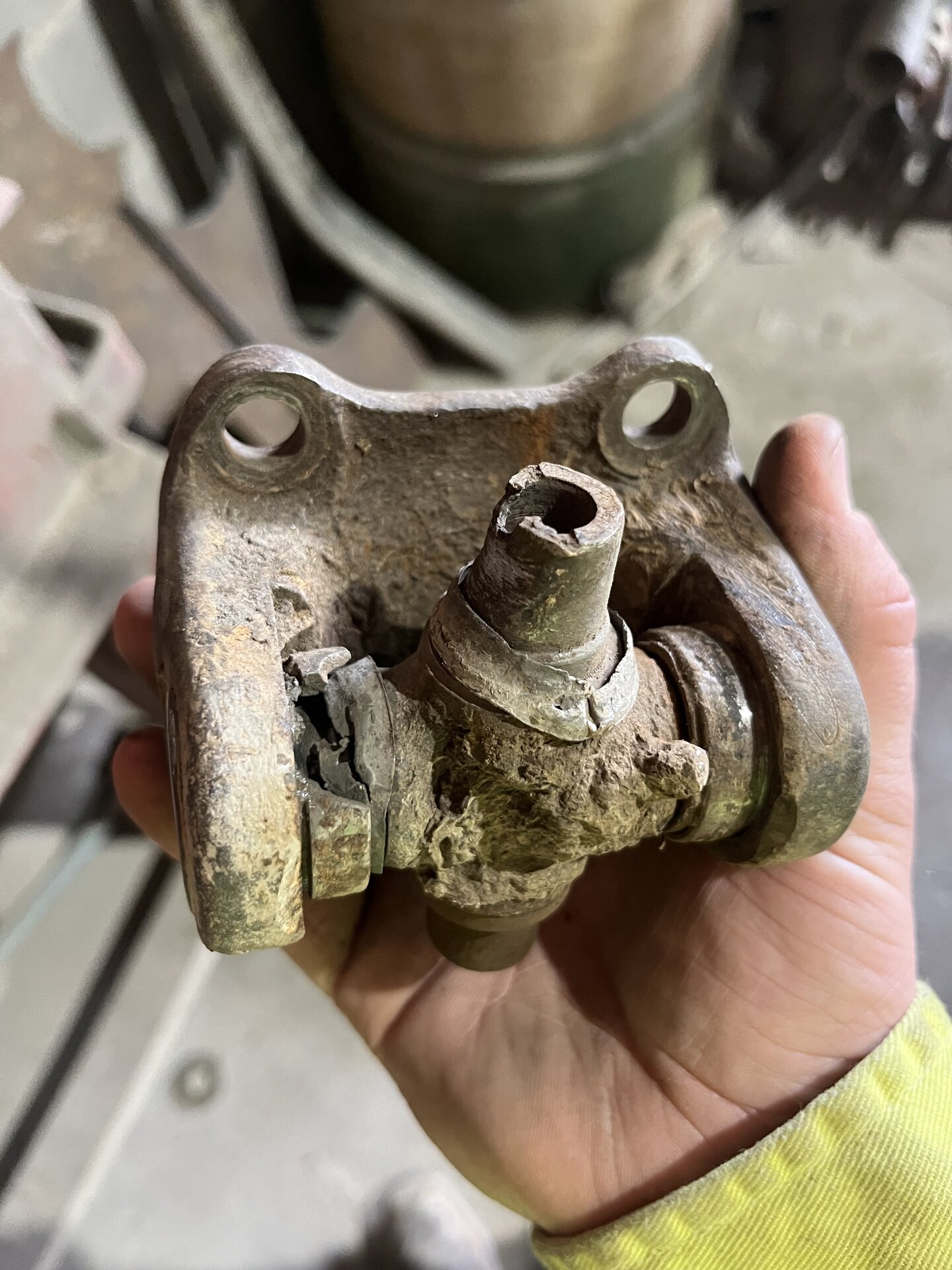

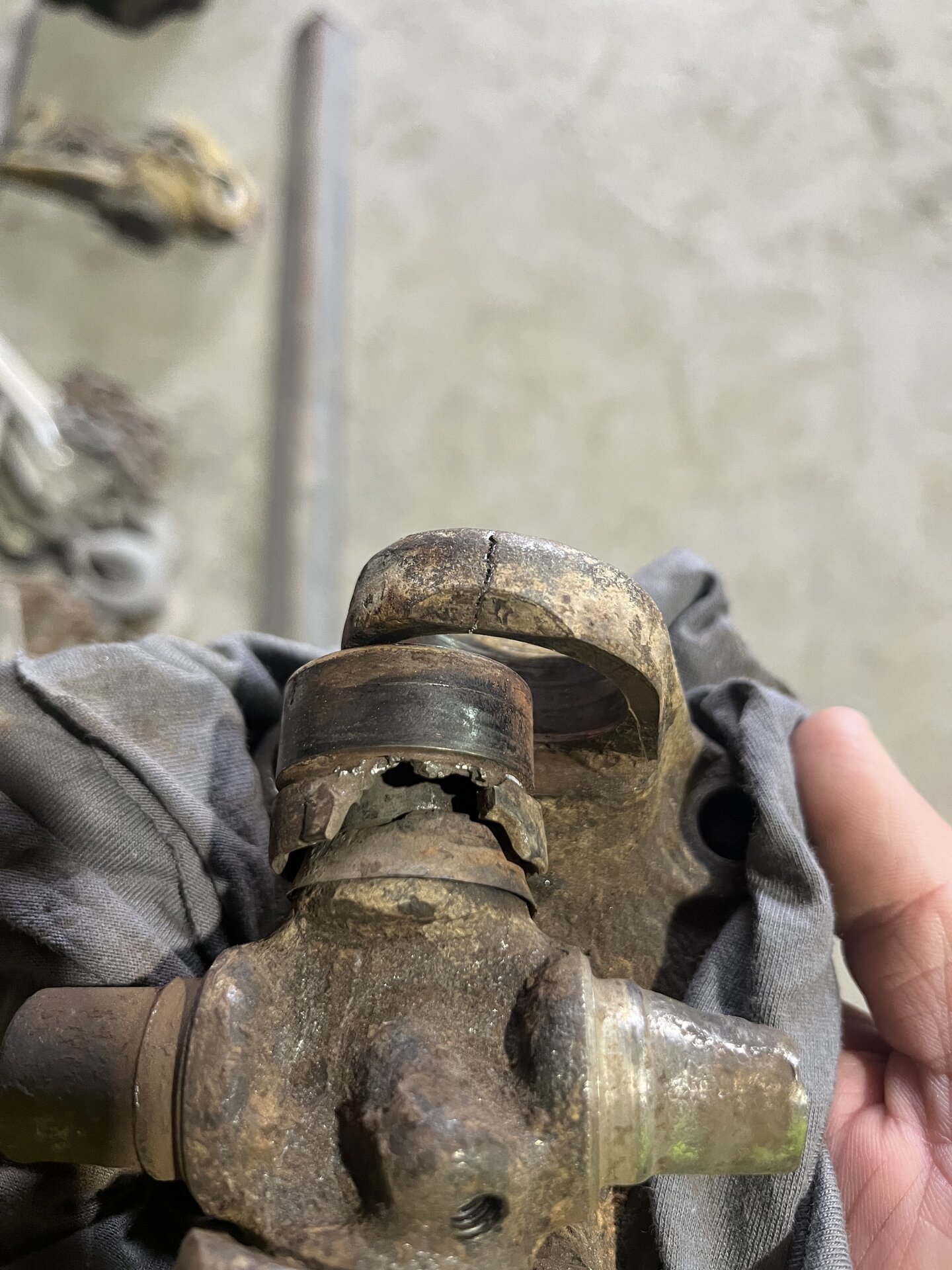

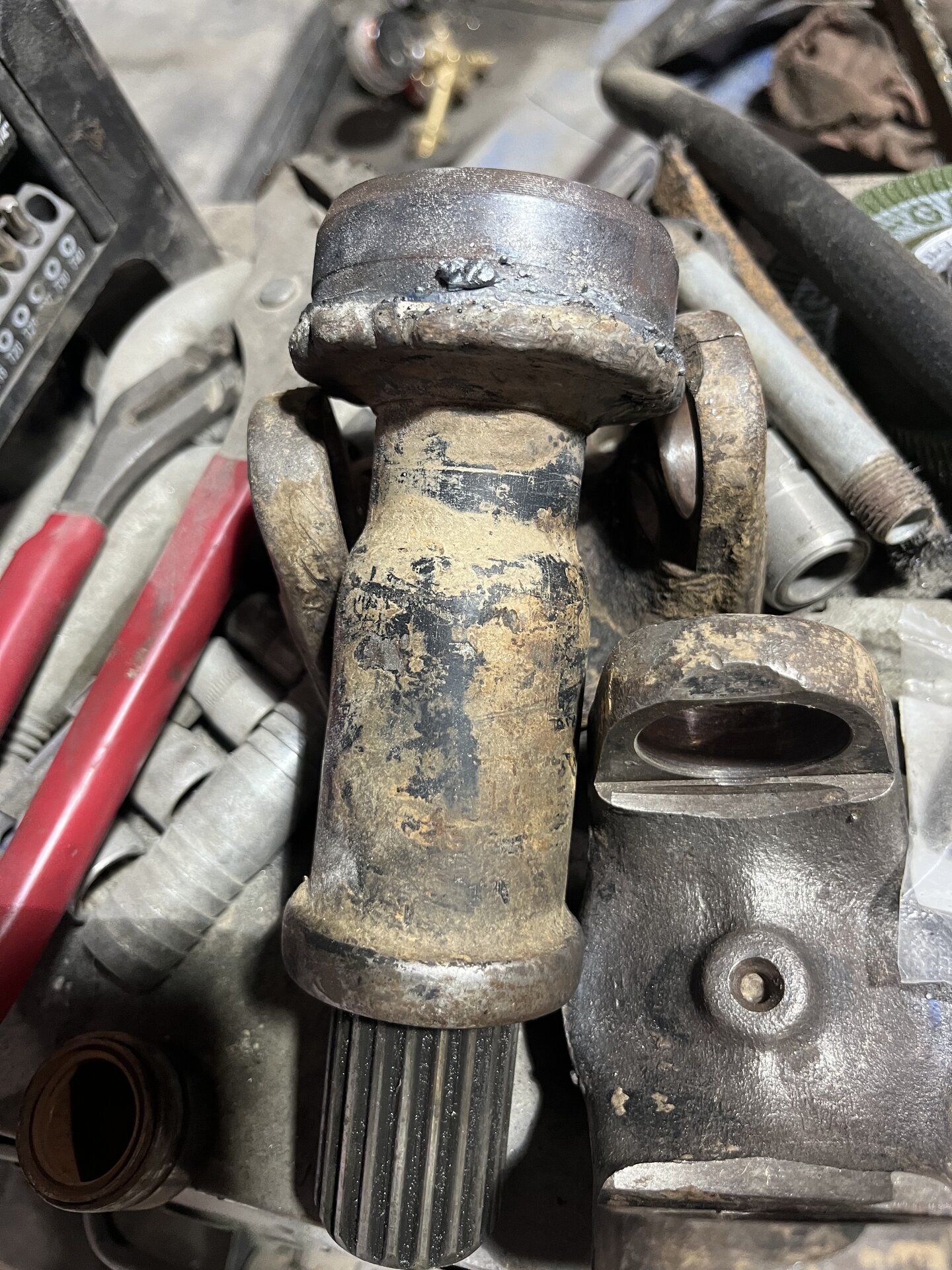

Finally got around to working on building a new rear driveshaft. Of course I waited till the week before my trip, why would anyone ever start earlier.
Got the twisted shaft cut off the yokes, and used a lathe powered by cordless drill to clean them up. And centered the sch40 pipe as best we could. Unfortunately the driveshaft flange cracked when I pressed the busted U joint out so that's the current hold up.

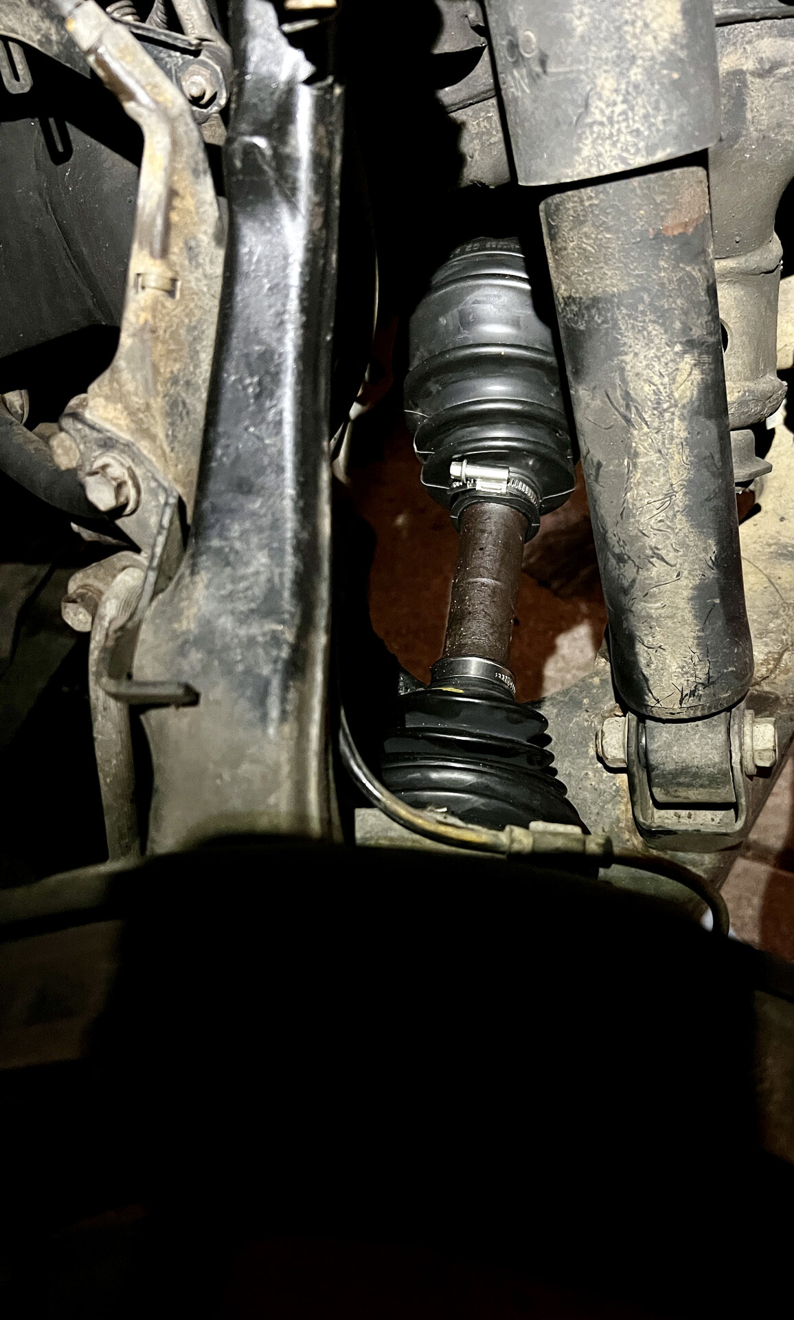

Rebooted my CV's on the LX yesterday after the driver one puked all of its grease out of the inner boot due to a big tear. They'd been weeping for a few months and I had parts on hand to do the job but wasn't planning on doing it for another couple weeks.
Used McMaster clamps (aka. Pfran clamps)

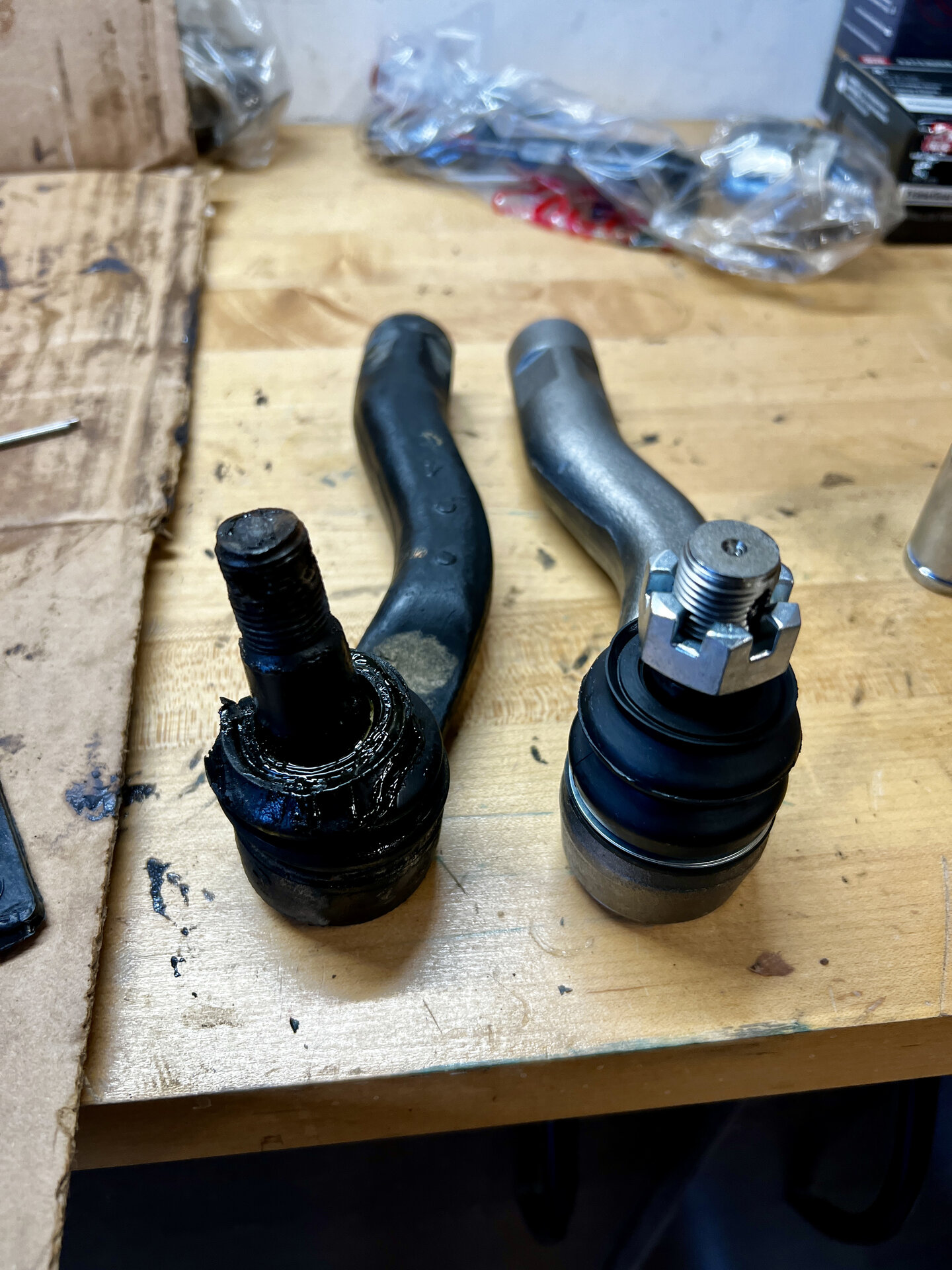

Also replaced both outer tie rods.

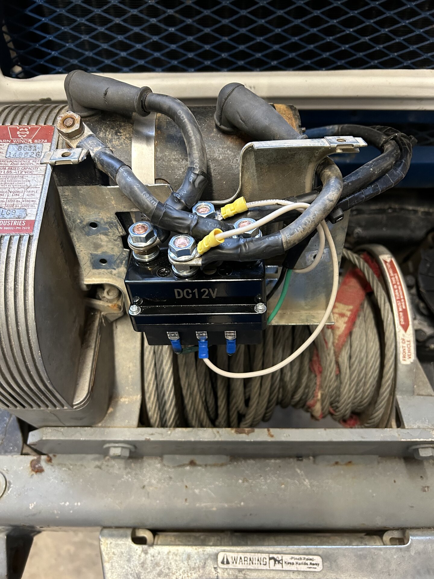

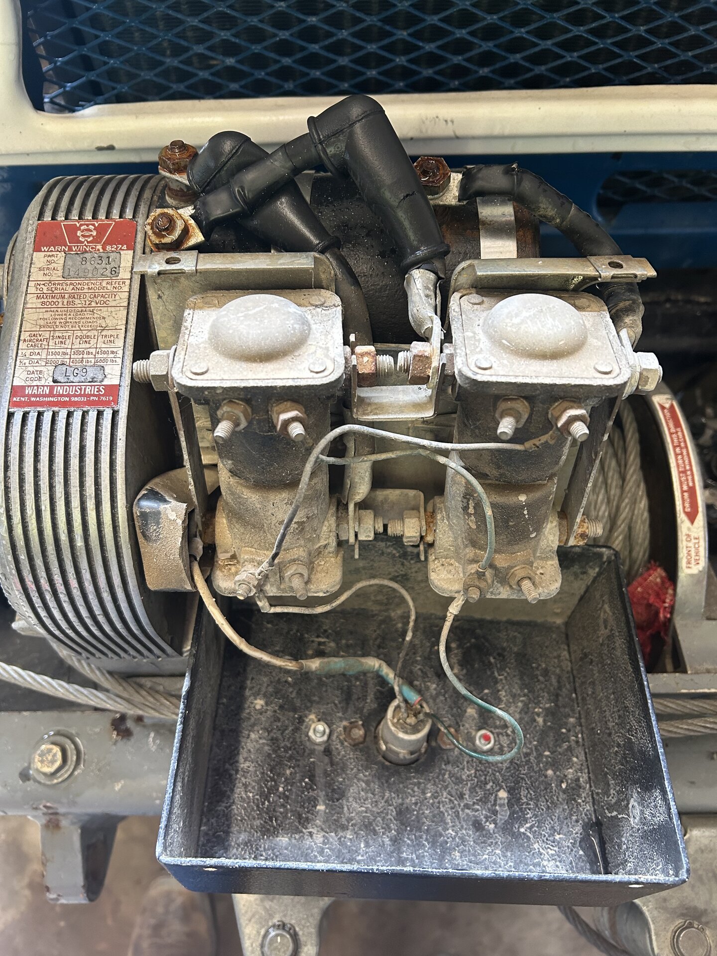

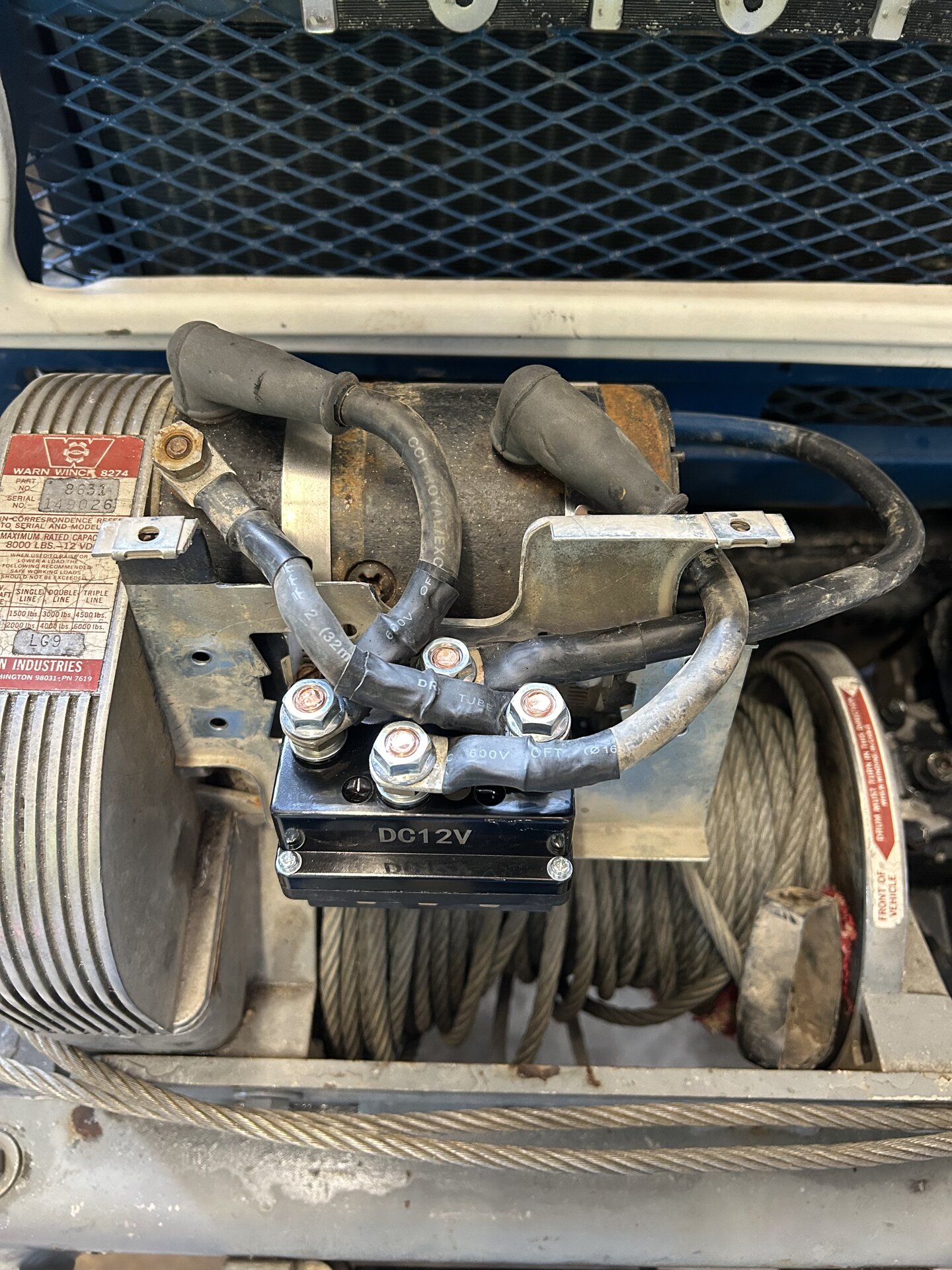

Then I started converting my 8274 from the factory solenoid pacts to a contactor. Unsuccessfully…
Could it have something to do with buying a $28 winch contactor off Amazon? Yes. Does it? Unsure.
Got it all wired up, plugged the controller in, bumped winch out, and it started spooling in and wouldn’t stop. I had to disconnect the battery. Fortunately I’d had enough cable pulled out it didn’t get tight and burn the winch up. Disconnected all the control wires and it still did it when I tried reconnecting the battery. Even once I disconnected the ground cable from the motor(I assume it must be grounded through mounting as well). So I finally removed the contactor entirely and unhooked the winch from power for the time being.
Probably gonna return and buy the Albright for $80

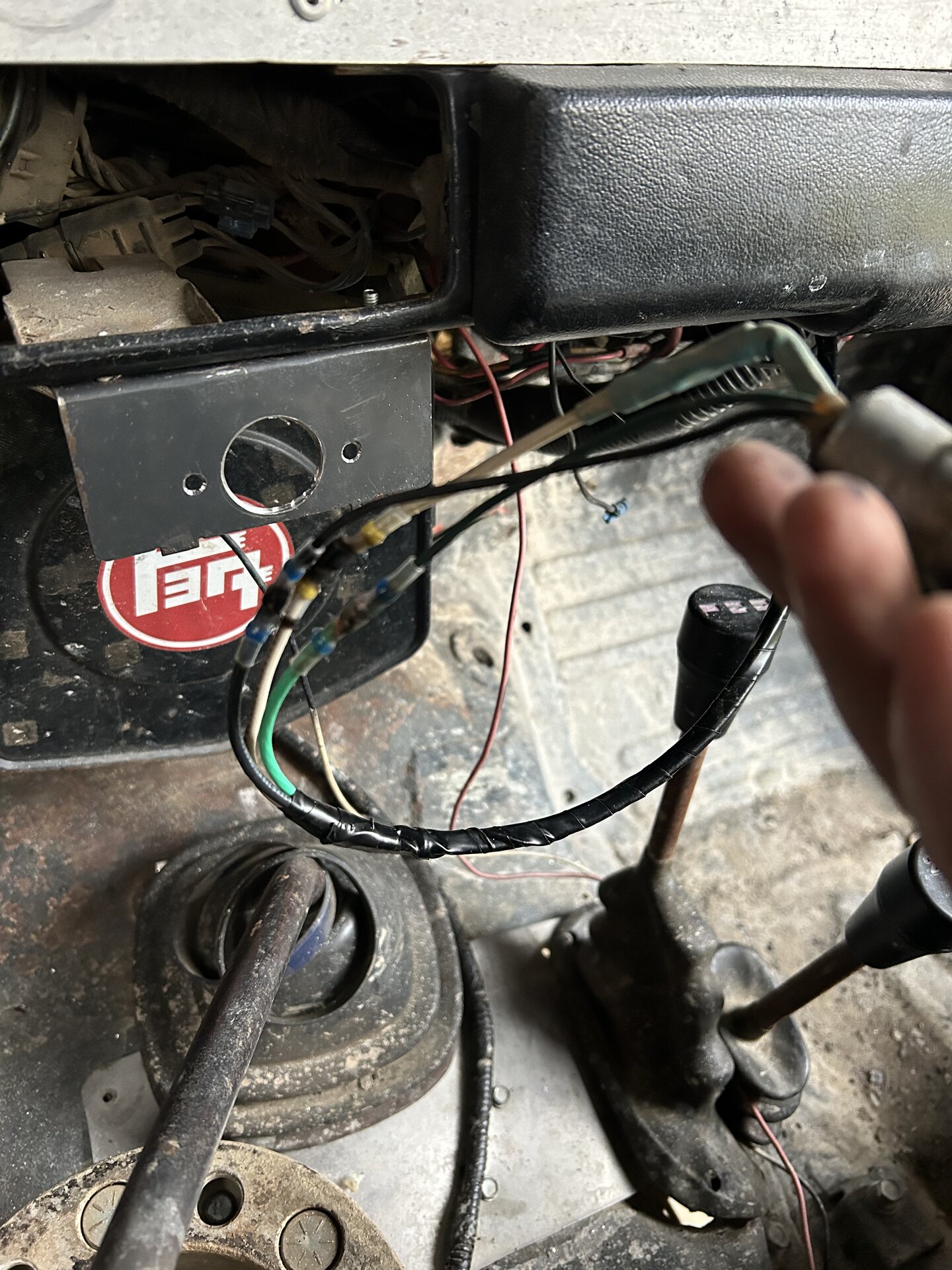

Can’t forget I had to relocate the winch controller plug so I moved it to the dash, was very proud of the little bracket I’d whipped
Up, and forgot the route the wires through the hole before connecting. Oops
