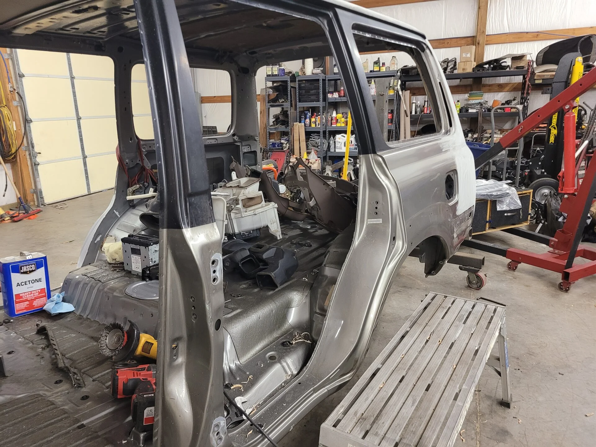

Wrenching.... but Subaru wrenching. Sadly the reason I haven't been able to move much on the cruiser outside of getting the engine/trans and the adapter kit is the subaru has been eating up my time and cash. Not sure if anyone even remembers me buying an oubatck XT wagon a few years back. Hell I barely do since i've only now driven it about 720 miles in that two years. Suspension was messed up when I bought it due to it being slid into a curb in the ice storm from two years ago. I replaced the entirety of the back suspension and subframe, excep the sway bar. I also replaced the front passenger control arm. Got it driving straight just to find out that it spewed coolant all over the block every time the boost hit. Passed the compression test and leak down test so I was confused as to how it was happening and went around looking for hairline cracks, cloged coolant lines (there is a ton on this car) etc...... finally figured out that the block had been slightly stripped around one head bolt and it lifted slightly under boost. Rather than getting a new block and resuing the old stuff or fixing the back block I just got a brand new remand enigne from a local subaru shop.... they ended up installing it as they were light on work and did the install for only $250 extra including adding some other parts I bought (flywheel, clutch, motor mounts, radiator, all the cooland hoses, hard and soft, better oil pick u and baffle for the oil pan and a cylinder 4 cooling modification) so I coulnd't pass on that deal and not give myself a headache. I've put 700 miles on the new motor so far and im now about to install, bigger brakes from a legacy spec b, whiteline front a rear sway bars, bushings and links, a bigger all metal intercooler to make sure I don't get any boost leaks (the factory is a plastic formed to metal on the ends and they are notorious for leaking or splitting), a master clyinder brace to stop flex from the thing weak firewall, a air/oil seperator (another relibilitiy mod that every subaru can benefit from) and a strut tower brace. Always wanted a fast wagon and this one will have around 350 HP at the crank when done. Just need to find a bit more leg room with some seat extenders. Car already had a slightly bigger turbo from a newer wrx, cattless up and down pipes and a tune when I bought it.

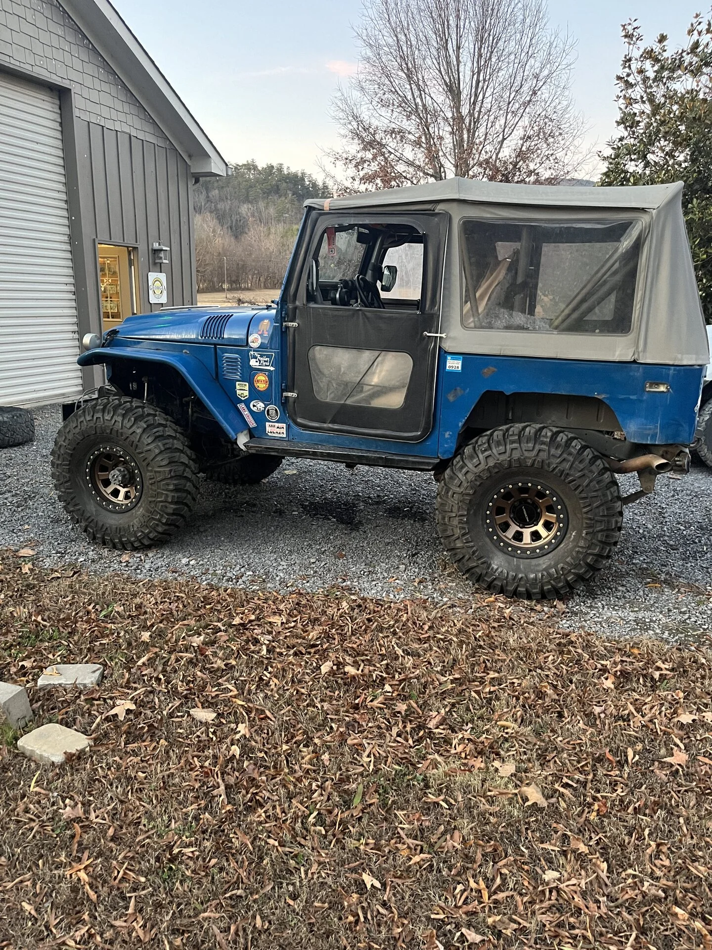

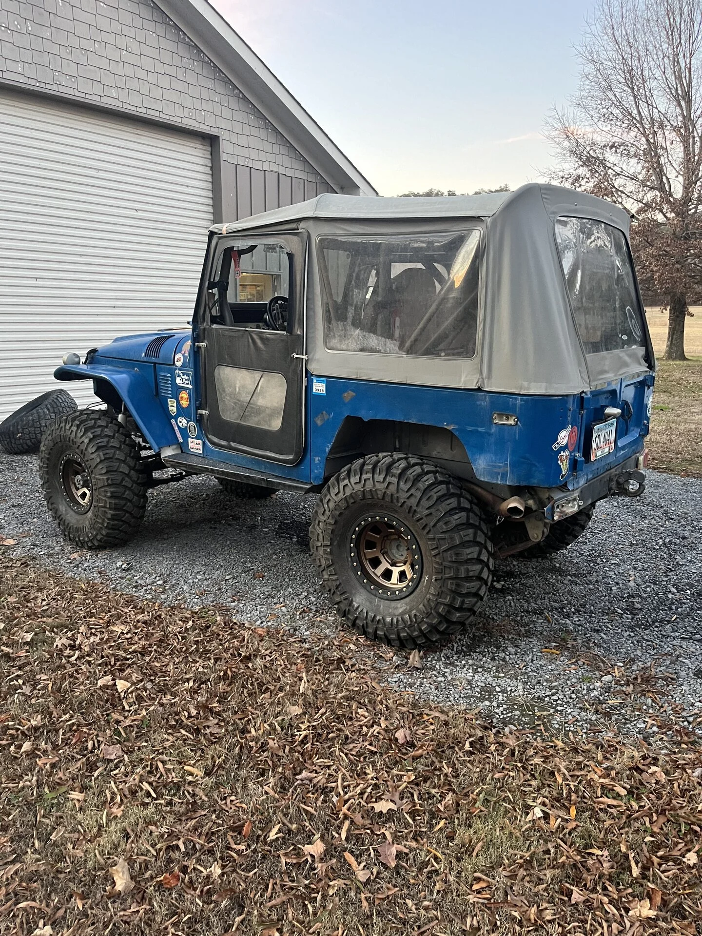

My new to me 37s and beadlocks I just got installed, really helps add some motivation! And yes I know the rear tires are ridiculously close to the body. It won’t ever get driven before being stretched.

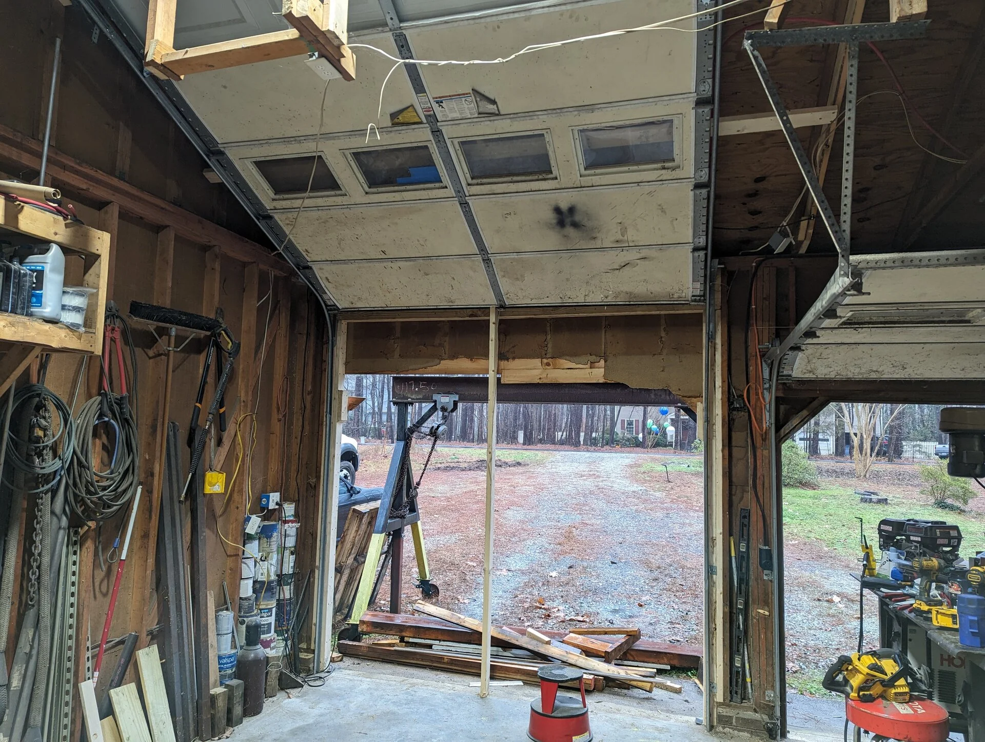

Twt on the garage? Making my garage doors taller has been my winter project.
Sheathing and siding below the header will be removed. Trying to stay low key till I get both doors done.
did you buy new tracts, or just find extensions?
I bought a used 7' door off Craigslist with the panels and tracks. I modified my existing and added a few extensions cut out of the tracks that came with the used door.
