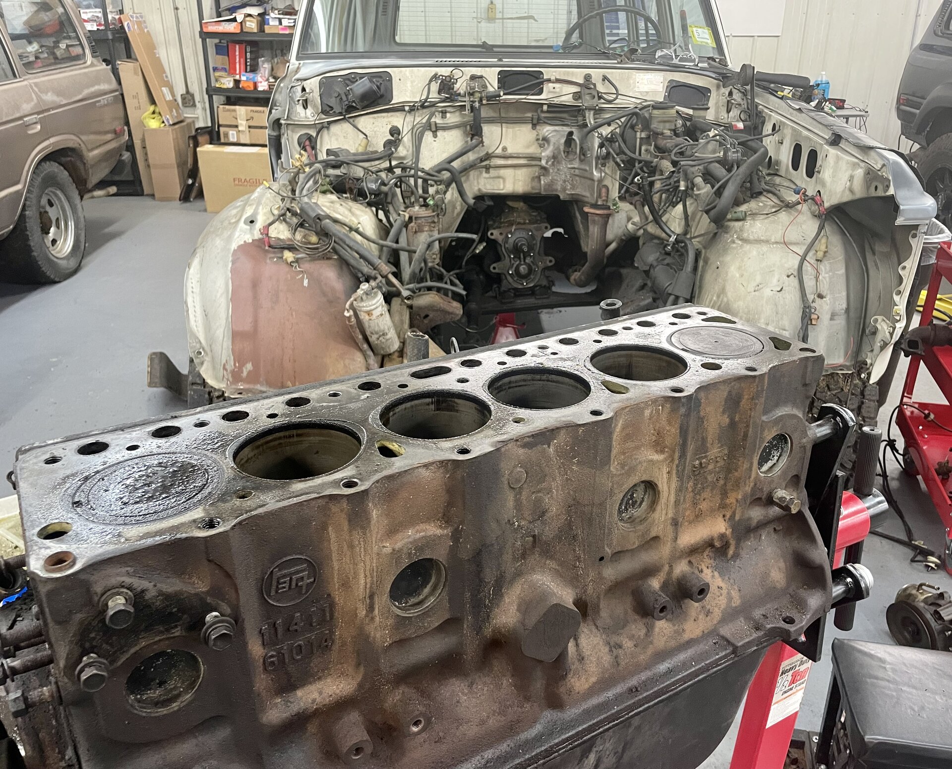

Had to hang out while an electrician was doing a job, so I had some time this morning to work on an engine I plan on cleaning up, refreshing gaskets etc, and swapping into my DD. Finished getting it stripped down to the point of pulling the head.
Found a little surprise on #6. Not sure what’s going on there. The cylinder wall looks really good, not like water was sitting in there. The valves for #6 look fine…just like all the others. HG didn’t look like anything was going on different than all the other cylinders. It almost looks like a defective piston made it past QA/QC and a line worker just said eff’it late on a Friday.

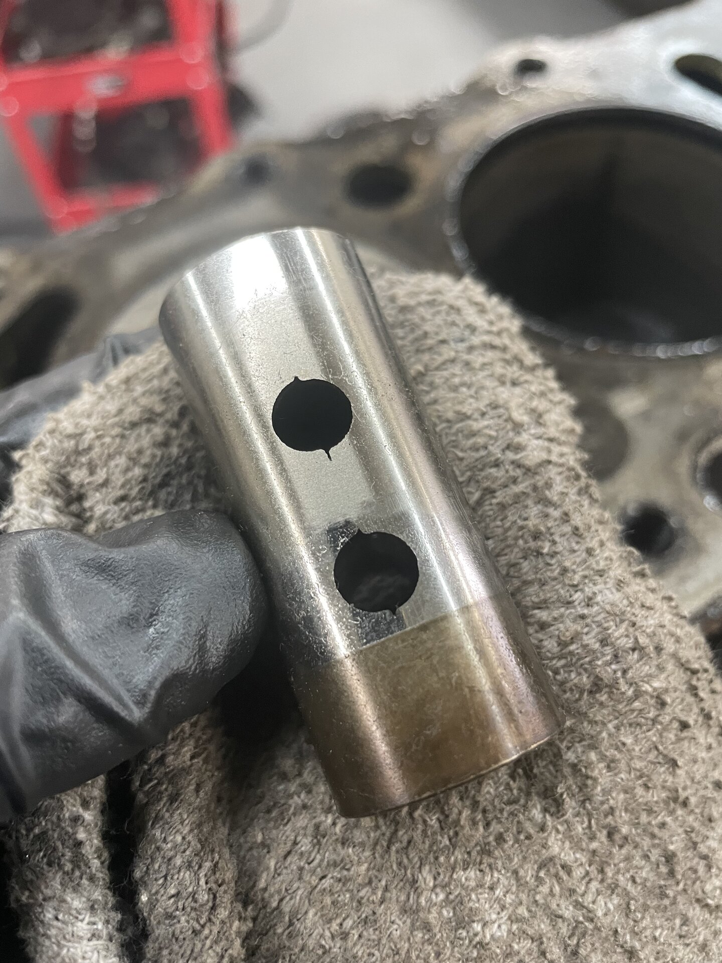

Peeked at the lifters and all looked good except the guy. It was the only one with those cracks. I’ll probably go ahead and replace it.

The #6 cylinder looks kinda like it's been going through detonation.

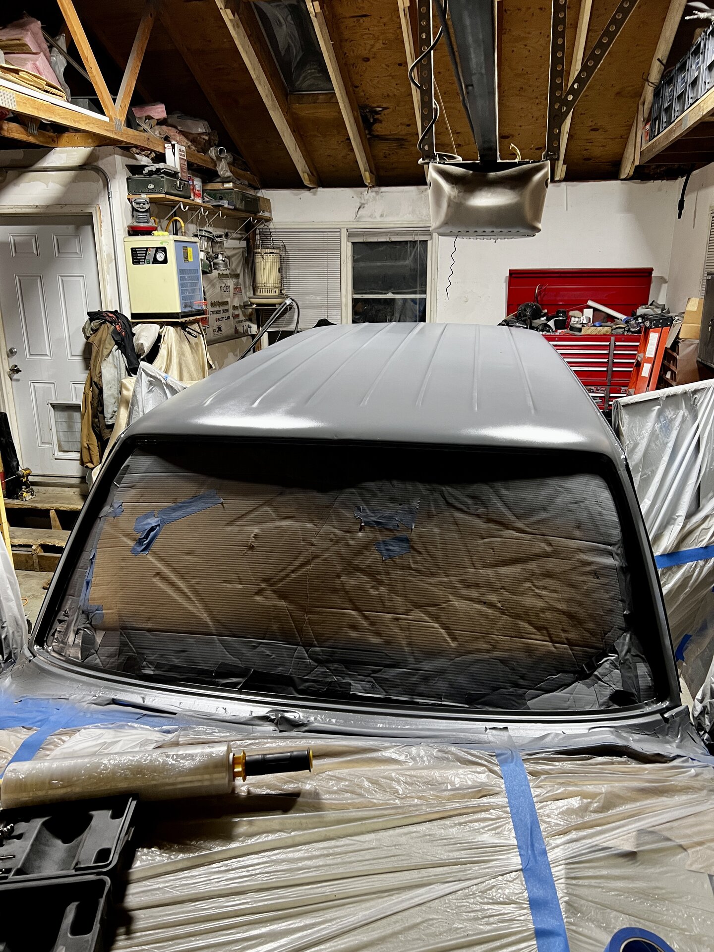

Big milestone on the FJ60 roof rust repair project that Johnny has been helping me with the past few weeks. Got all the metalwork done and laid down the first coat of primer last night!
For those who haven't been following my build thread, my factory roof skin had some egregious roof rust in it that needed attention. We took a donor roof skin, ensured it was rust free and swapped it onto my existing roof structure after patching a couple areas of the structure. We are in the final stages now!

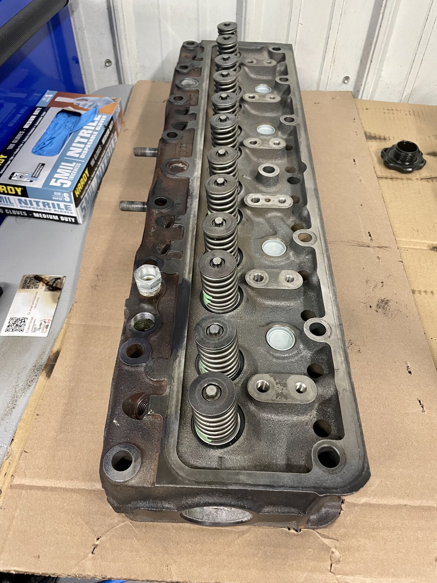

Got the head back from the shop today. Cleaned up, valves done, everything checked, and new springs. They finished a week earlier than estimated, which was nice but I can’t do much with it while I wait for a few parts.
In the meantime I cleaned and cleaned some more…

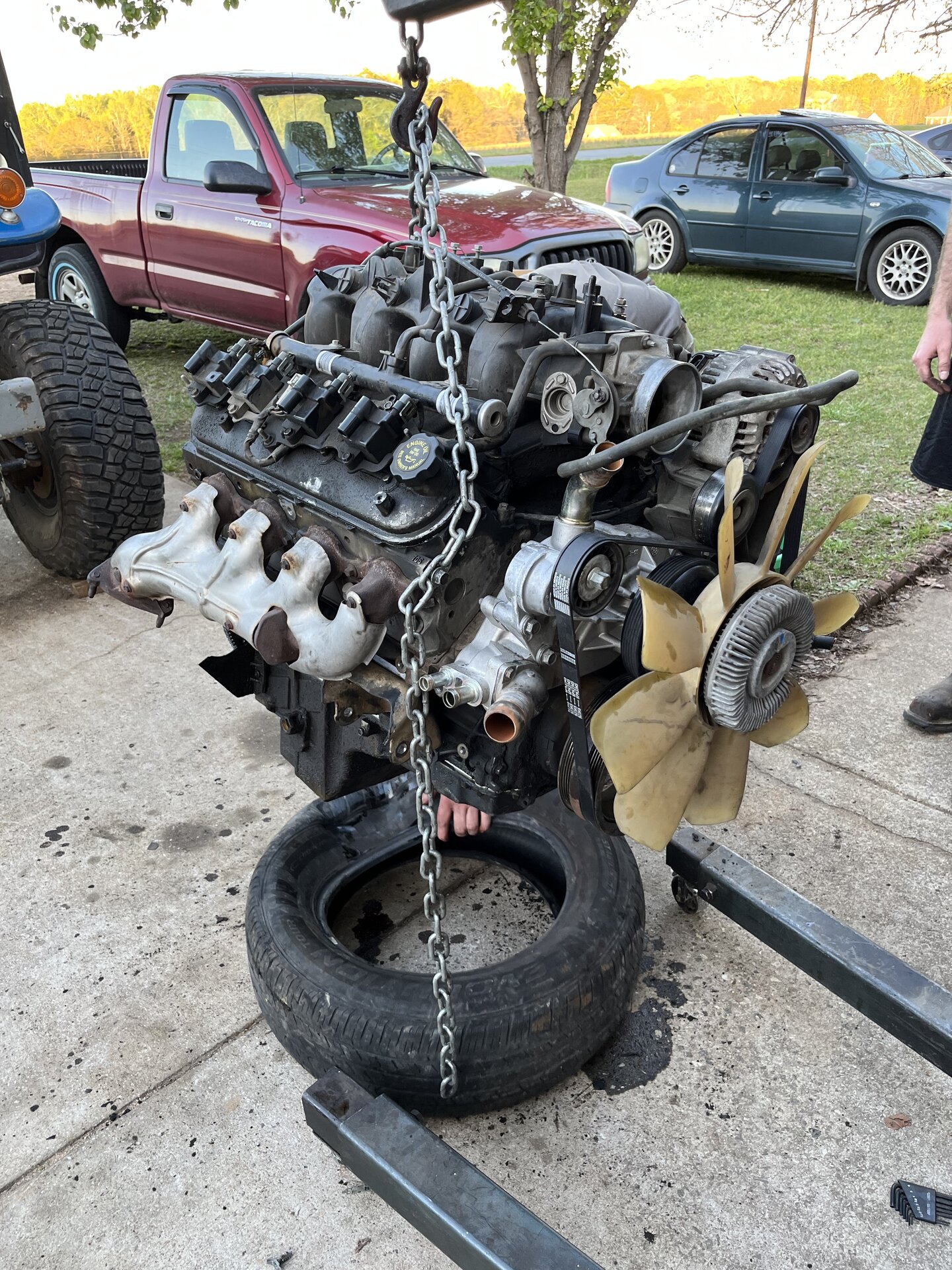

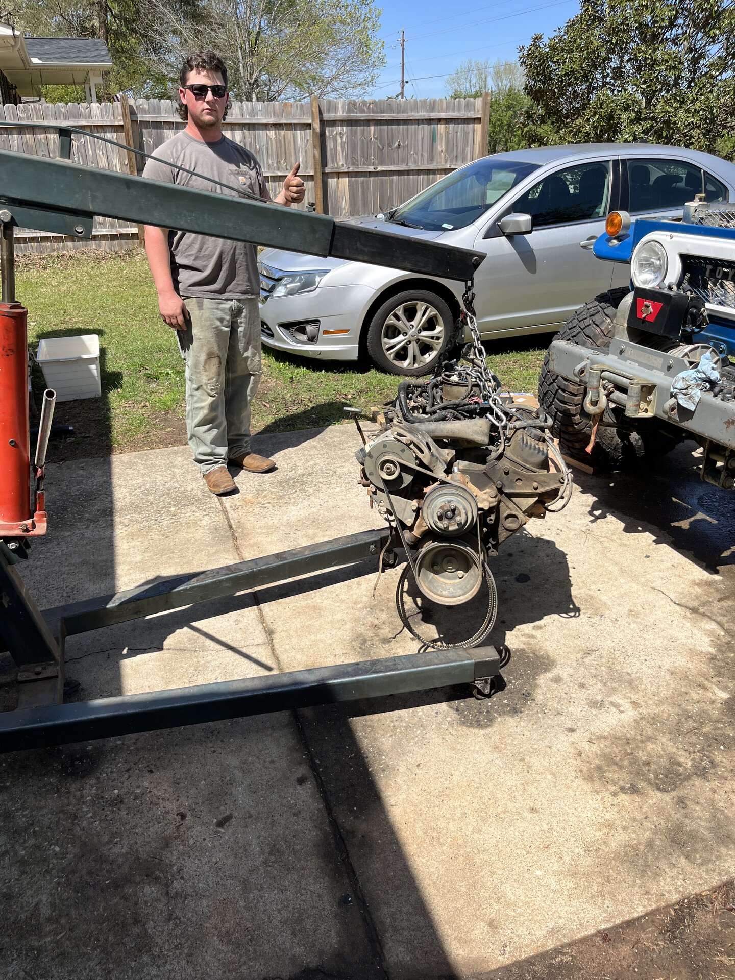

LS swapping the blue 40. I’m tired of dealing with the TBI and it’s honestly easier to stuff at LS in it than to de-hack the TBI swap.

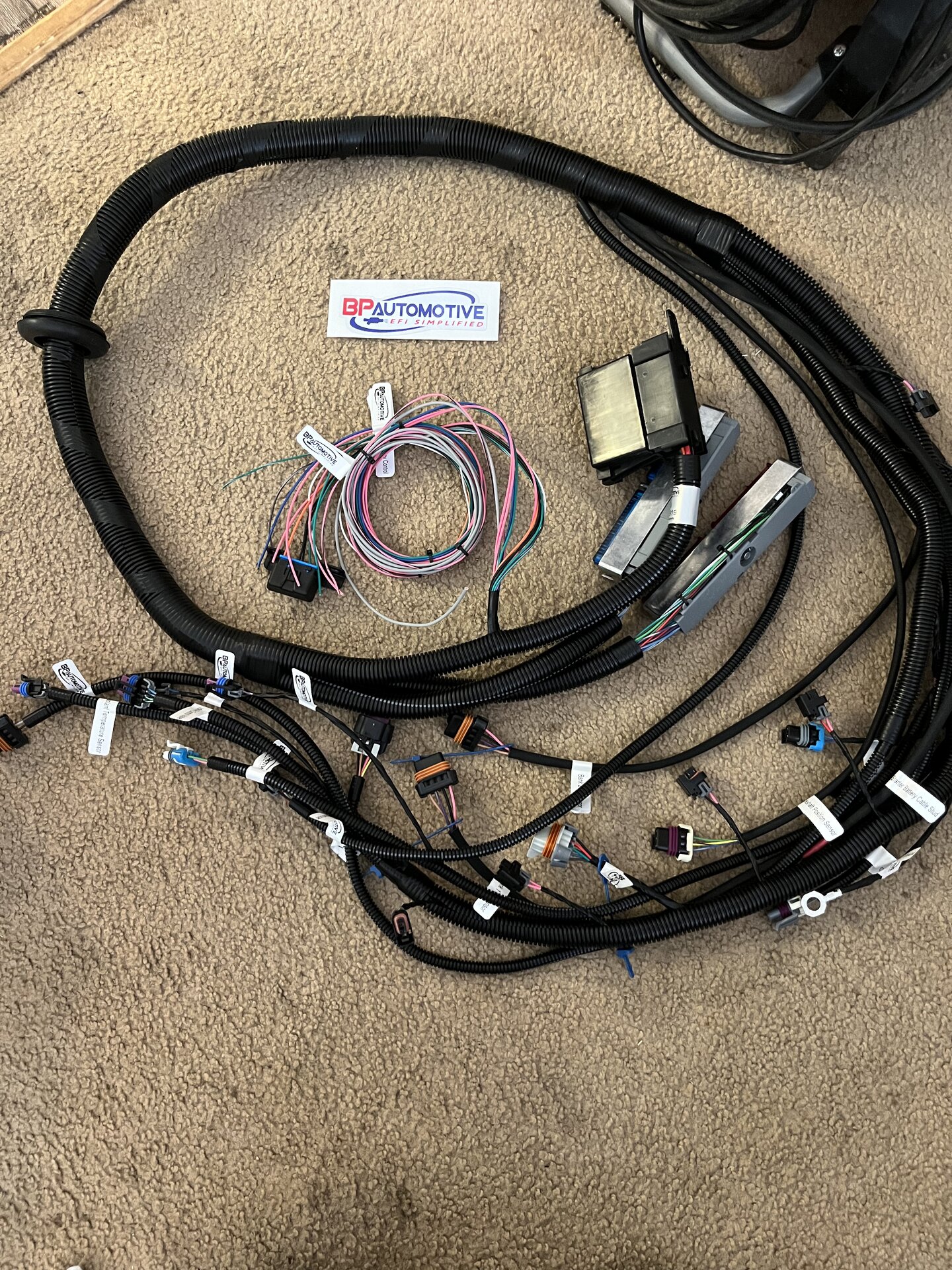

Got a basic drive by cable 5.3 out of a 2002 Silverado (LM7) from the junkyard for $305, and ordered a nice BP Automotive standalone harness. Trying to keep it simple.
Ordered all the other swap parts a couple days ago, should be arriving this week. Planning to pull the 350 Saturday.
If anyone wants an alleged low miles 87ish TBI 350, it will be for sale shortly.
Making quick progress on the LS swap, got the 350 out today in an hour and a half. Got all the swap parts delivered but the headers on Friday. LS is going in tomorrow.
Also discovered my trans crossmember is about broken in half so gotta remedy that.

And she is in! The goal was to have her running today but a few things prevented that. Discovered the crank position sensor was missing, explains the removed starter before I started pulling the engine at the junkyard. Need to grab one and a handful of small things from the junkyard and we’ll be in business!
Biggest battle was mating the engine to the trans, had a time getting the trans through the clutch. But we eventually got it at almost 11pm, we started at about 5pm today on the swap.
Headers are supposed to arrive Tuesday, picked up the ECU from the tuner today. Hoping to have her driving this week!
We have now hit the portion of the swap where I start finding the unexpected issues.
It’s all pretty small things but slows progress.
Had to order a new fuel pump, finally ran the part number on mine and found it isn’t strong enough for the LS. Using this opportunity to stick a walbro 255 in and actually put it by the tank, not on the firewall. So it can push not pull.
Gonna have to get creative with my airbox setup, thinking maybe cannibalise a vortec 4200 setup combined with the 5.3 stuff.
Also have to figure out the speed sensor for the trans.

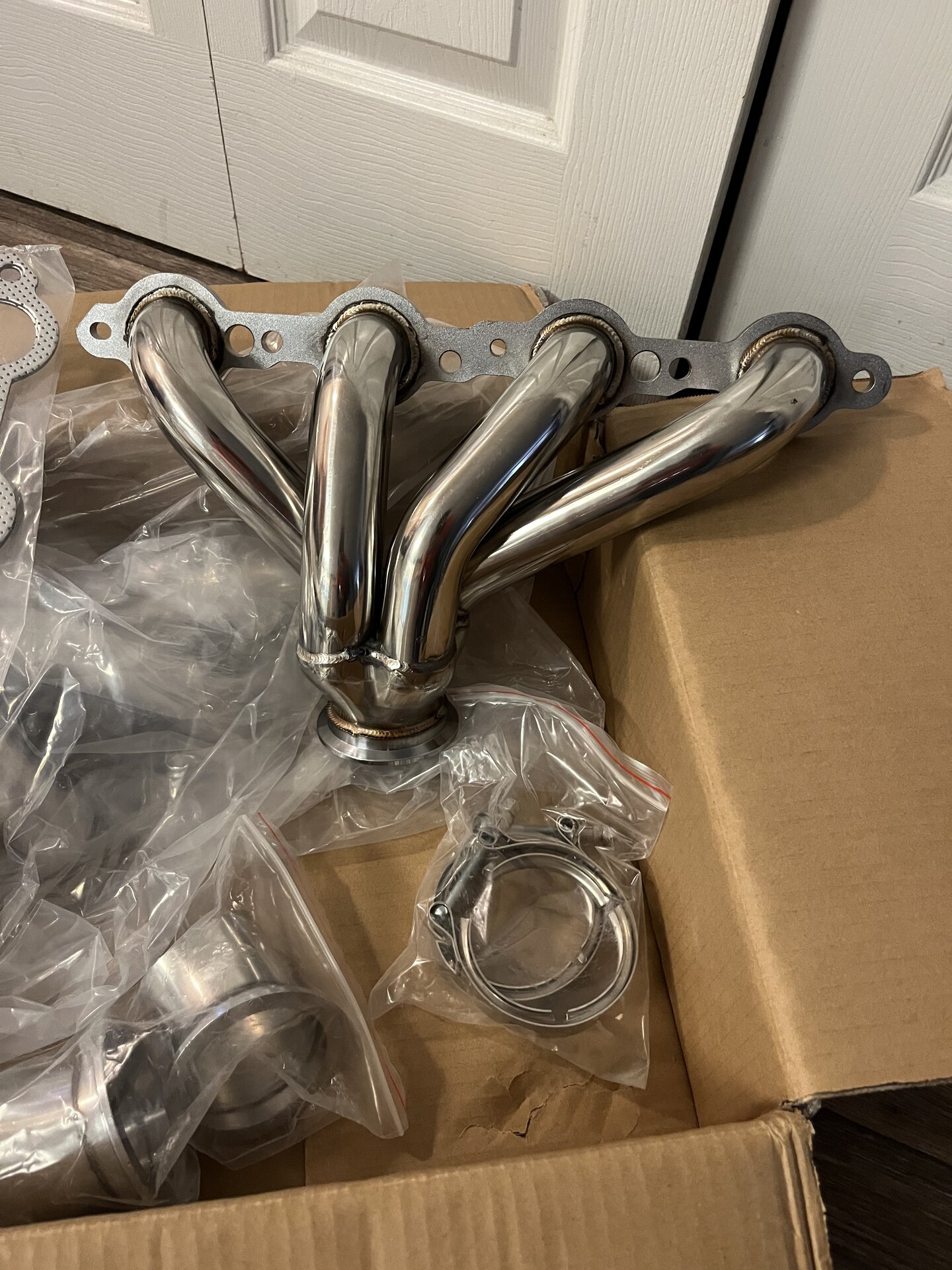

But headers showed up finally today and fuel pump stuff shows up next week.
