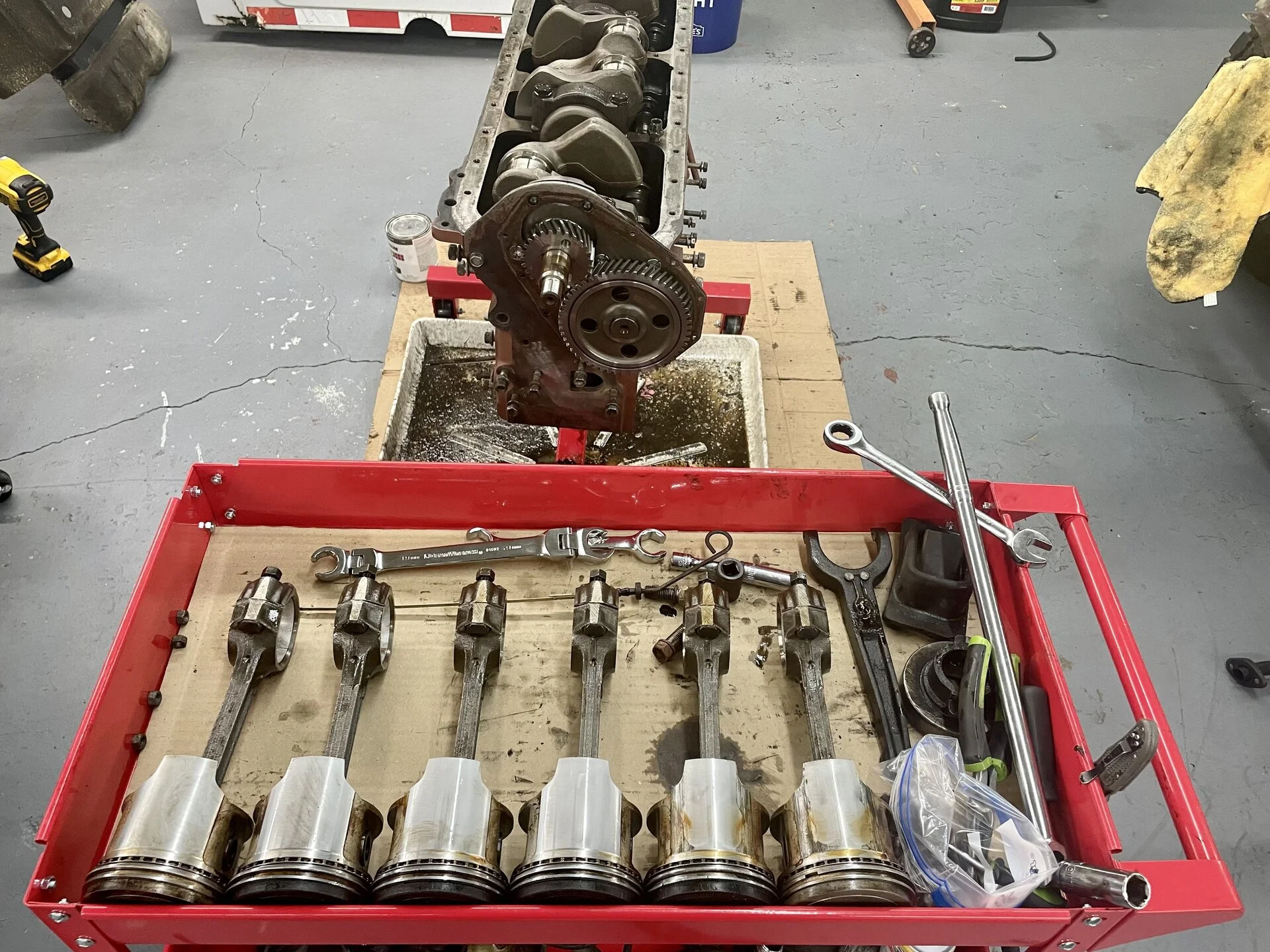

Pulled the pistons to re-ring and replace the bad one. Besides that piston and thick oil sludge in the pan from sitting for 12 years, everything looked pretty good. I’ll start reassembly after I’ve chiseled off all the old original cork gaskets that have fused with the block and oil pan.

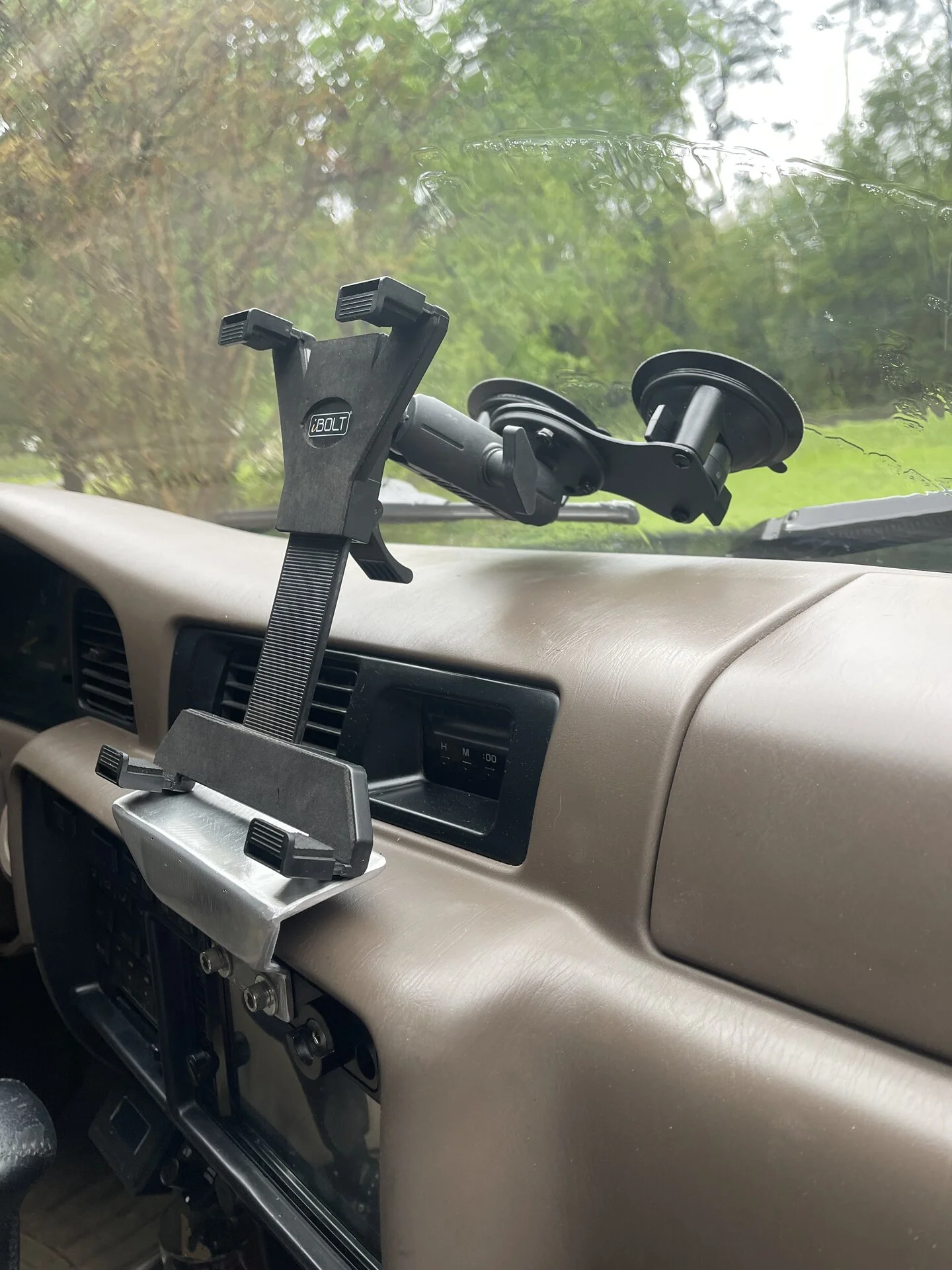

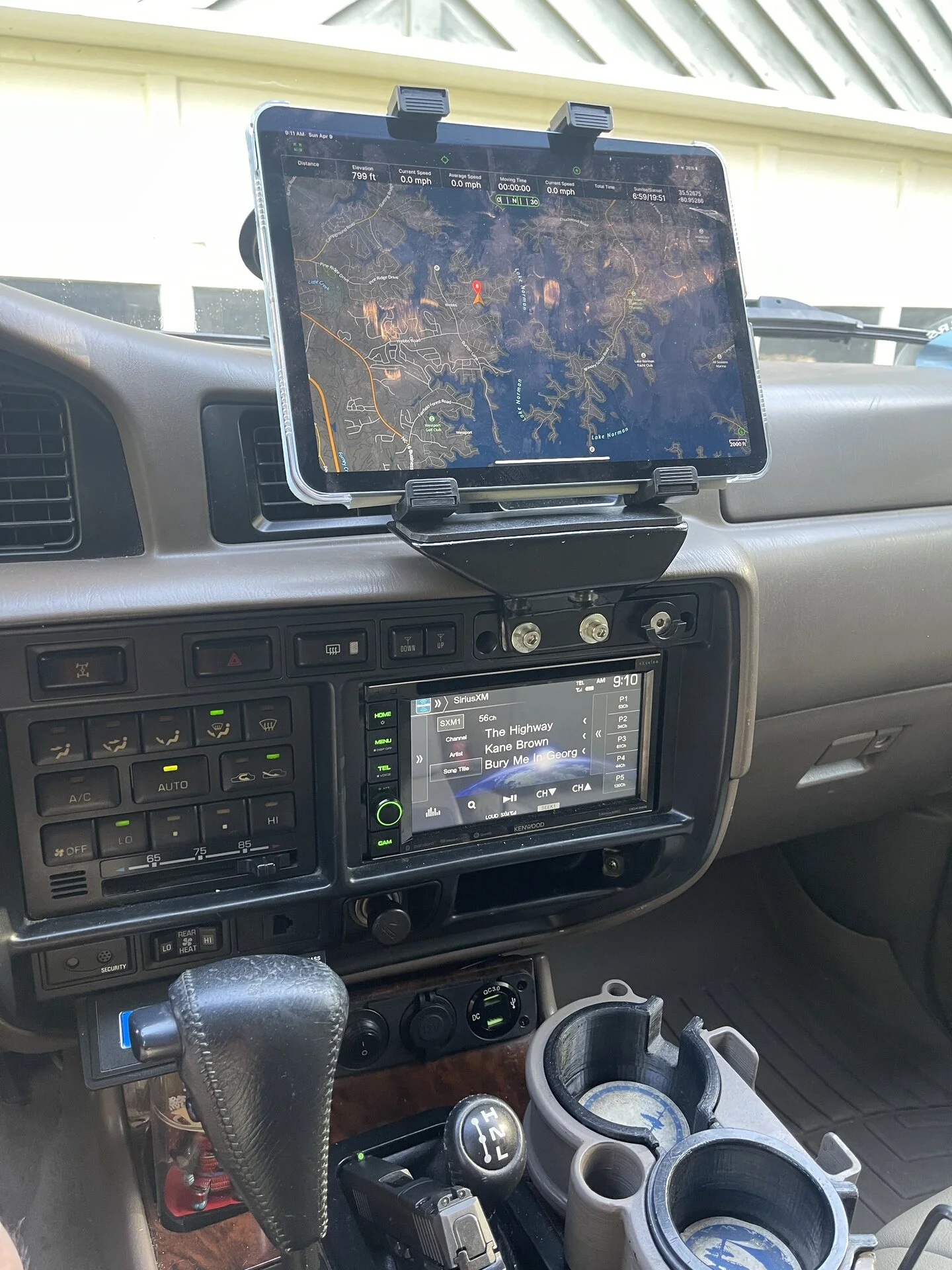

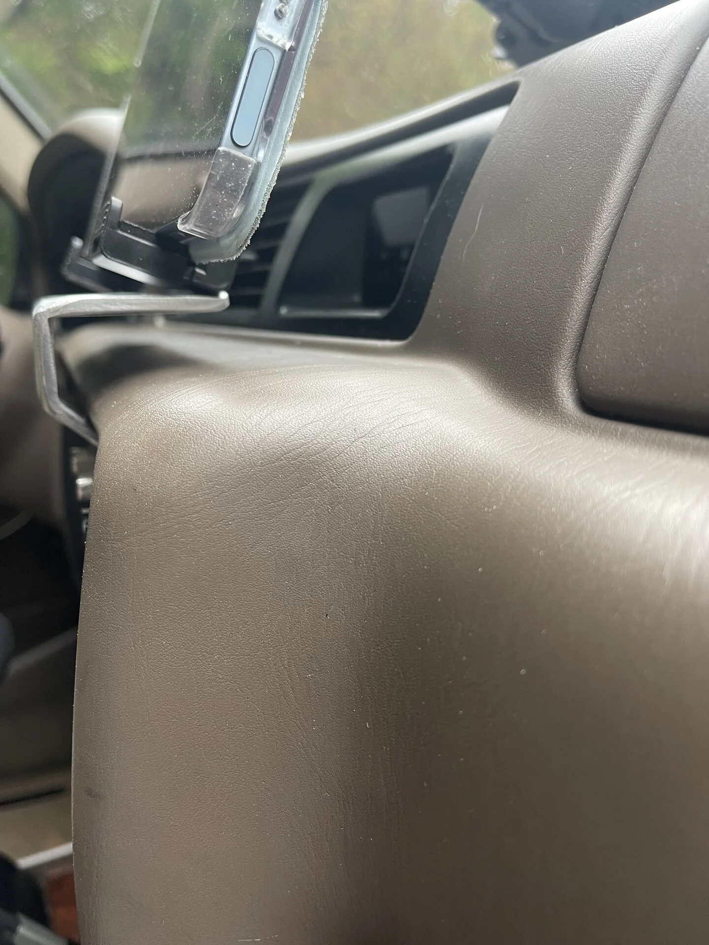

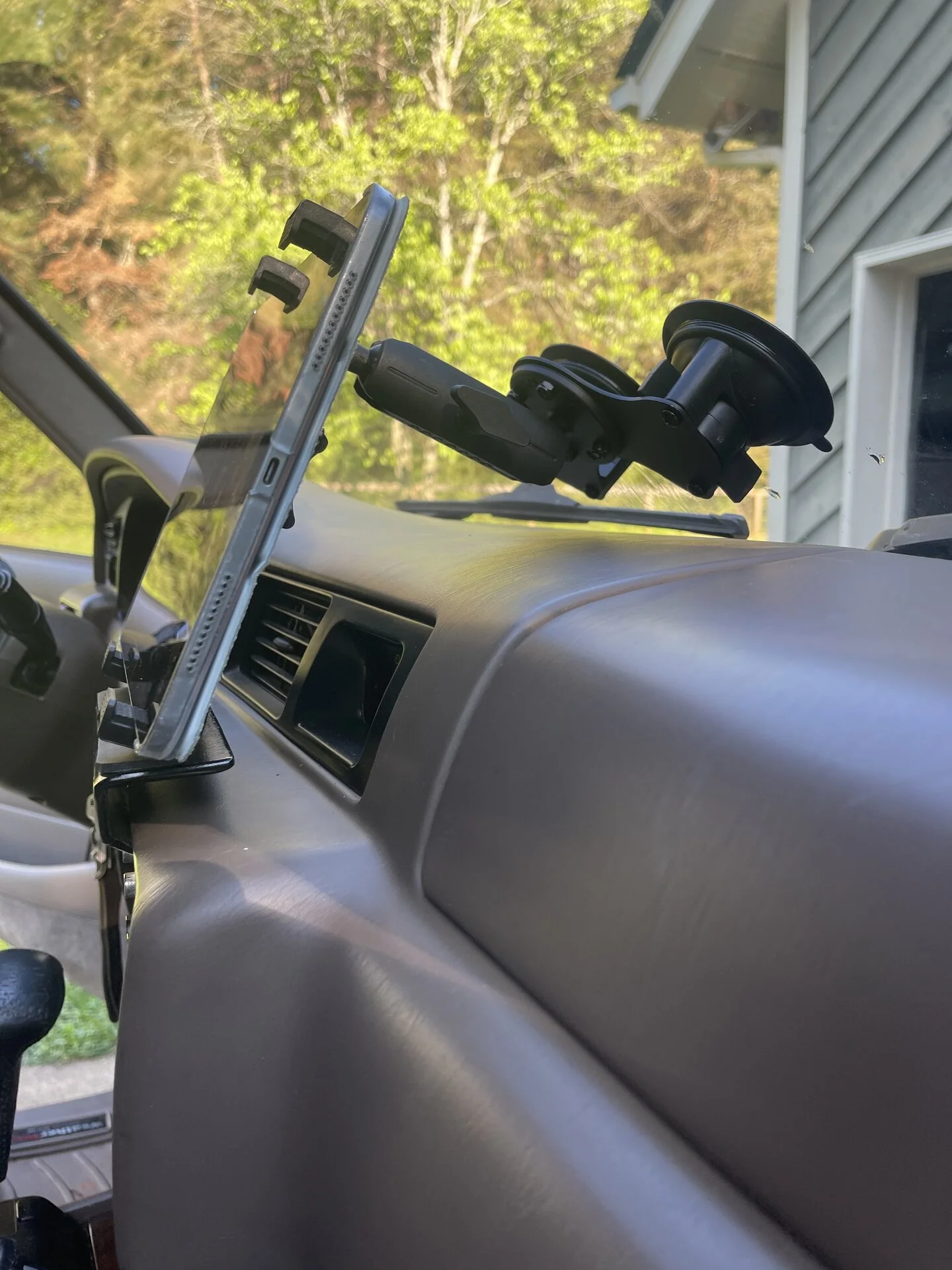

I don’t know if it bothers you guys as much as it does me, but I cannot stand my iPad that I use for navigation shaking constantly while driving on and off road. Previously, it was just mounted from the useless cubby attachment from wits end. So I went to a windshield mount, which works pretty good. But inevitably, it works its way down until it’s touching the dash and still shakes some. Since the dash is perfect we can’t have that going on because eventually it will rub marks onto it right? So I came up with this little solution goofing off in the garage. I actually like it pretty good and it is rocksolid. Right now I have a strip of rubber on top I may switch to Velcro to make it even better , these silly things like this make me happy. Lol. I’ll probably actually have one bent now that I have the dimensions that I want. I just welded and grind some plate aluminum to not this one out that I had laying around. Thought about extending it further for other accessories, maybe hit three bolt holes, and then running a power cord through a drilled hole in the useless cubby mount itself. We shall see.

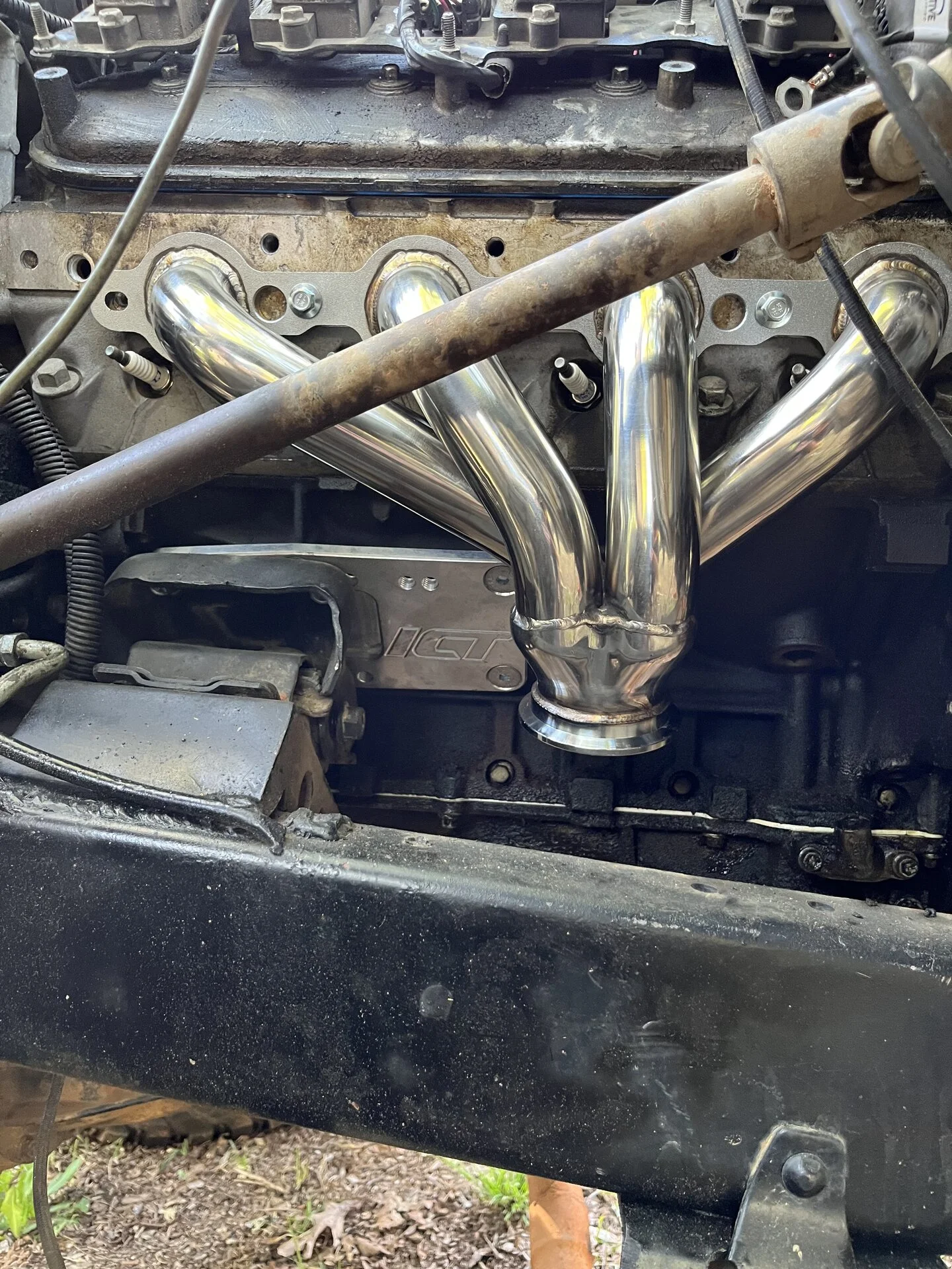

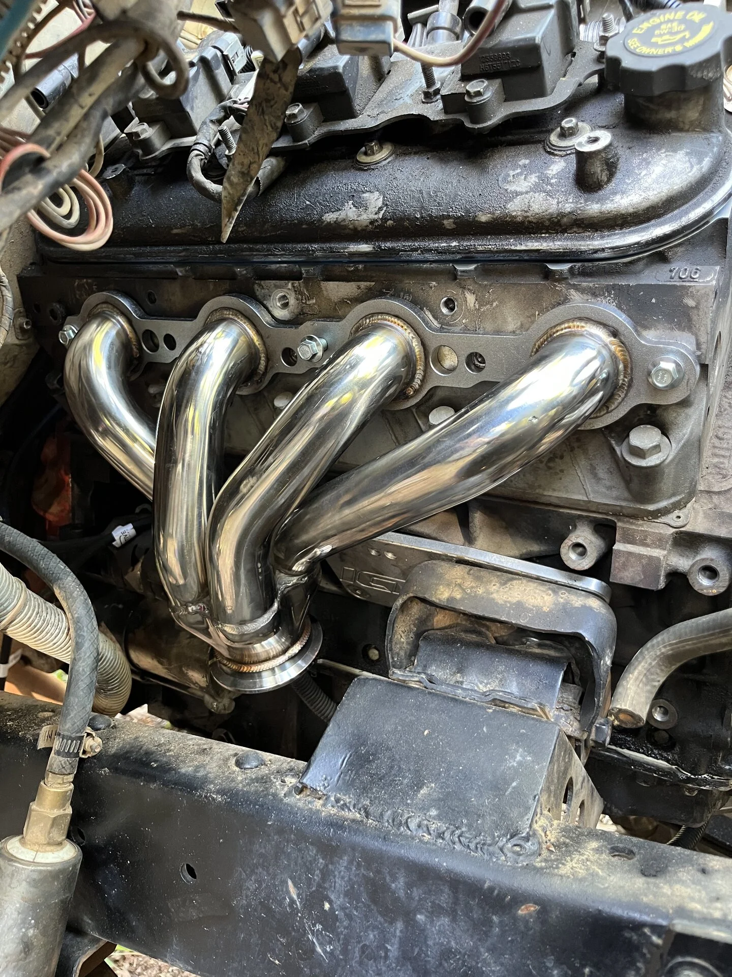

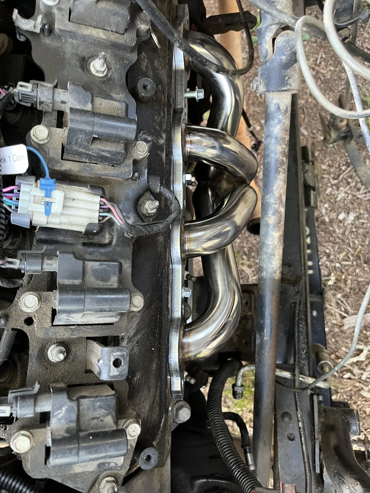

Got the headers on today and they fit great! Absolutely thrilled with the clearance. They clear the steering shaft with plenty of space and the frame rails are miles away. They are Speed Engineering Block Huggers for anyone curious. They were $190 and are actually shockingly good quality.

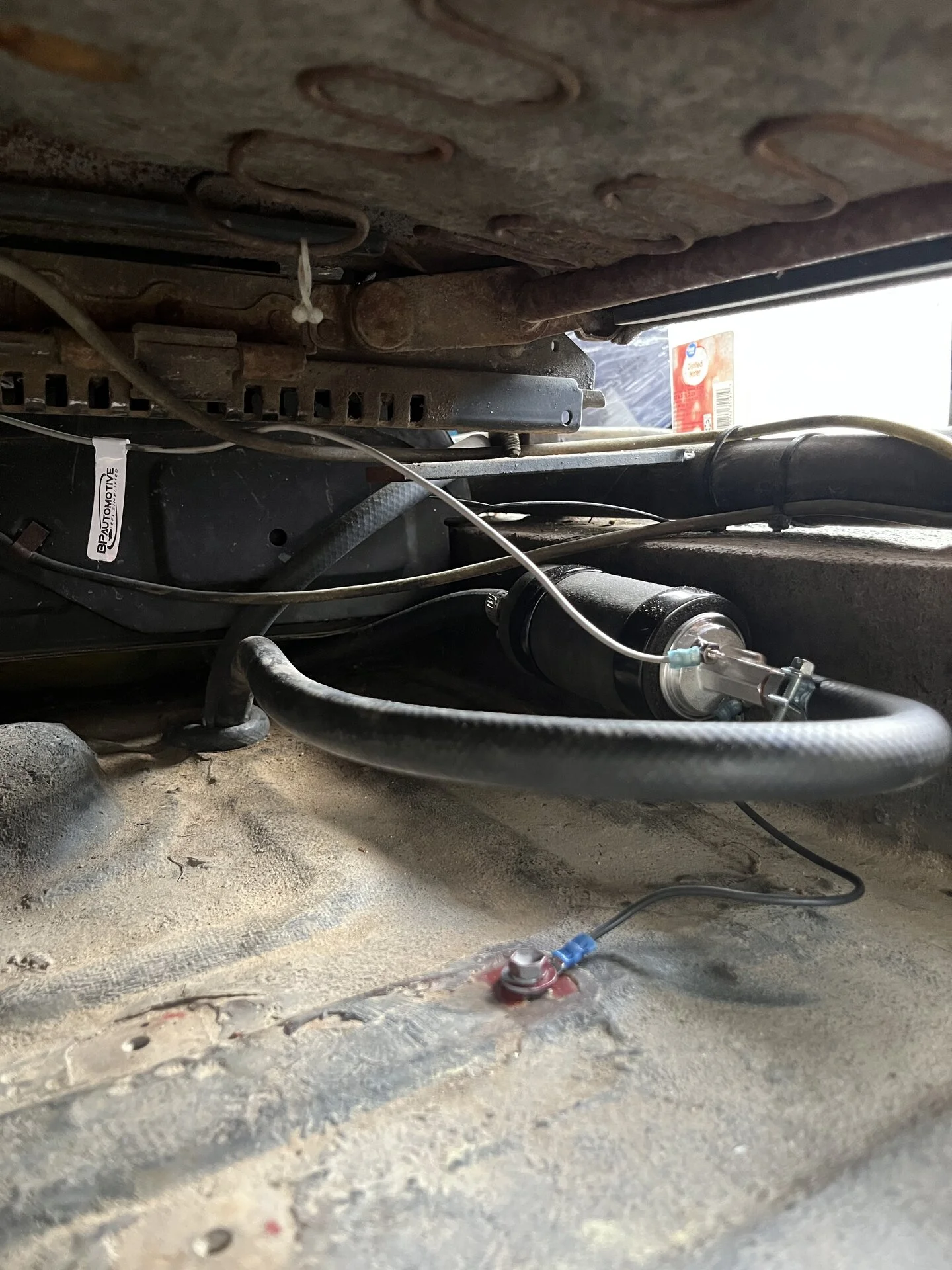

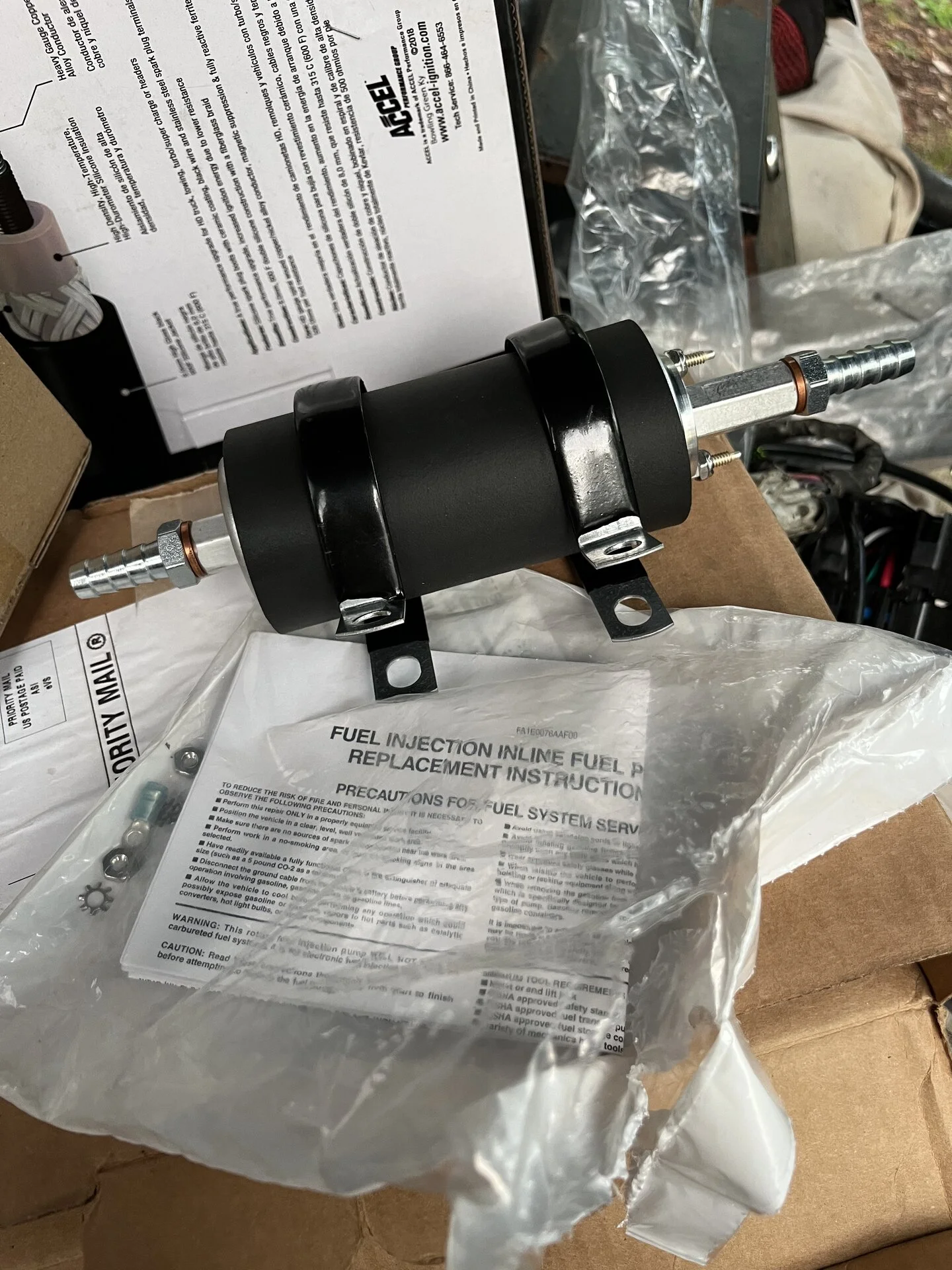

Finally got all my fuel system parts in the mail, fuel pump(Walbro 255, efi rated clamps, and efi 3/8” line.

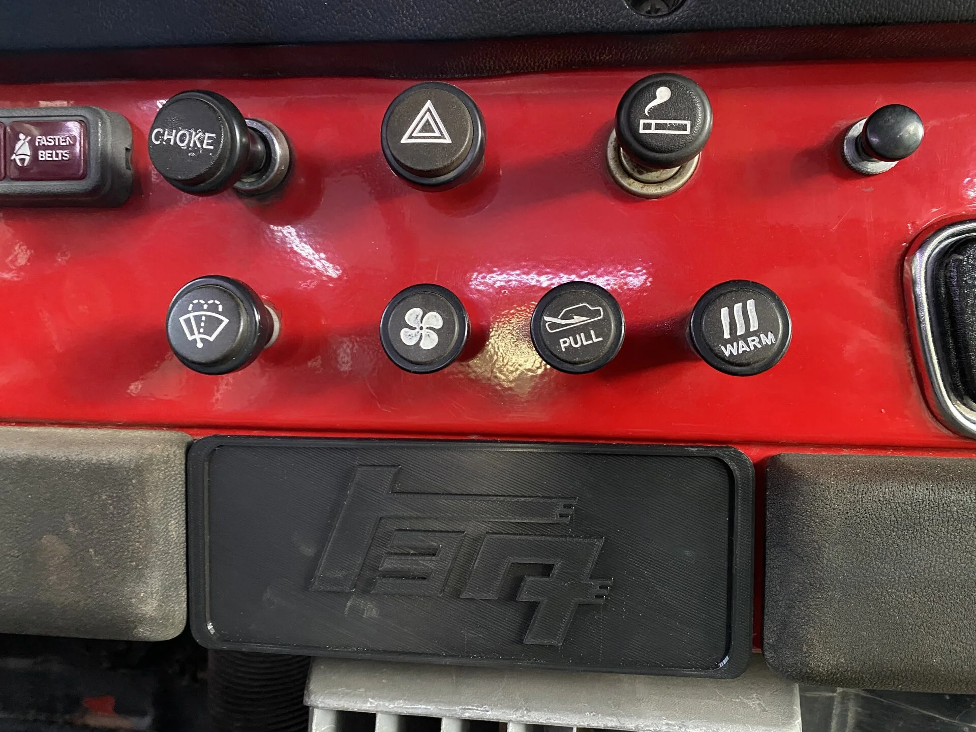

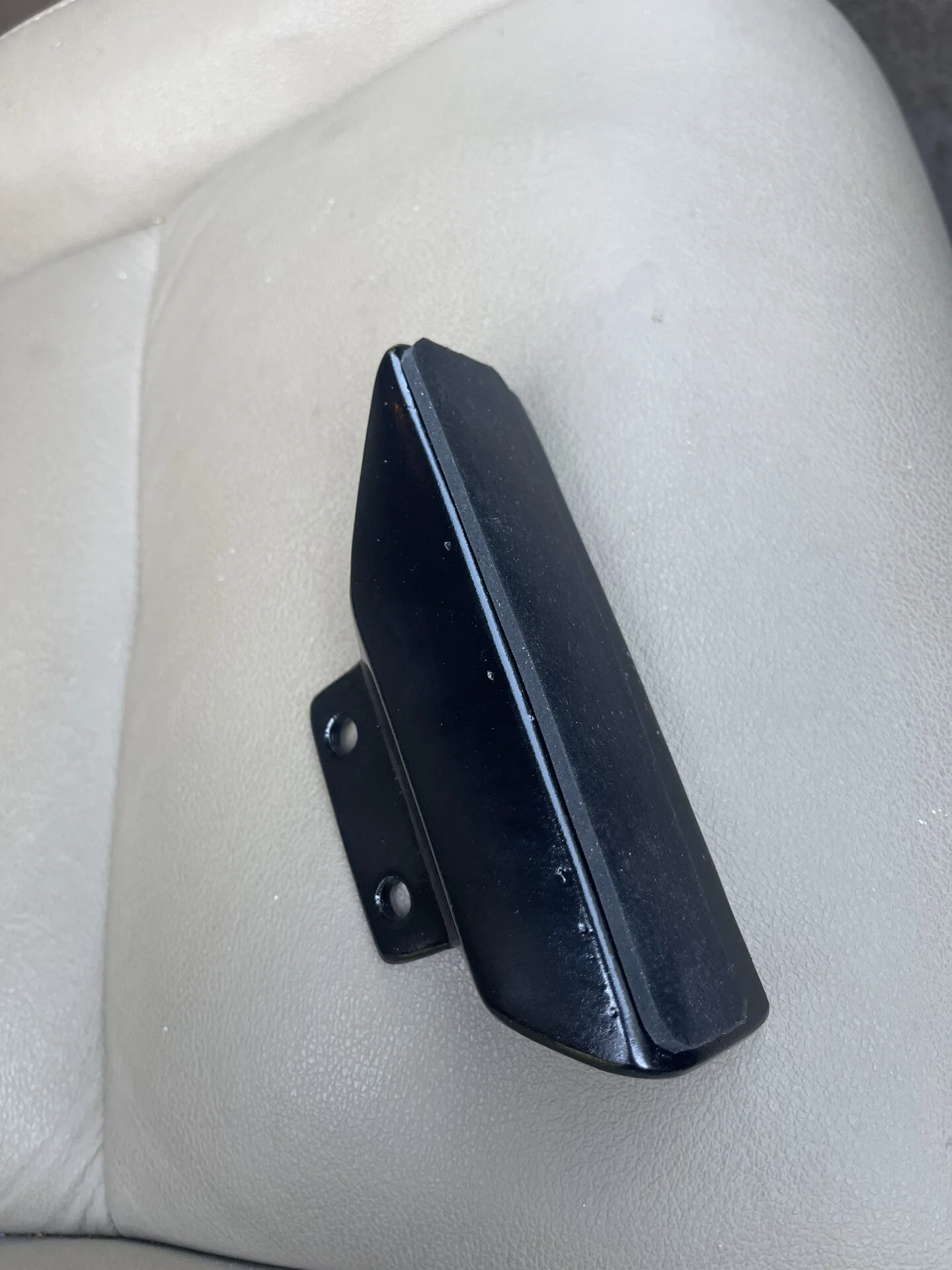

Had Luke 3D print a radio delete plate to cover up the massive hole that 16 y/o me created in the 90s to fit my long gone Crutchfield cassette / FM radio with the removal face (which someone promptly stole - the face only).

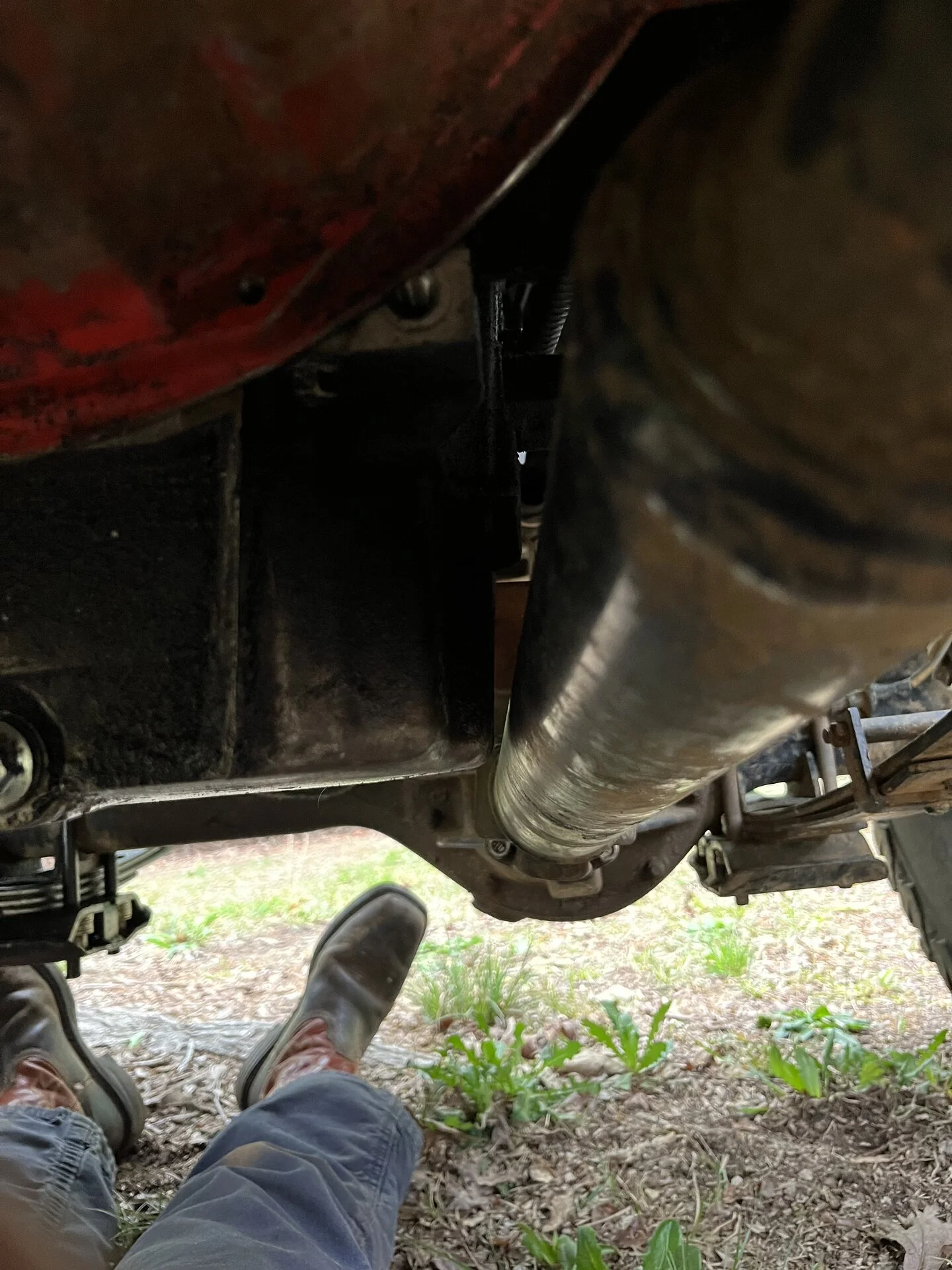

To get her wheeling I do have to make a new front driveshaft, gonna re tube it with a skinning shaft out of like a dodge Dakota. I have less than a pinky of clearance now between oil pan and driveshaft.

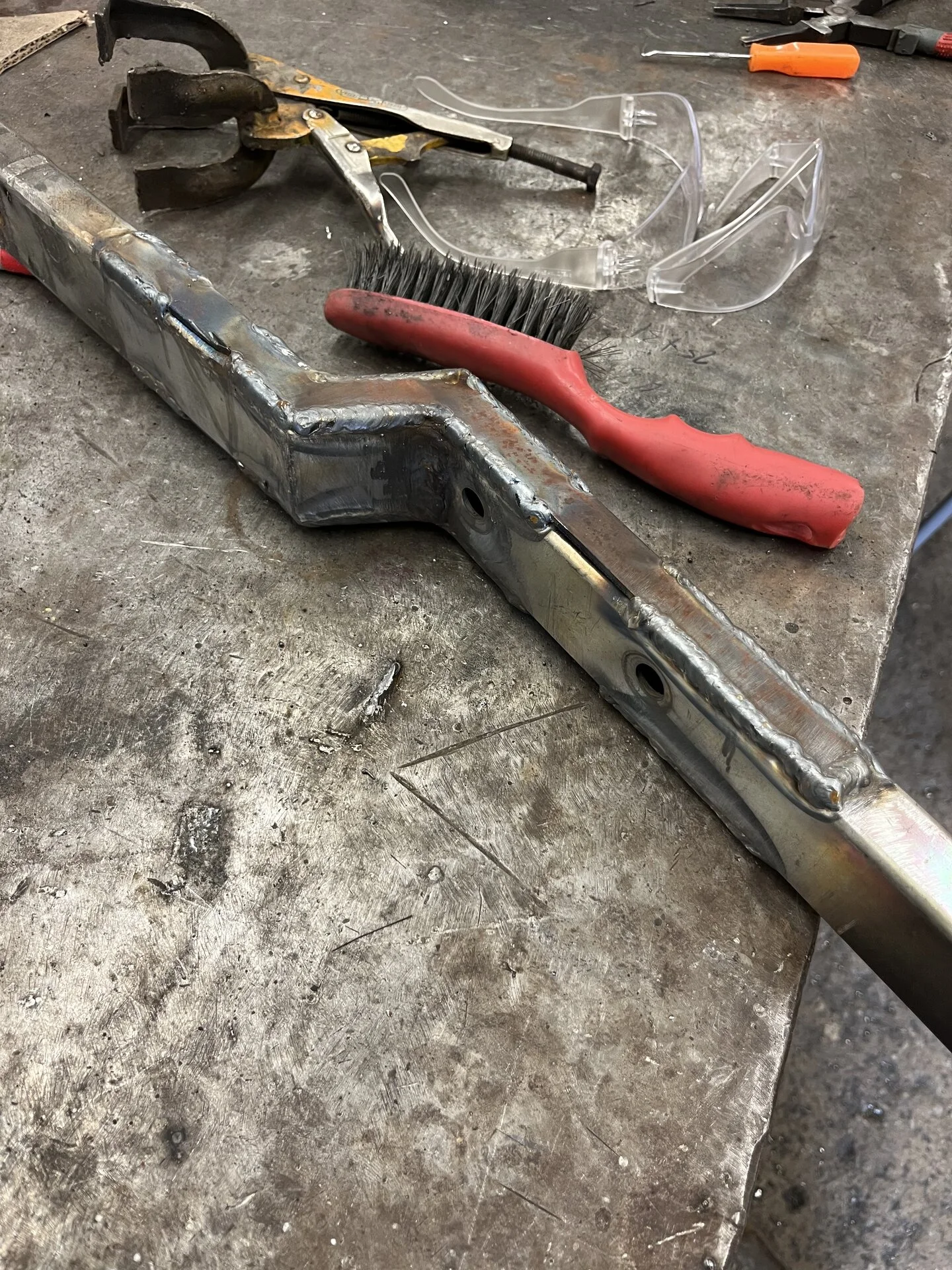

Also got the trans crossmember repaired and beefed up!
Is that electric fuel pump not annoyingly loud in the cabin? When I had one on my 2FE I mounted it to the frame rail and ran the feed hose through the floor (like stock). Now I have a Holley in-tank pump which isn't bad at all, but I can't imagine an external one whirring away right under me... but maybe that one is not as loud as I've experienced. Nice work - getting it done FAST!
What headers are these?
I want to replace my frame mounted electric fuel pump on my mini truck with a gas tank mounted fuel pump for exactly that reason. It’s loud.
In tank pump is the way to go
That's a far more cost-effective option to what I used:
It’s definitely gonna be a little noisy. But everything else on that 40 is so loud I think it’ll get drowned out! But I’ll move it if need be

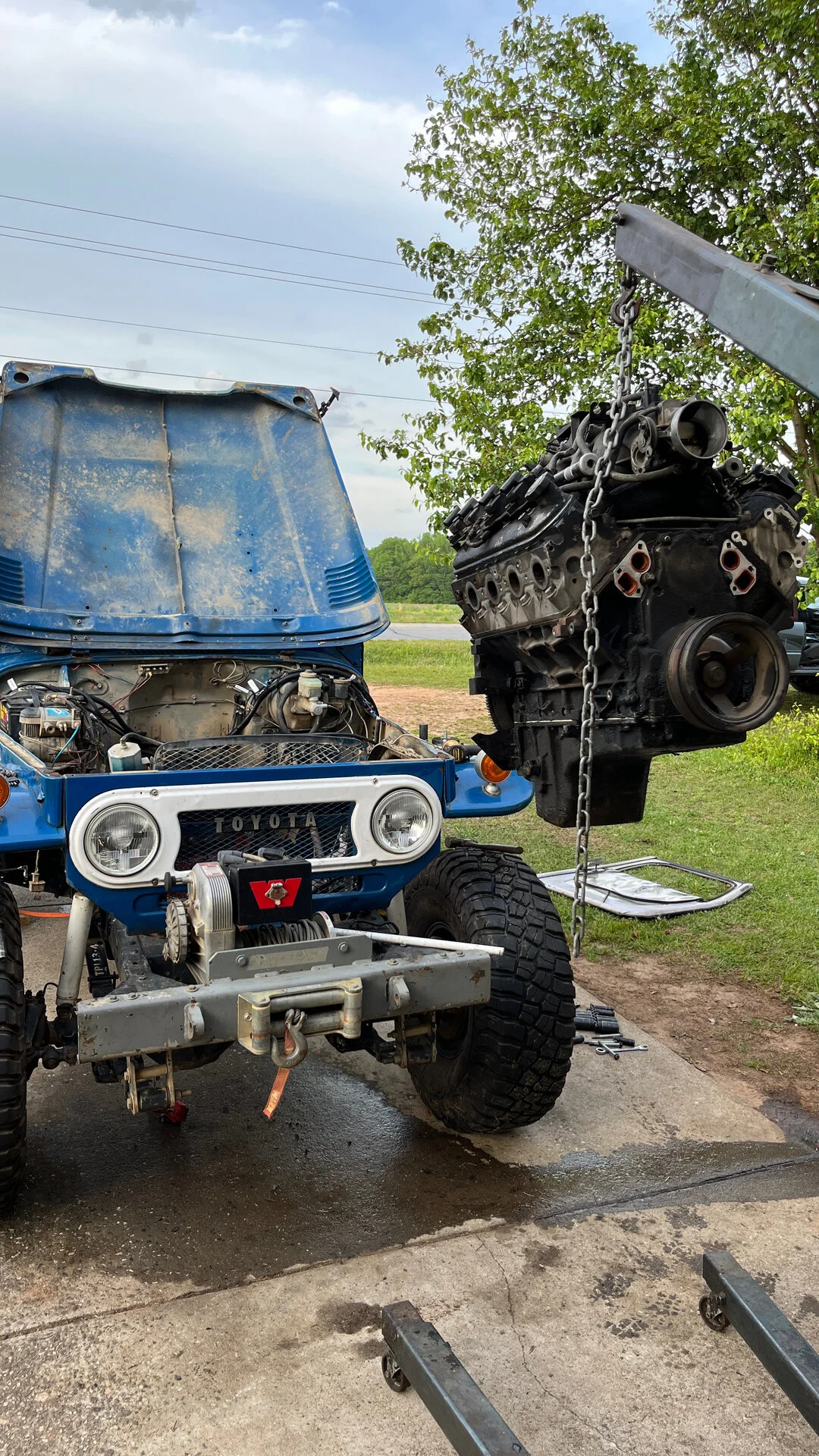

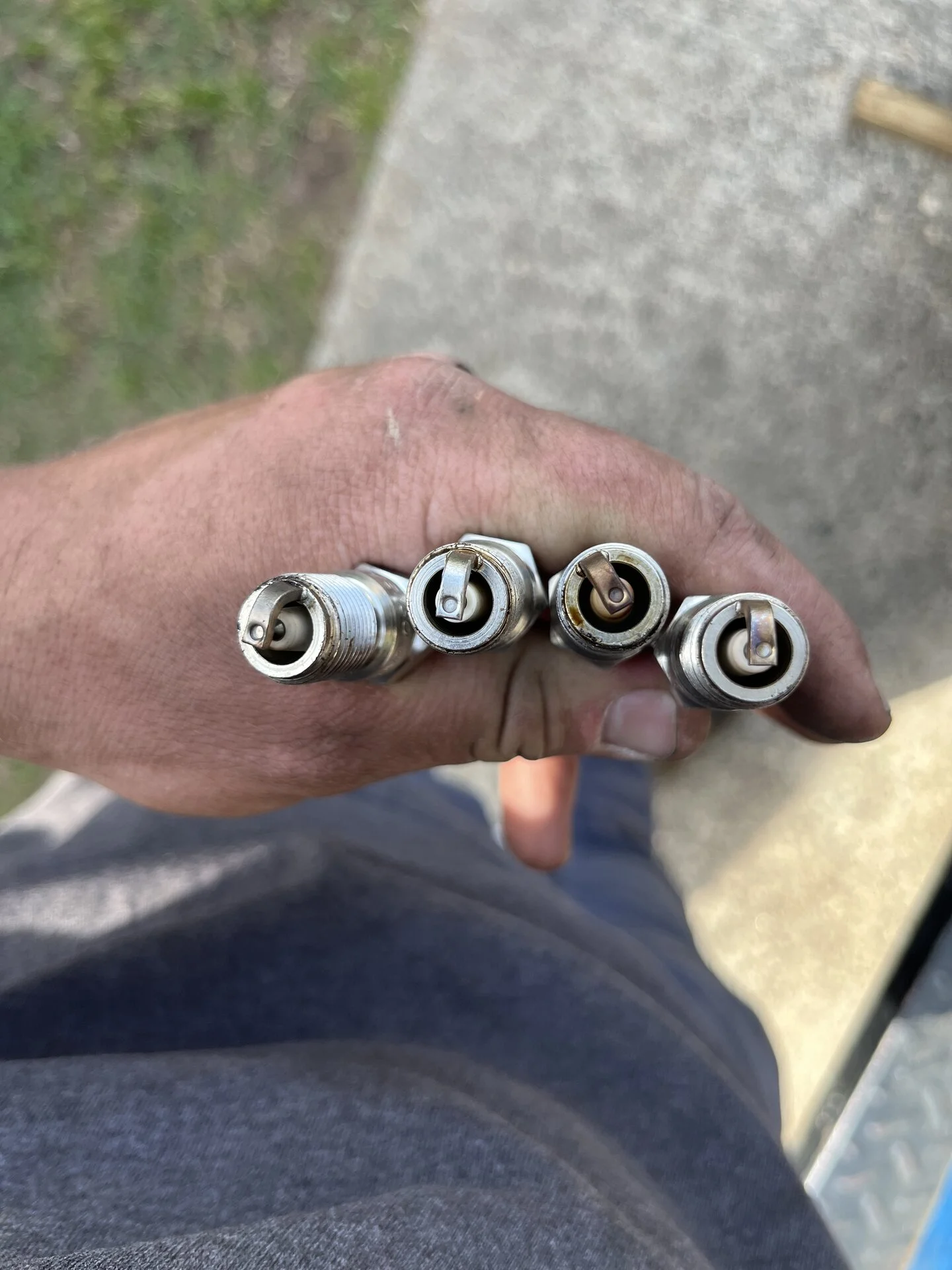

Well things took and unfortunate turn today. Had it running and even moved it around a little. But was chasing a misfire. Finally did a compression test and nothing on cylinder 6. It hasn’t been firing in a while. Valves and cylinder wall looked good so theory is wiped cam lobe. As annoying as it is I have 4 days left of my 30 day junkyard warranty so I’m taking it back tomorrow for my store credit! On the bright side I got it out by myself in an hour today. And I’ll get to clearance the firewall instead of letting the passenger cylinder head self clearance…lll
