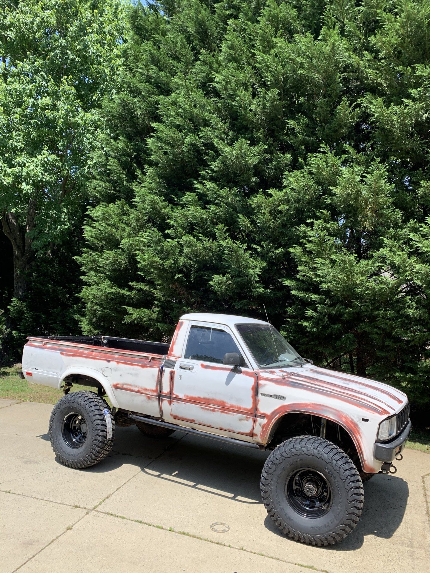

Got as hell outside but I like how it looks now. Also pulled my back somehow this weekend and it was a chore to move the new 35s around to install them but def worth it.

Damn that looks nice... those 35's look like 40's on that mini
ack - are they rusty? such a cool truck - couldn't you chop a rusty one? :) LOL
