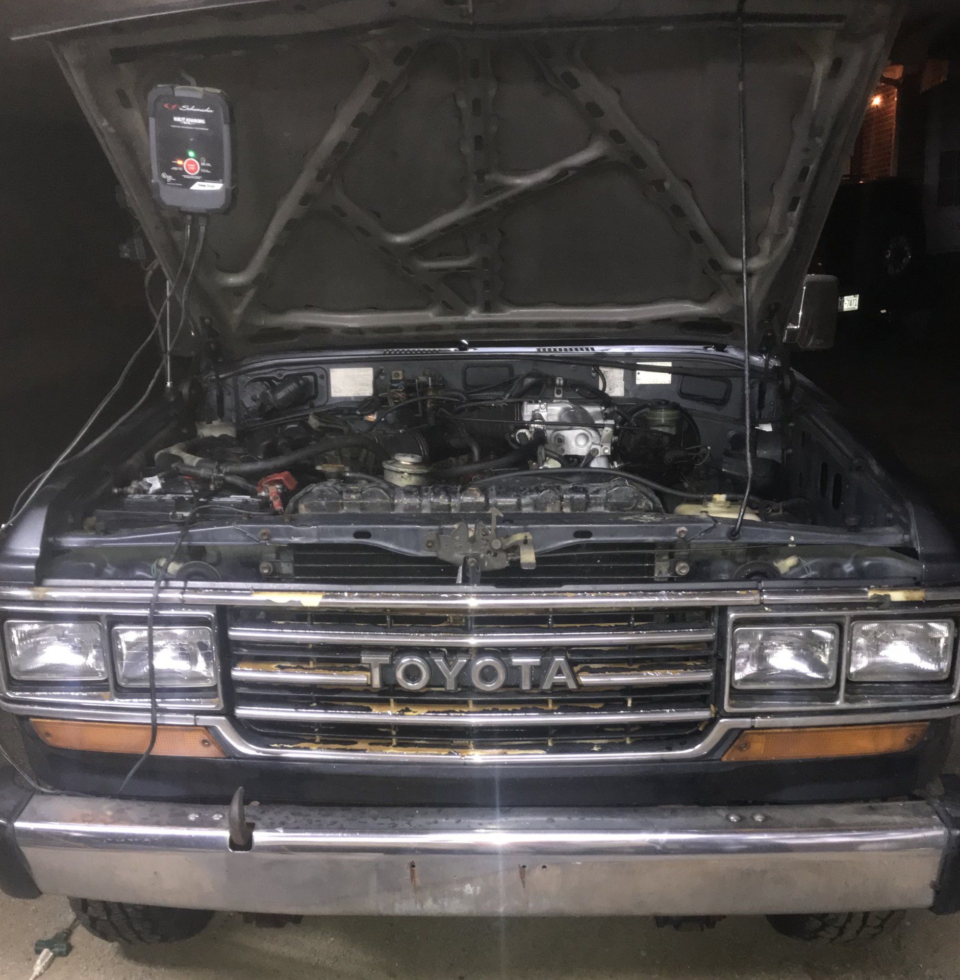

3FE guys. What causes one to run rich. Changing wires and plugs now.
Wrapped up the brakes today’s. Test drive revealed a faulty alternator. Picking up one in the morning but in the mean time I’d like to figure out why it’s “rolling coal”. It’s idling around 1k and blowing black smoke under acceleration. No smoke during idle. The truck has sat for over a decade from my understanding. Does it just need to be driven?
I did desmogging it but it’s idling the same as before.
Black smoke isn't necessarily "rich".
Fuel pressure regulator adjustment is something to consider. Dirty injectors possibly, etc. I'd run a bunch of seafoam through it then give it an italian tune up.

Check the free things first
Check for any stored codes, even if the CEL isnt currently on.
Check the TPS, specs should be in FSM
02 sensors.can be starting to go.... you can "clean" them by burning off carbon with a torch but they atent expensive if they need to be replaced.
Check vacuum lines
Check your fuel pressure at the rail.
Then start spending money if nothing there is a red flag.
Johnny's suggest is great to run seafoam through it.
3fe there are numerous things that could cause a rich condition.
What's the maintenance history in it?
I went through and tested the AFM it passed per FSM.
Regulator adjustment- that’s a good thought.
I’ll try the Seafoam also. Are you referring to the intake or fuel?

No stored codes.
Fuel Pressure is next on my list, then TPS, and confirm injectors working properly.
Maintenance history....:rofl:
definitely leaning towards a fuel issue. It’s running at idle like a cylinder is misfiring. Unplugged each spark plug wire and confirmed each has spark. Started the engine each time with a wire unplugged and the idle didn’t really change.
