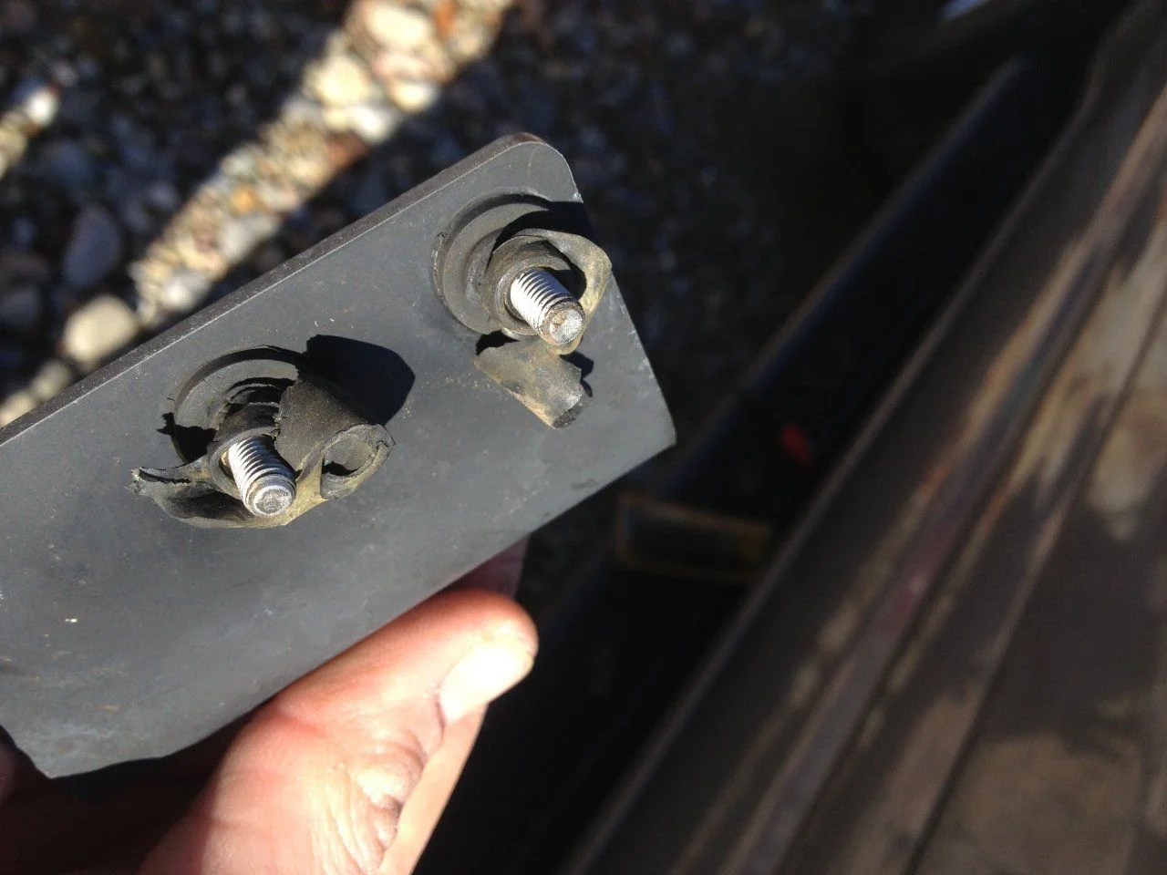

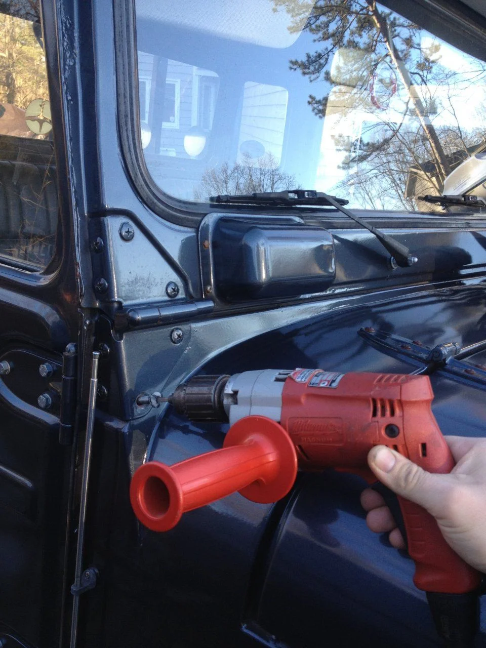

Continued the HAMOM spirit Sunday and R&R'd Alex's arb. He cleaned up some rust, moved his winch selenoid, cleaned up his DRL mod and I attacked some broken bolts in the frame since I was on broken Bolt duty already in my projects.

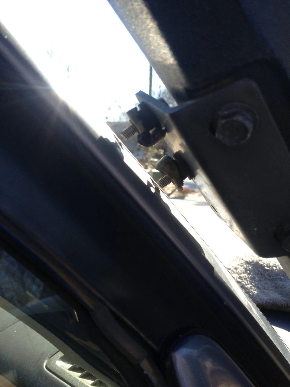

those included mounting the windshield hinge mirrors I got from brad at the HAMOM, thanks again man! First one took 20 min second 4 hours ha. It had a broken bolt that needed extracting and a captured nut missing for the set screw. First attempt with JB weld failed instantly n second attempt was welded but with poor penetration. Finally turned up the heat and got it set. But no the project couldn't end yet. Of course the last screw wouldnt budge and exploded with a impact driver and sledge. Out came the 1/2" drill and extractors again and finally had it mounted up. Hope the stay put better at highway speeds
And yup the mirror heads need to be spun 180

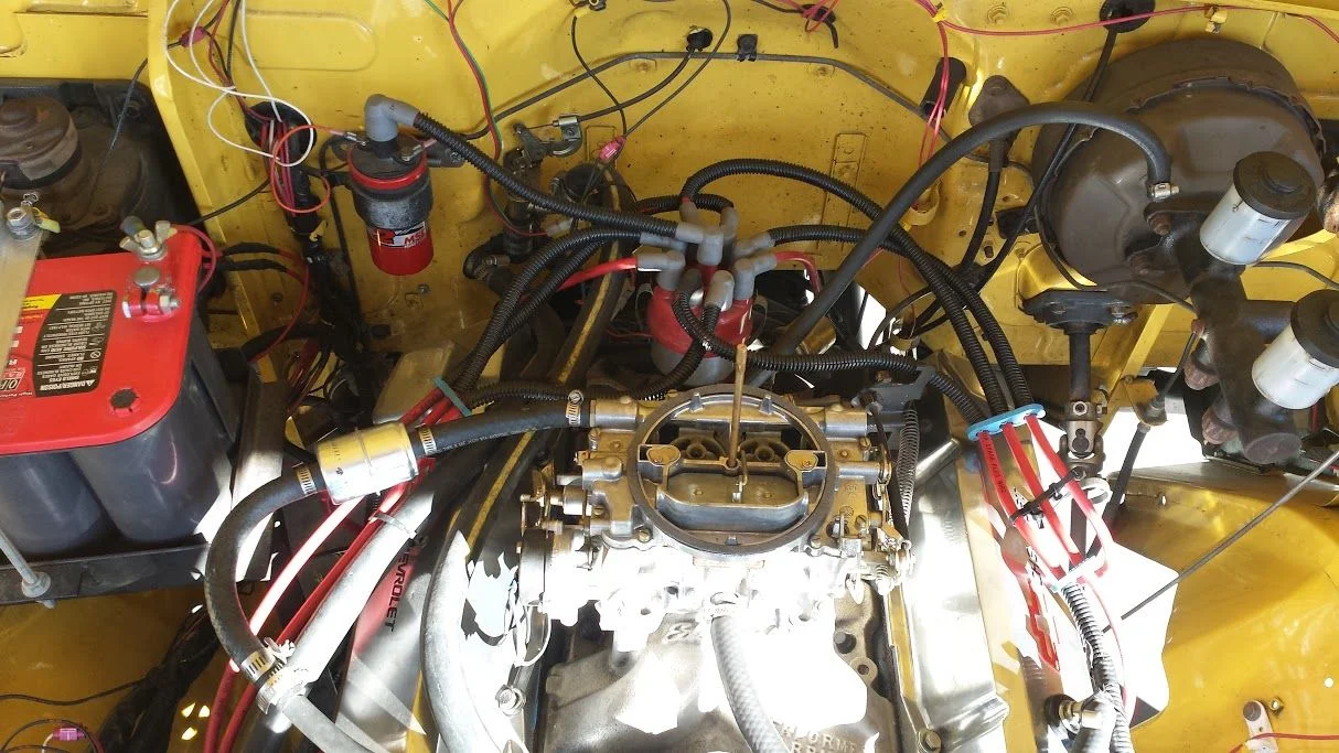

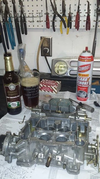

The carb on the 40 has been on for 10 years without a rebuild. Last Saturday, on the way to Brad's HAMOM, she stumbled a little so I knew it was time. Jason had no idea the history of his 750, err 650, uhh, I mean 570 so it came in for a refurb too.
Disassembly and cleaning ...
Jason giving the ole carb cleaner into the eye squint.

Jason finished product. Still waiting for install and test drive report. The bling fuel log is reported to add 10 horses and 15 ft Lb of torque. :hillbilly:
No road test yet but initial firing sounded like it should ...

carb install and test drive report.....
WOW That about sums it up. Who knew the old carb was so out of tune. I did notice the rear bowl had been leaking upon removal. So much more driveable and beyond pleased with the improvements. Will be even more stoked if there is more to gain from tuning. Many thanks again to @Rice for the assistance to the newb and for capturing the carb cleaner moment.
