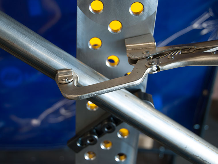

Johnny don't use threaded fixtures in the table.. Spatter, dirt, etc.. will clog them up..
Just drill a hole and then either buy something like this
These are easy to make, just cut an arm off a vise grip or c-clamp and weld a piece of round bar stock to it. I recommend a minimum of 1/2" stock.

Peg systems are stronger and more precise IMO.. you can really get the clamp where ever it needs to be instead of moving the piece where the slide tracks are. Sliding has its benefits as long as the workpiece lies in its paths..
You can also use the peg system as a mock up and dimensioning table. Roll bends up or down, etc... Pull the workpiece UP off the table with the help of peg stanchions.
