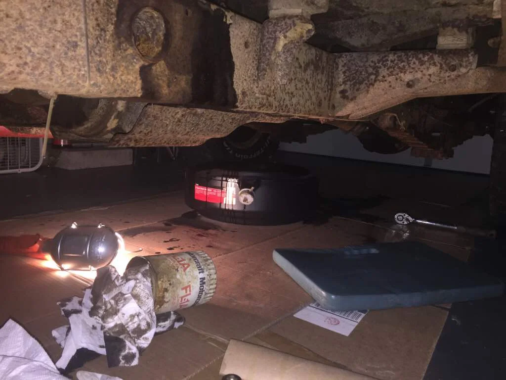

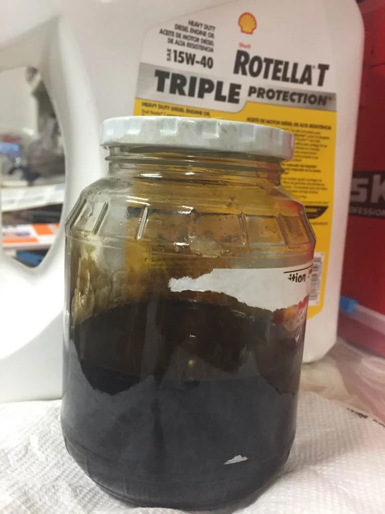

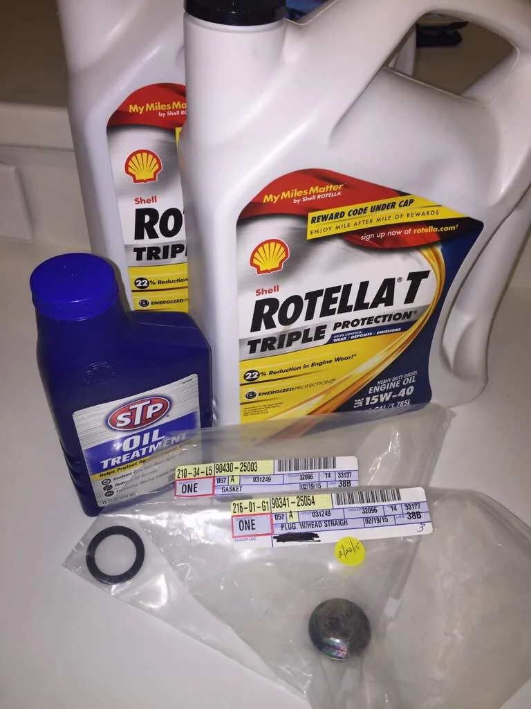

Finally got my oil drain plug unseized with some persuasion from the Orange hammer, some vice grips, and some pb.
I quickly got a new plug and gasket from mr T and got to work.
The oil that came out was black as I expected... I've had the truck since August and it sat after and before I bought it for quite a while, and I've been running marvel mystery oil for a few months.
2 gallons of shell rotella plus some STP oil treatment(zddp), a Napa gold 1515 oil filter, new plug and gasket
Quite a stress relief to know my tractor engine is well protected for a while.
Btw that STP oil treatment came out like jelly, really thick... Quite strange.

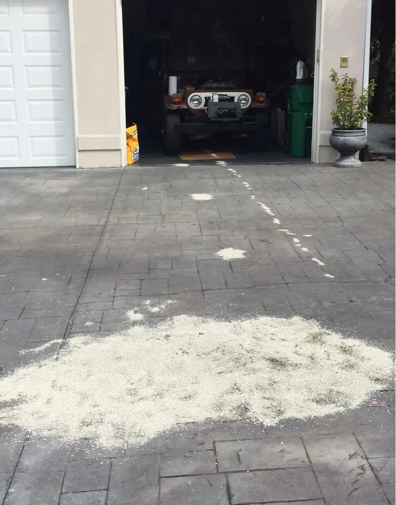

Experienced an epic fail after my first oil change on the forty Friday night...
My day yesterday was spent fixing a huge mess caused by me not noticing the old oil filter gasket didn't come out when I removed the filter.
Checked for drips Saturday morning, none, I felt good. Turned on truck to warm it up, went inside for fifteen mins... Came back outside to a real mess... My personal Exxon Valdez moment... Too bad I had only one roll of paper towels and no kitty litter on hand... Harris Teeter run.
Yikes. Even the easy stuff can end up being a big deal, everything is a learning experience.

The trail of shame... Luckily all contained to my property.

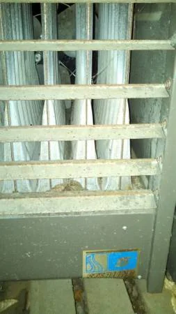

Hanging heater on CL for $100. The one I had in my 30x60x12 shop was 150,000 BTU and was LP but one of these hanging guys should do the trick. If using a reddy heater I'm be careful to keep a CO detector handy.
http://greensboro.craigslist.org/for/4889812248.html
If I still had the shop my next move was to install an outdoor wood burner.

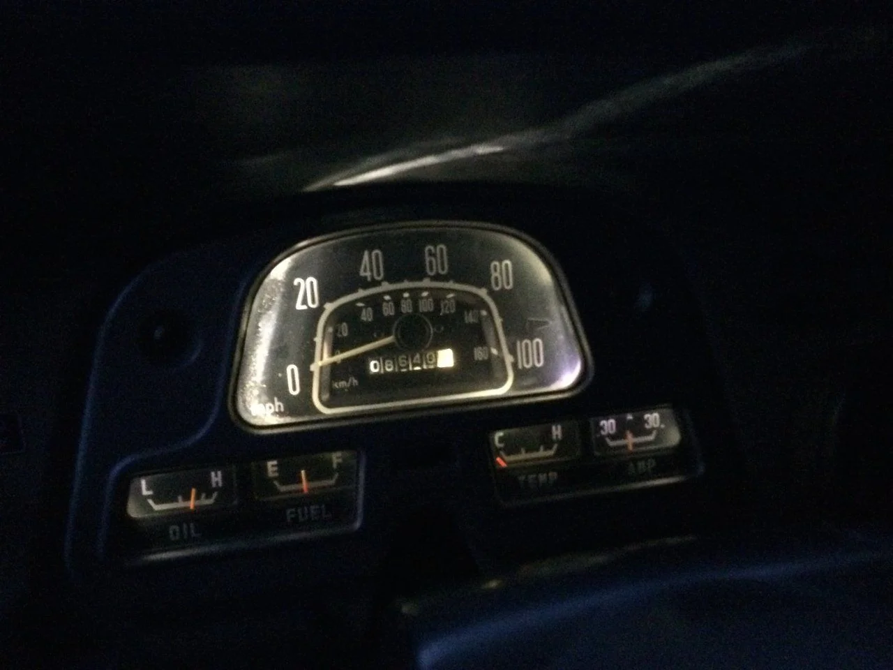

Short little project I think others may like... replaced the cluster lights with LEDs and removed the "shields". Can actually read the gauges now:
