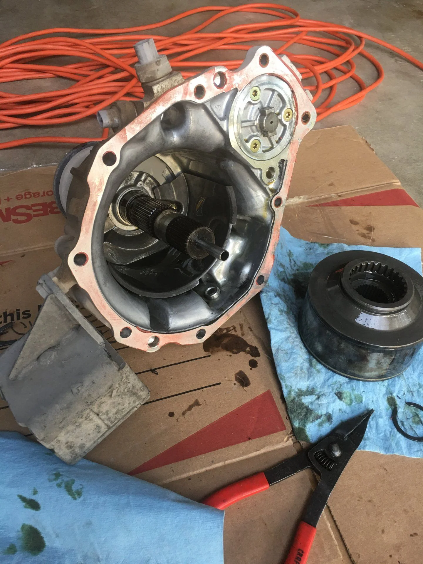

Half way through the appendectomy; quick question what is the on the bottom left of the picture. Looks like a mount of some sort but it doesn't connect to anything. Mounts to TC cover with 2 bolts, do I need it? Patient is a 97, thanks guys
@77mustard40
Going from memory, as I understand it that is a vibration/resonance damper of some sort. It may have been added later in the production/installation of these trans in our 80s too but I may have made that up ;)
I agree with this. My 97 LX450 had one, which I removed long ago, only because it was in the way of something else I cared more about.
I never was able to detect a difference.
Just based on physical principles - it is a tuned resonant damper - I speculate that the factory engineers detected an acoustic vibration peak in their product characterization data, so they added that gadget to reduce said vibration peak below some specified maximum quality level. It is supposed to oscillate at that frequency, but out of phase by 180 degrees, while the rubber flexing absorbs the energy.
it's correct operation would depend on 2 things: 1) it's mass, and 2) the rubber's resilience. So - I wonder if the rubber is now too stiff from age and heat to still work the way it originally did.
FYI - there is yet another such gadget attached to the rear exhaust mount at the so-called "resonator". Same principle, and same doubts about it still working.
