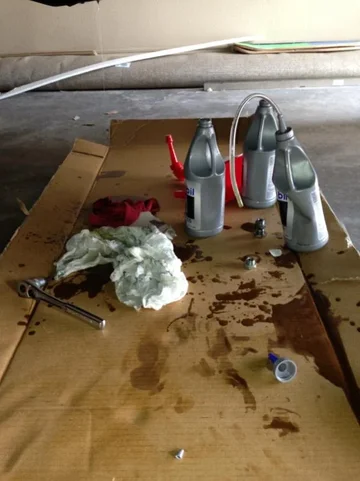

17. Fill with gear oil. You will have to use your intelligence here, as it is not so easy to fit a bottle over that hole. Use a special syringe or some other method. Feel free to experiment.
I guess I lack intelligence, but hopefully the gear oil seeping into my eyes sockets and penetrating the brain cavity will help lubricate the thinker.
I'm finding almost 3qts to be required, but I swear Robbie told me it'd only add a 1/2qt.
Anyone confirm the fill requirement with VC removed?
