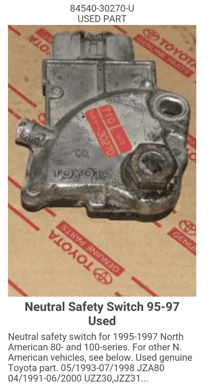

The neutral switch has two switches related to starting in it, one for park (gets the most wear) and one for neutral. If it fails in park, but starts every time in neutral, that is an indicator of neutral safety switch problems. Could be a bad switch or connection or linkage/switch adjustment.
This little guy, Eh? Hmmm...
Those are pretty durable, most often it's something else. Like some one jacked up the system by putting in a body lift and didn't properly adjusting the shift linkage, so it doesn't go fully into park.

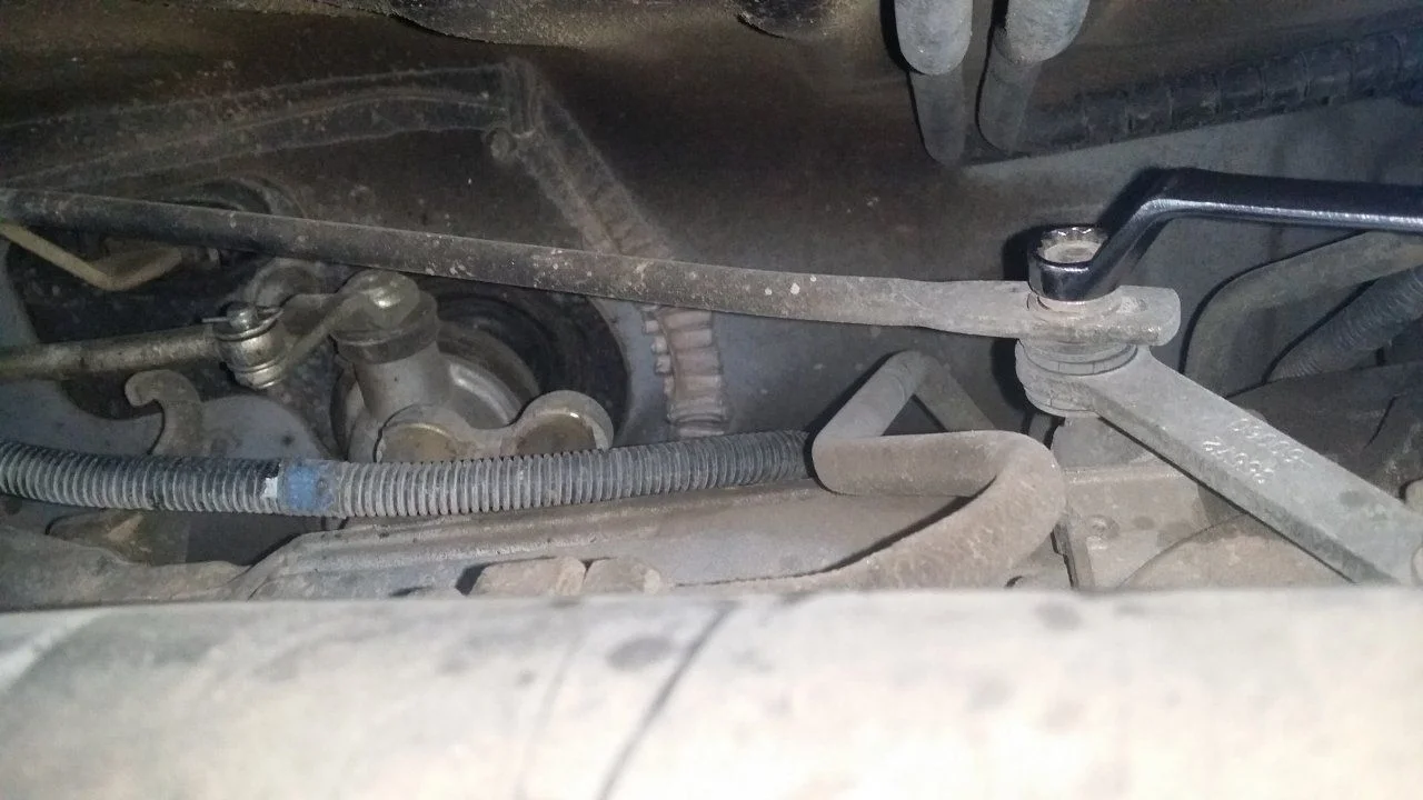

Tools, your on it like allways... that is exactly it. I put a 1" body lift in & have to very slight push forward on the shifter to get the key out. Need help, how do adjust this or is it to late?

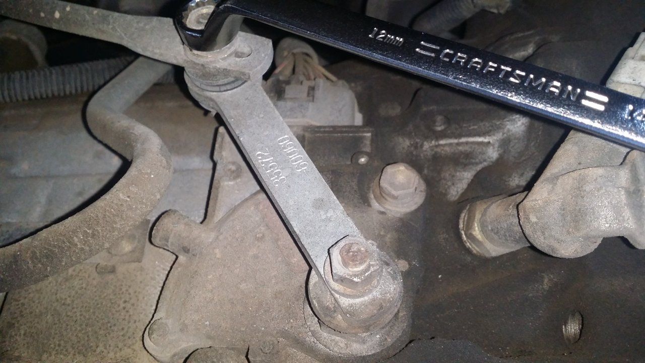

Thank you @Tools R Us I just got home. It literally took 5 minutes to adjust the likage. Here are some pics... hope this helps the next guy who does a body lift.
I'm such a :banana: .
:bang::bang::bang:
View attachment 1184031 View attachment 1184033

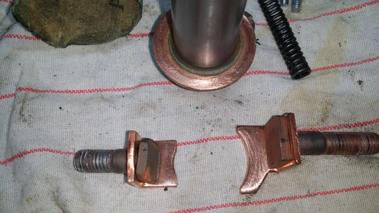

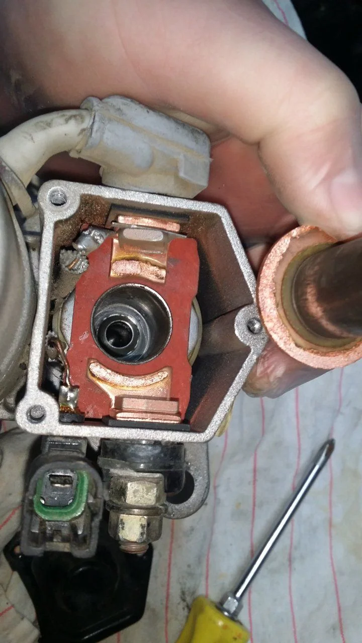

I took the starter out & cleaned up the not so bad contacts.
Before
After

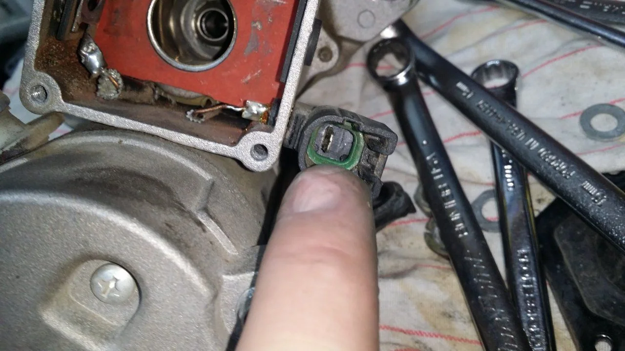

I'm moments away from installing it back in the Lx.... As far as jumper wire I'm no 100% sure what you are saying.
Do I need to directly put a wire to here?
Yes, splice a jumper wire onto the remote wire that plugs into that connector (I used a heat shrink butt splice like this)
Run the jumper wire up to the battery, but don't connect it (I keep mine coiled up at the relay box with a rubber cap on the end)
The next time you have an issue with starting, check the output of the jumper lead with volt meter.
If the voltage is low or none at all, you know the problem lies in the starting circuit (either the ignition switch or P/N safety switch)
Best of all, you'll be able to bypass them both by touching it to the positive terminal on the battery to get you started :cool:
