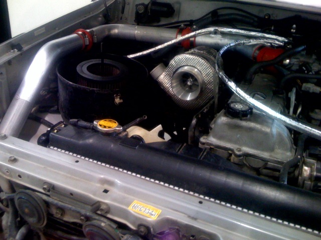

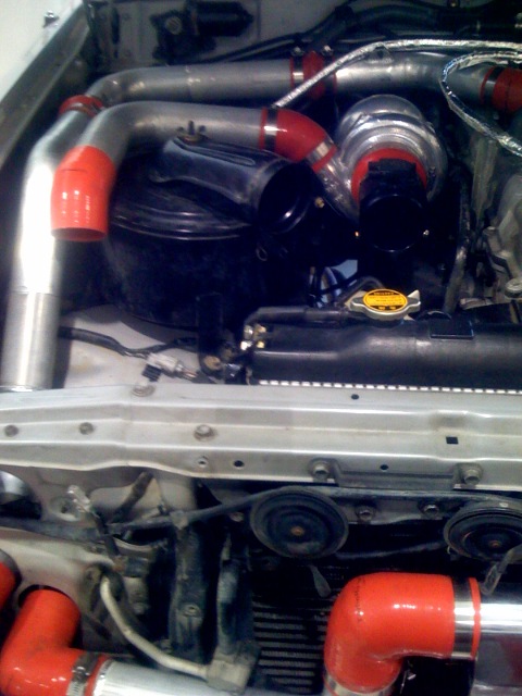

The MAF will not be mounted like that. Does anyone have pictures of the turbo-Air cleaner plumbing. I will also use a BOV.

Landtank, that is your maf in the picture.
Mike
check both build threads by Dusty and MSGGrunt. It's tight quarters with that manifold and plumbing the intake from the filter to the turbo.
Dusty started off with a home built manifold and later on used one like yours so that plumbing is near the end of the thread.
Beware. in my experience using the oe filter runs hotter than the k&N did. i need to shield the oe box as it sist so close to the turbo

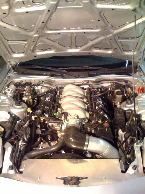

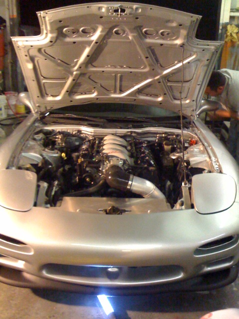

I need to get this truck done this week so I can finish my ls3 RX7. I only have exhaust left on the rx7.
Holy Massive Intake batman!!!!!!!!!! What kind of numbers do you expect that puppy to push out?!
