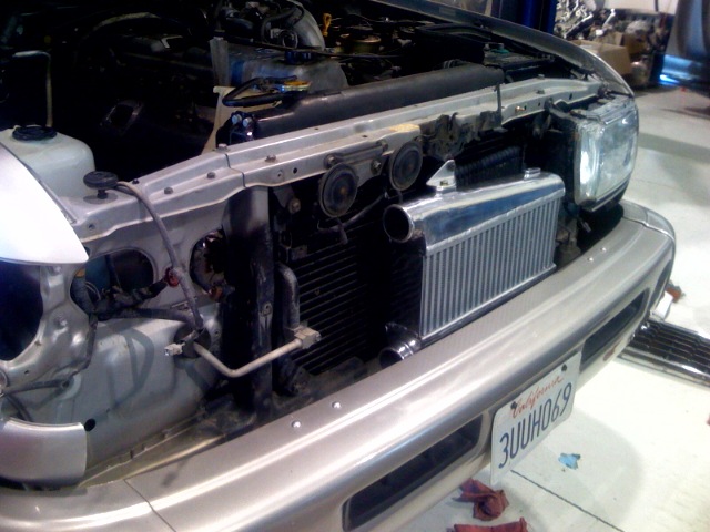

Today my turbo project started.
I am going to use gt35 turbo
turbonetics manifold
Tial WG
Ebay intercooler
Factory trans cooler moved for intercooler
Yup, you are in for some fun. I used the same style intercooler and replaced the factory cooler to make room for it.
Nice, but if I were you I'd rebuild 1FZ first then after you can add more power to it.
Replace those old plastic radiator.
The motor is new with a new head gasket, The radiator is new also. I will post more pics soon.

I'd think about protecting your hoses where they pass through the front grill. Either friction tape around the hoses themselves or some edge molding around the raw edge of those holes. Just my two cents. BTW that is where I routed my plumbing too and it has worked out for me. Best of luck. Looks good.
Thanks guys, I have been looking at all of the pics of everyone that has done the swap before. It makes the job alot easier. I should have it on the road next week. I am also putting on a WB02 to make sure everything is ok. I am also using landtank's MAF.
Mike
Awesome! I'll definitely do some watching with this thread! BTW, to echo the comments from MSG, put some edge molding around all those pass throughs there or you will saw some serious scratches into the hoses. :cheers:
