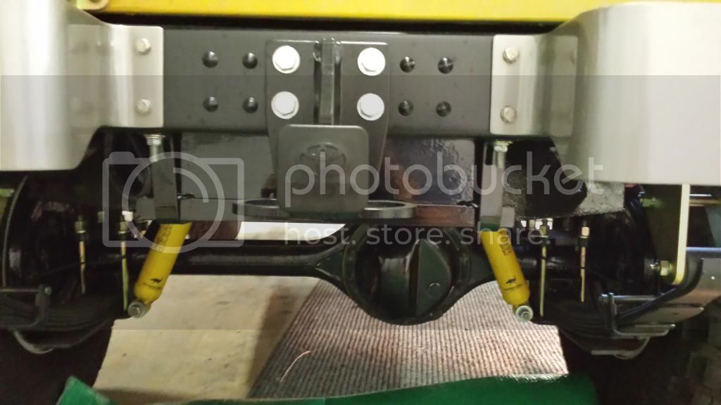

Worked some more on the truck last night. It seems like the accessory belt for the a/c and alternator has some abnormal wear because it is leaving rubber dust in the engine compartment after extended driving. Tucker drove it to atlanta a few weekends ago 300 odd miles and it showed a good bit of wear after that trip as well as the trip to florida. By the eyeball test everything looks like it is inline so i removed the belt and took a laser pointer and layed it in one of the pulleys and shot it across to the other pulley. i concluded the a/c compressor needed moved about 3/8 of an inch to the rear. I shimmed the compressor so hopefully that issue is resolved.

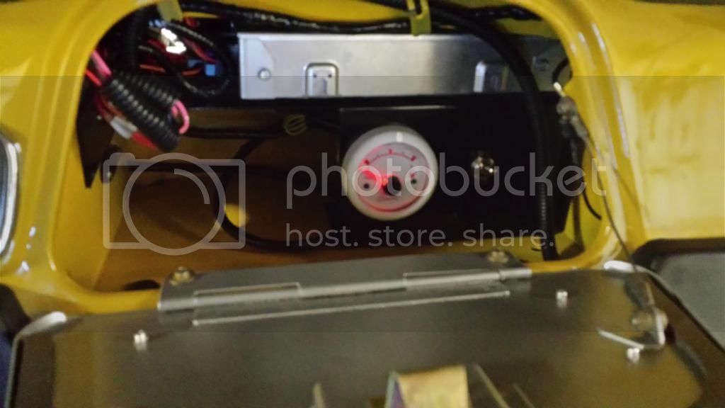

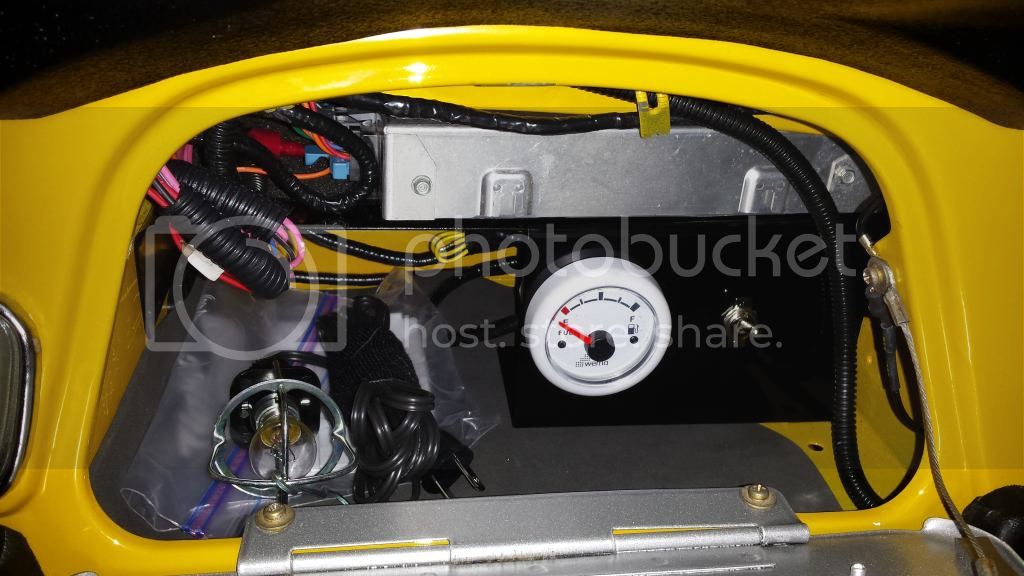

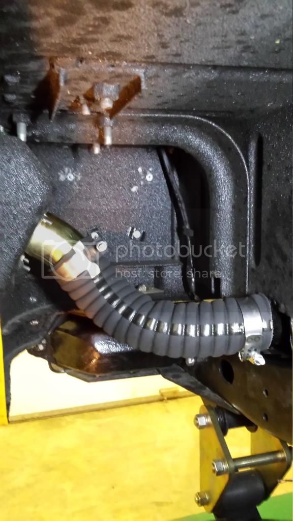

On a positive note seems like the the 5th or (6th) time is a charm because cruiser parts finally delivered a power steering gear box that doesnt leak. I was getting a bit tired for swapping them out. This week i'll be working on getting the auxillary tanks installed and plumbed so i'll try to ad a few photos of that.

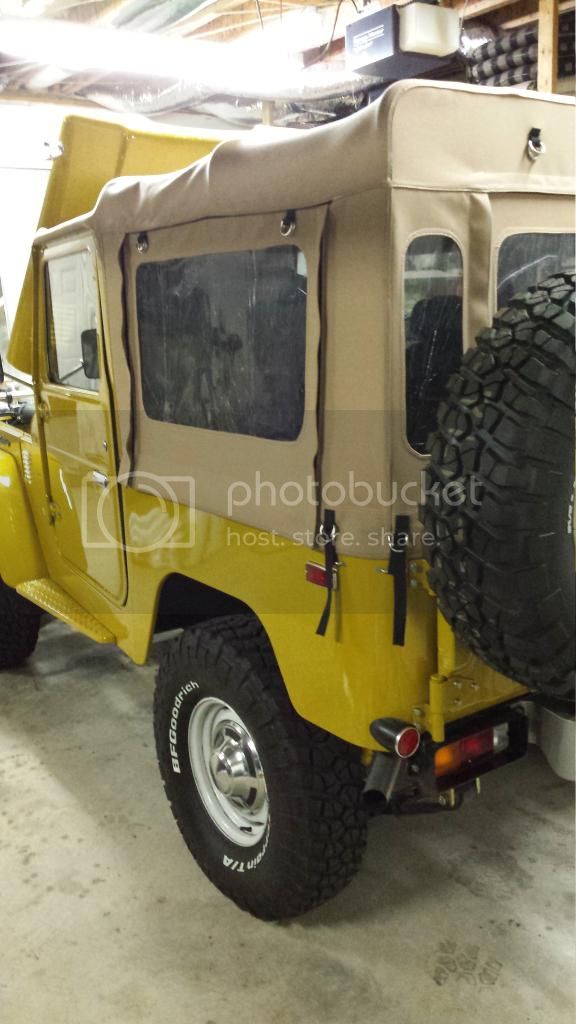

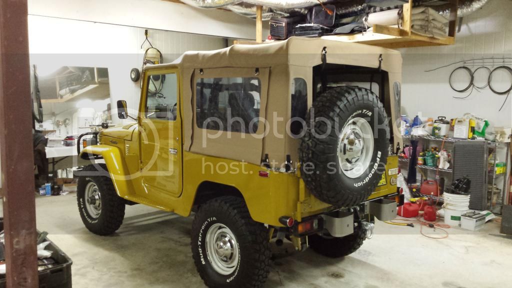

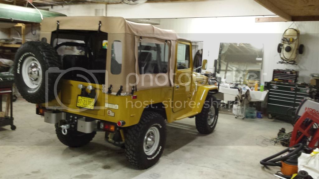

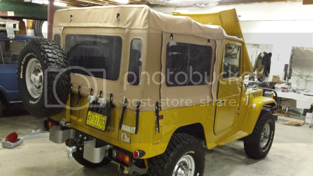

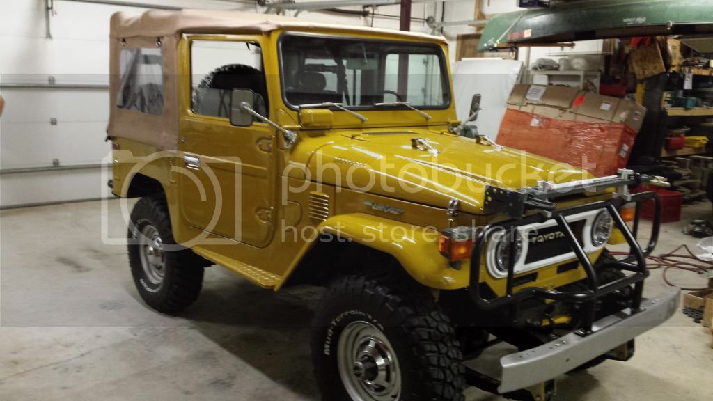

Tucker also ordered a new soft top from troll hole with the new sunbrella material as well as zip out windows, they promised it should be here by the 9th of august which will give us just enough time to get the fastener system sorted out before heading in our convoy (i'll be driving my 40) to Ouray, Colorado on the 23rd for a proper test drive!

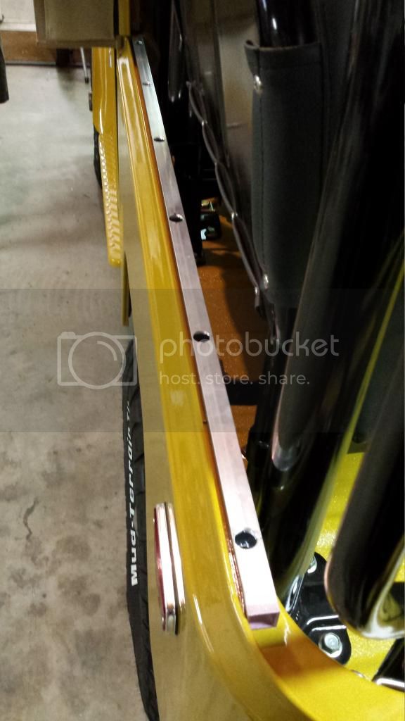

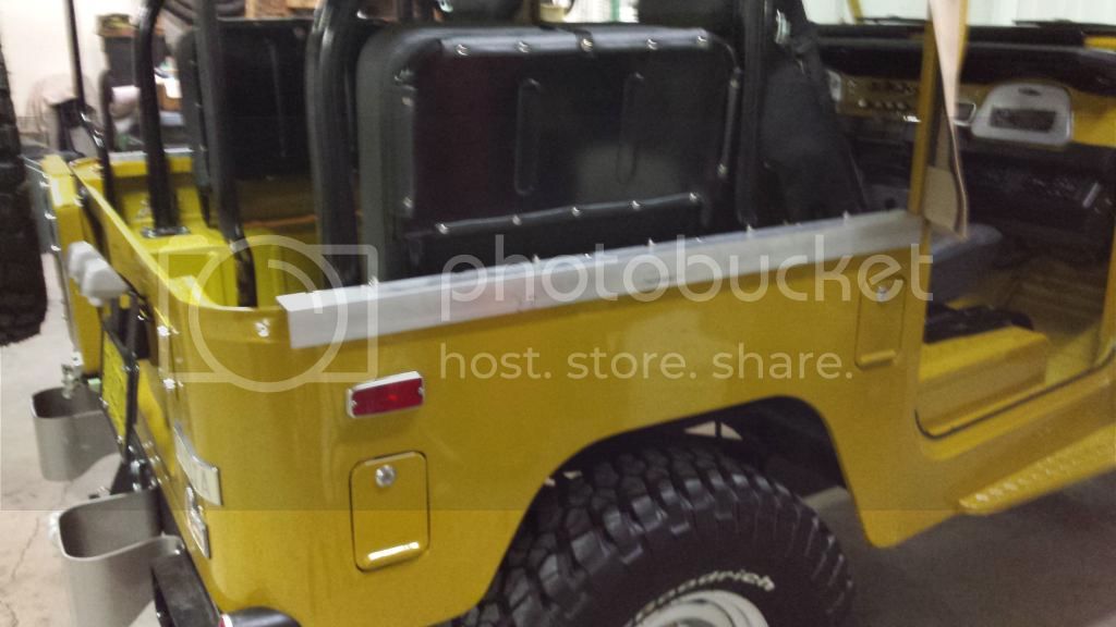

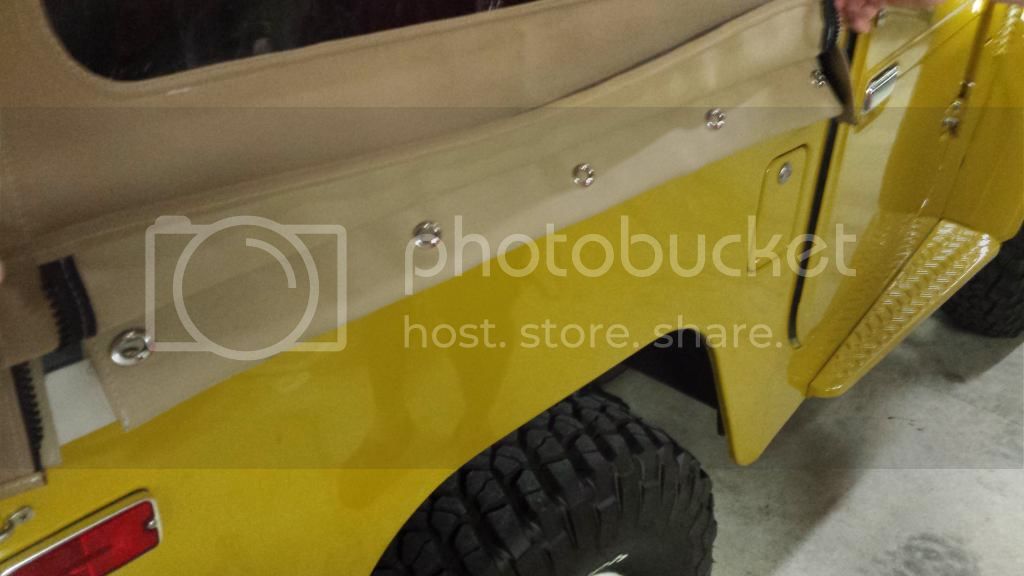

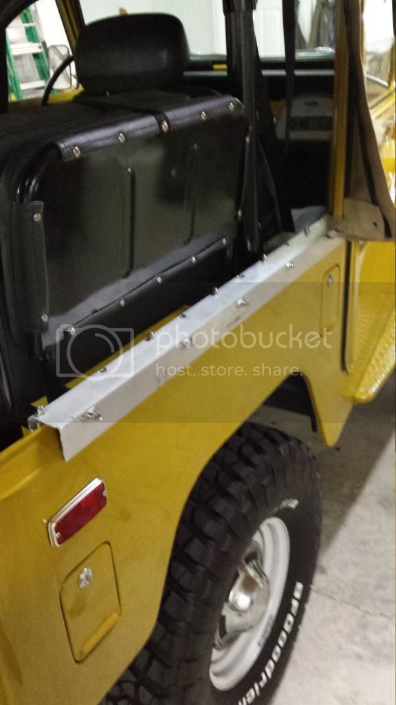

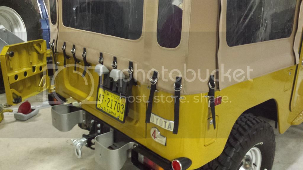

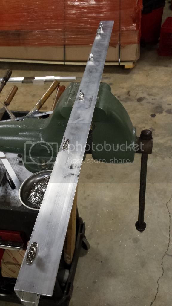

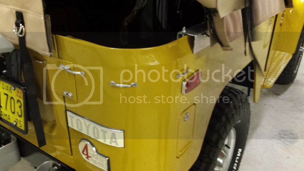

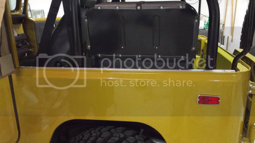

Ended up redoing the attachments for the corners and tucker made the call to drill the tub for footman loops. Stainless footman loops and hardware, we made a attachment system for the grommets out of aluminum.
That soft top really makes me wish I had more money and a larger garage. :cheers:
