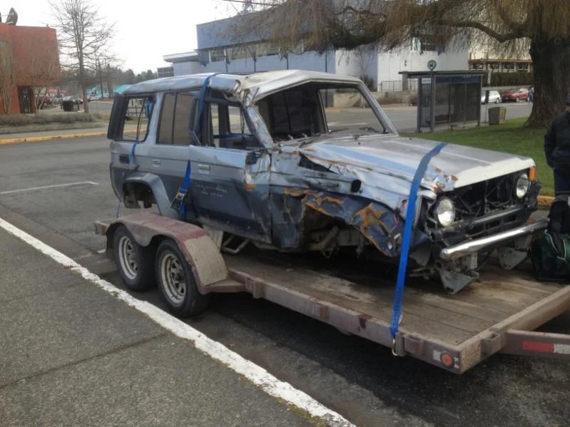

A doner was picked up today. Sure it may not look like much but that is because it isn't much...
