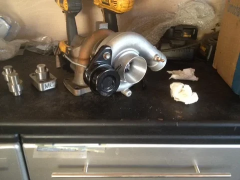

Turbo arrives Friday with new 6 shooters and marlin big bearing kit.
Next is 4x4 labs high steer and a Detroit locka
Some go fast parts
