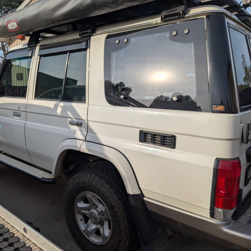

I have been searching and searching almost everyday and stumbled across this:
They look really nice. I'm now in the process of trying to figure out what to do about side boxes on the back windows. I can't find anyone that makes them, so I may have to do it myself.

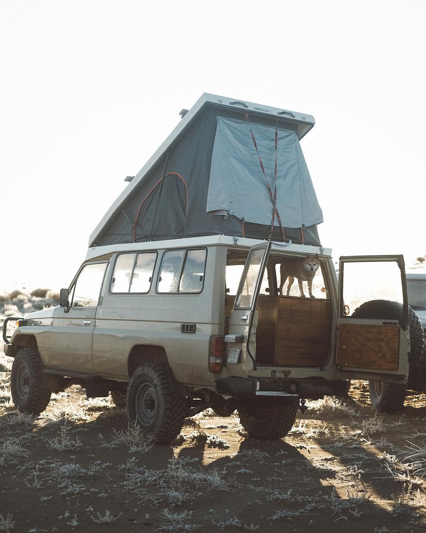

I finally camped in this one. Felt the holidays were a perfect time to explore an already desolate location with the reassurance everyone would be at home. 3 of us that couldn't care less about Christmas got out there. It was cold, but the alucab made me feel like a damn prince.

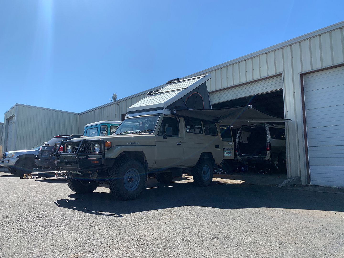

Got a Shadow Awning. This was absolutely hell to install and should really be done at the same time as the top.
We had the same issue as well. We did ask about installing the brackets to the roof before installing the roof but Alu Cab said it wasn’t possible.

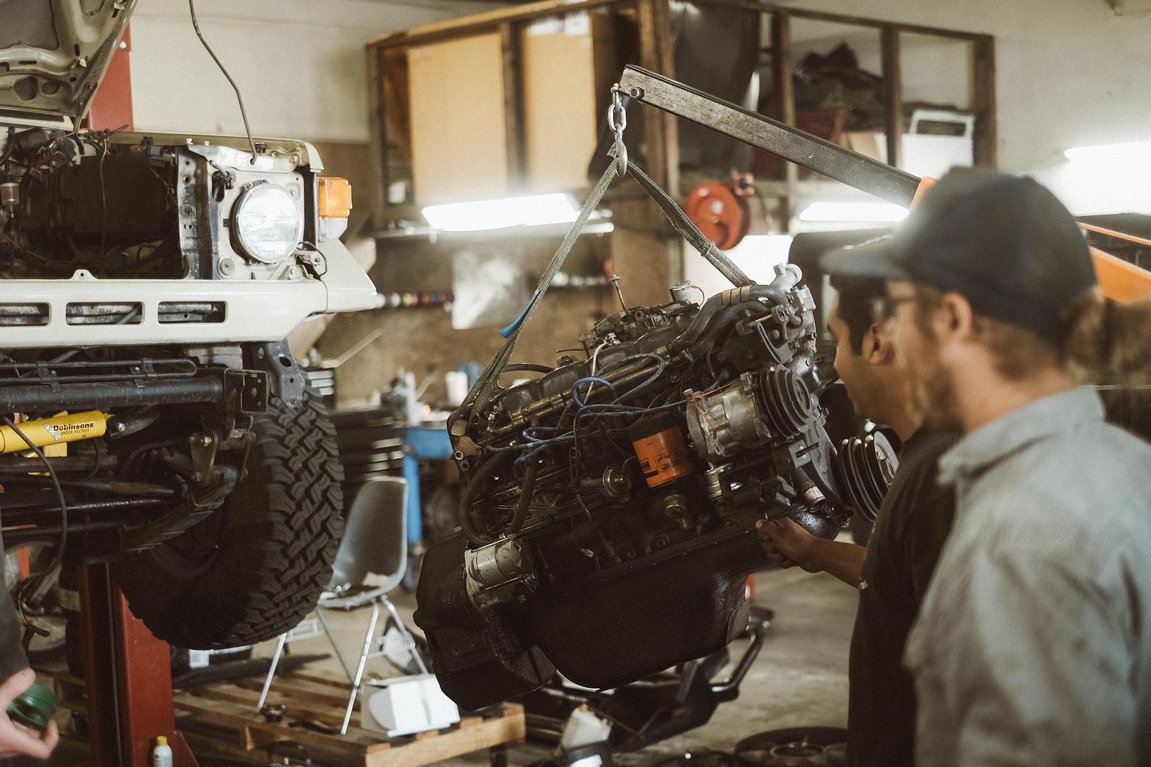

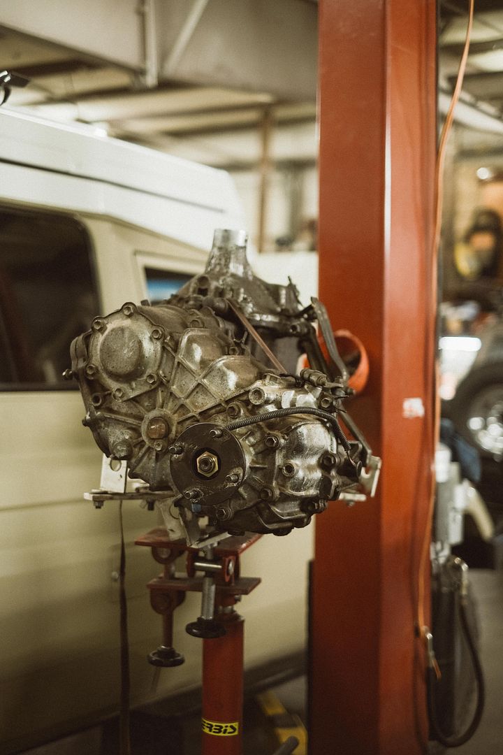

After one final camp trip getting 8mpg and smoking up a storm, I tore the 3F out along with the 10spline H55:

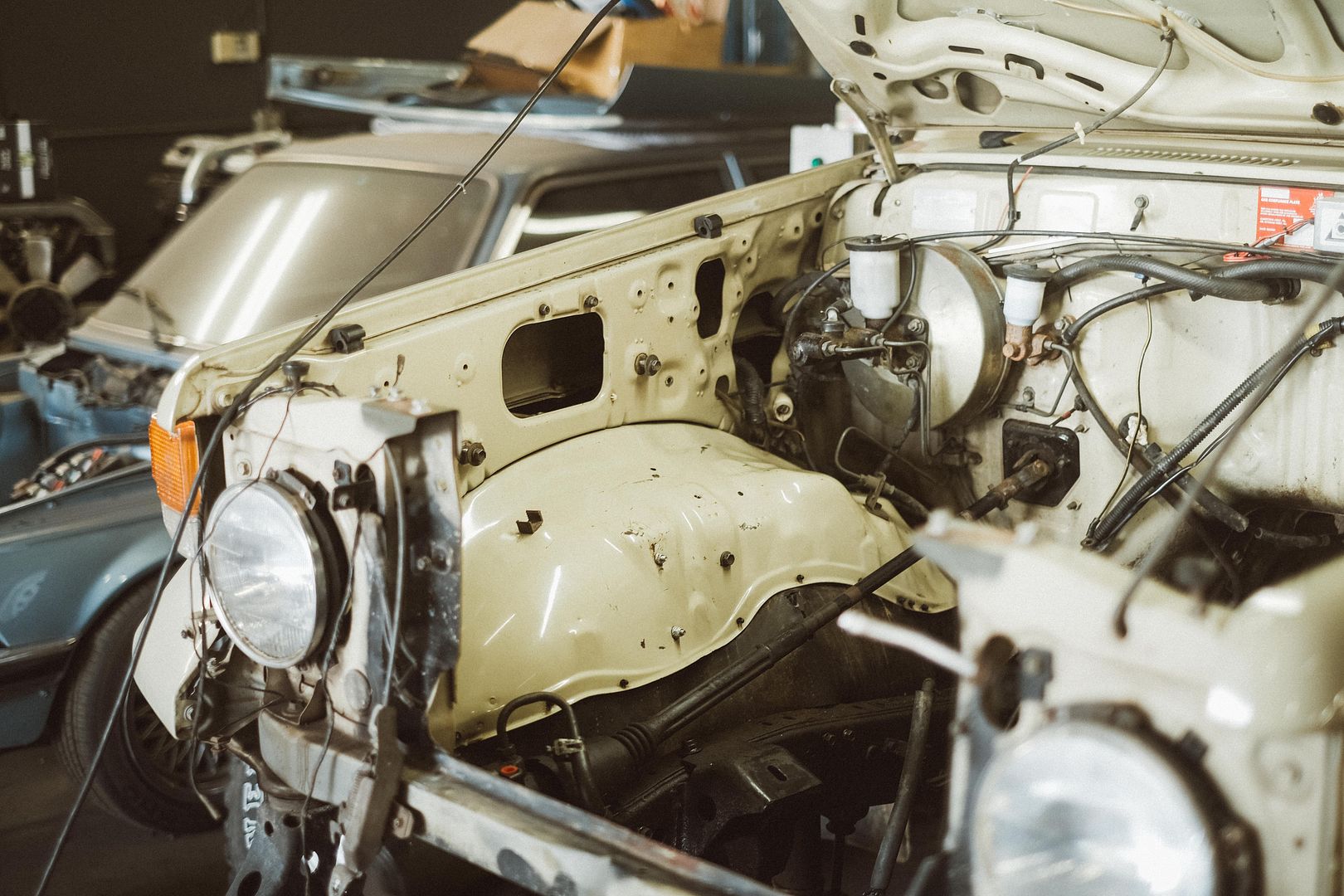

A complete delousing of the engine bay ensued. Junk removed-

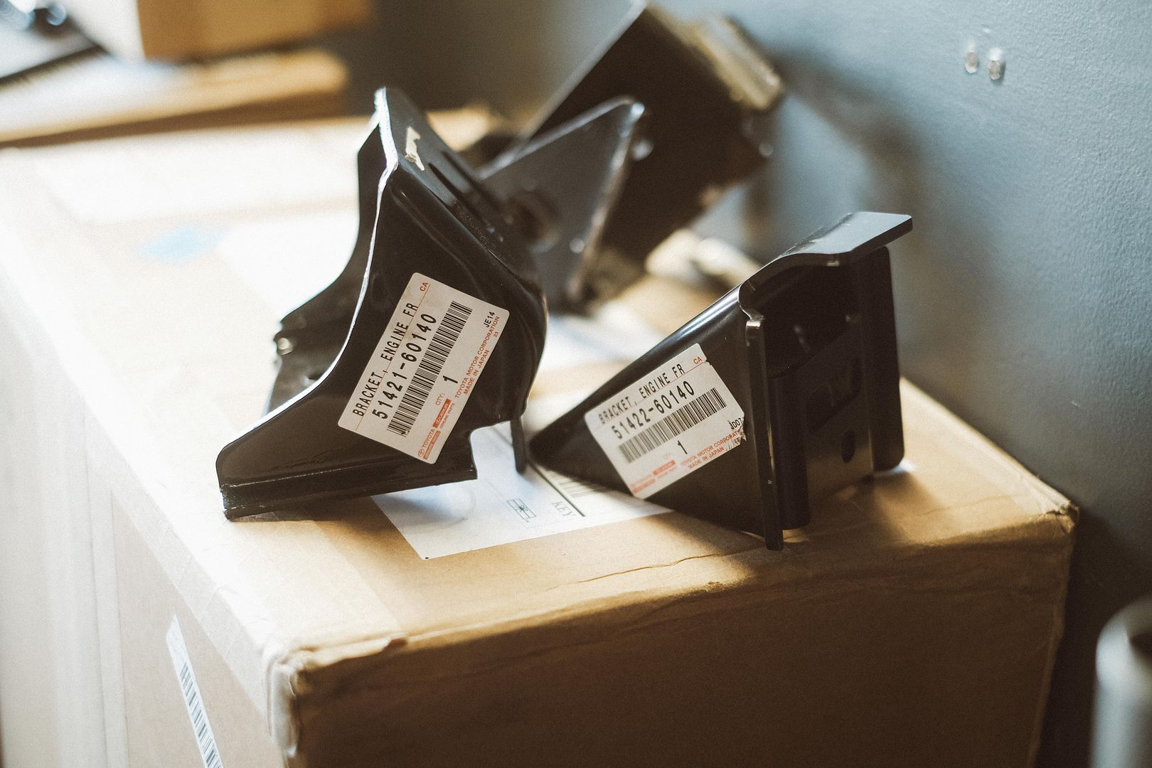

Engine mounts sourced

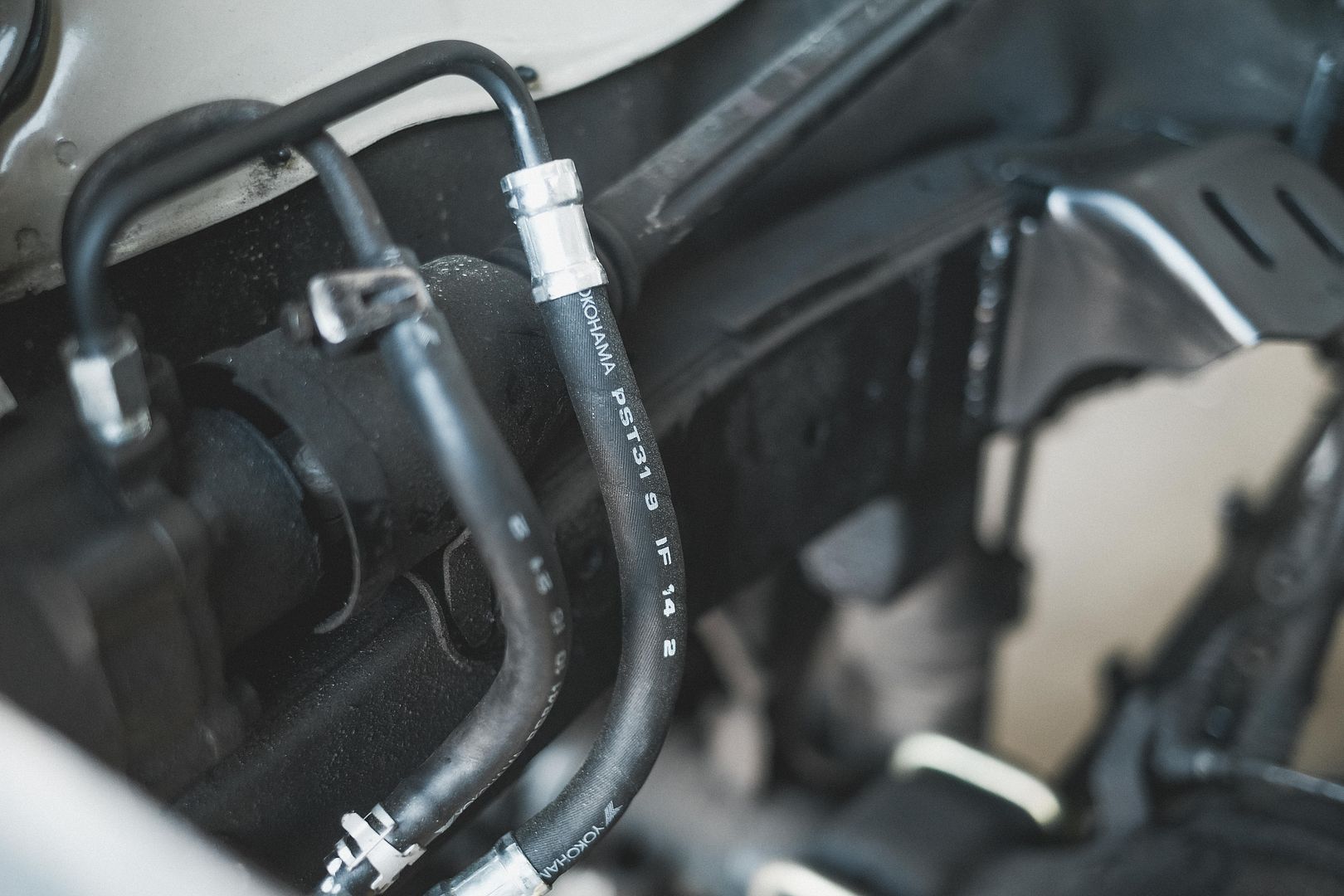

Old mounts cut off and the new ones welded into place. Also, HZJ75 power steering lines.

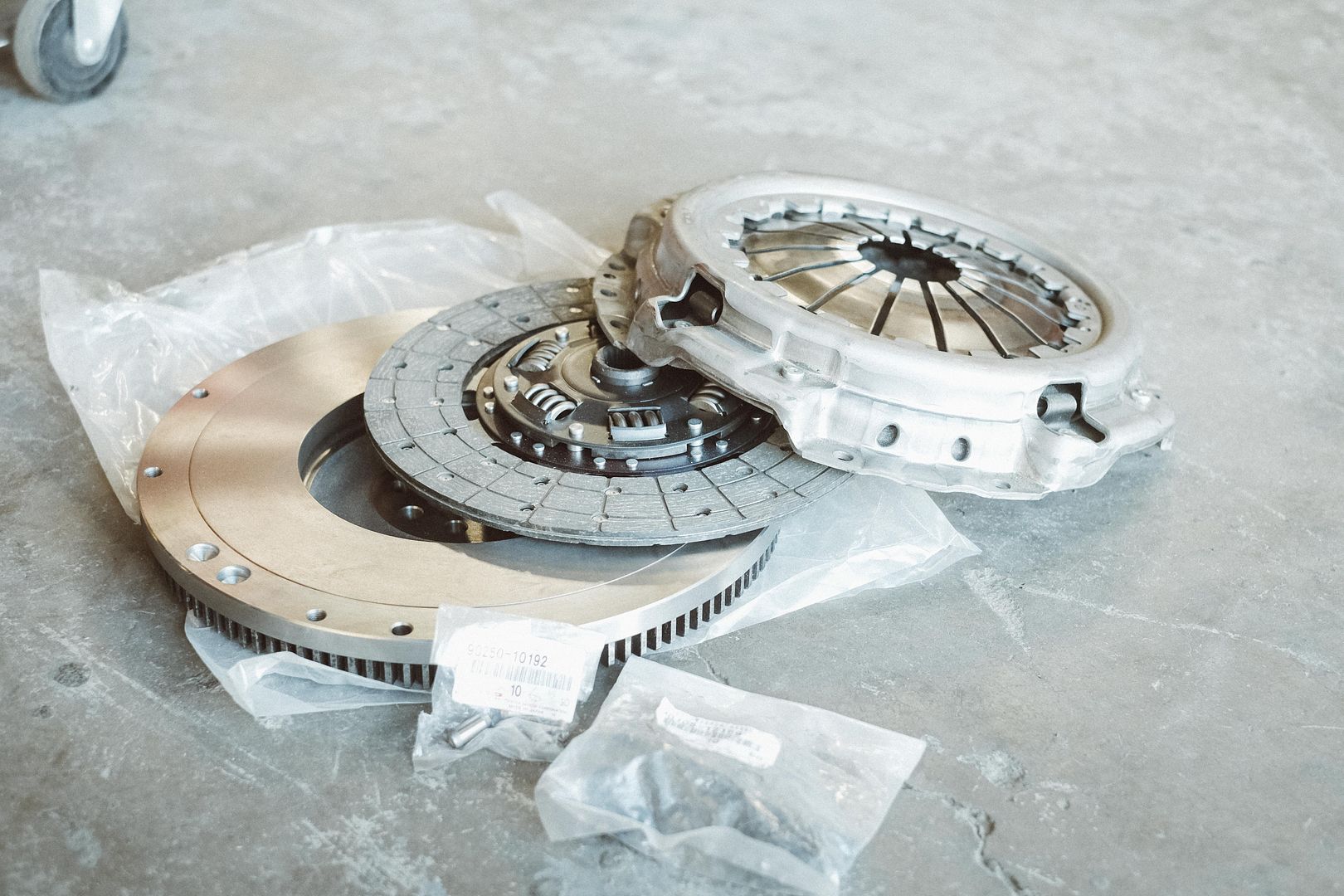

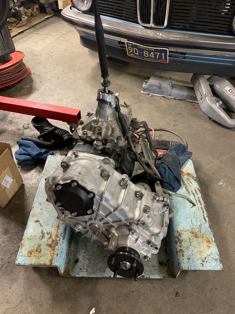

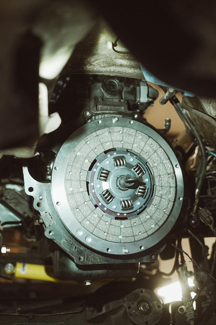

Somewhere in here the new engine was installed, followed by the transmission. I only have this picture of the clutch/flywheel/pressure plate combo though!
Snuck a new Gturbo in there as well!
