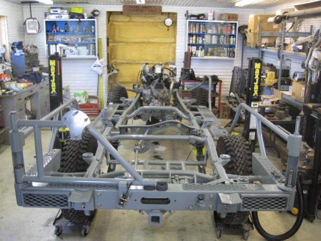

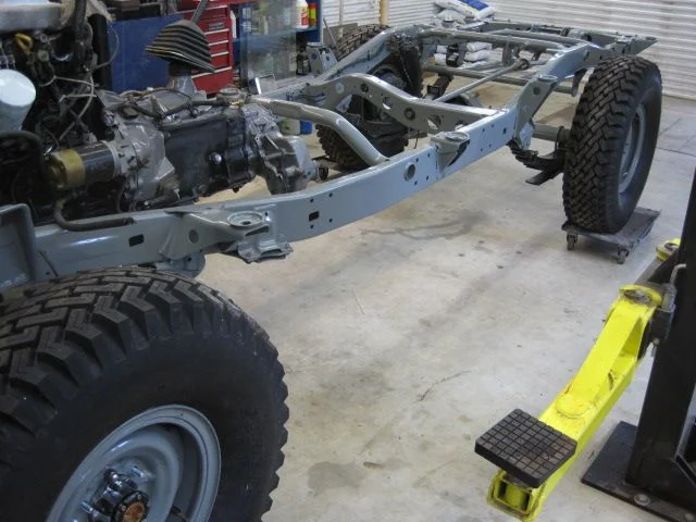

an idea how tall the truck is with the 36" tires and 2.5" lift ...
