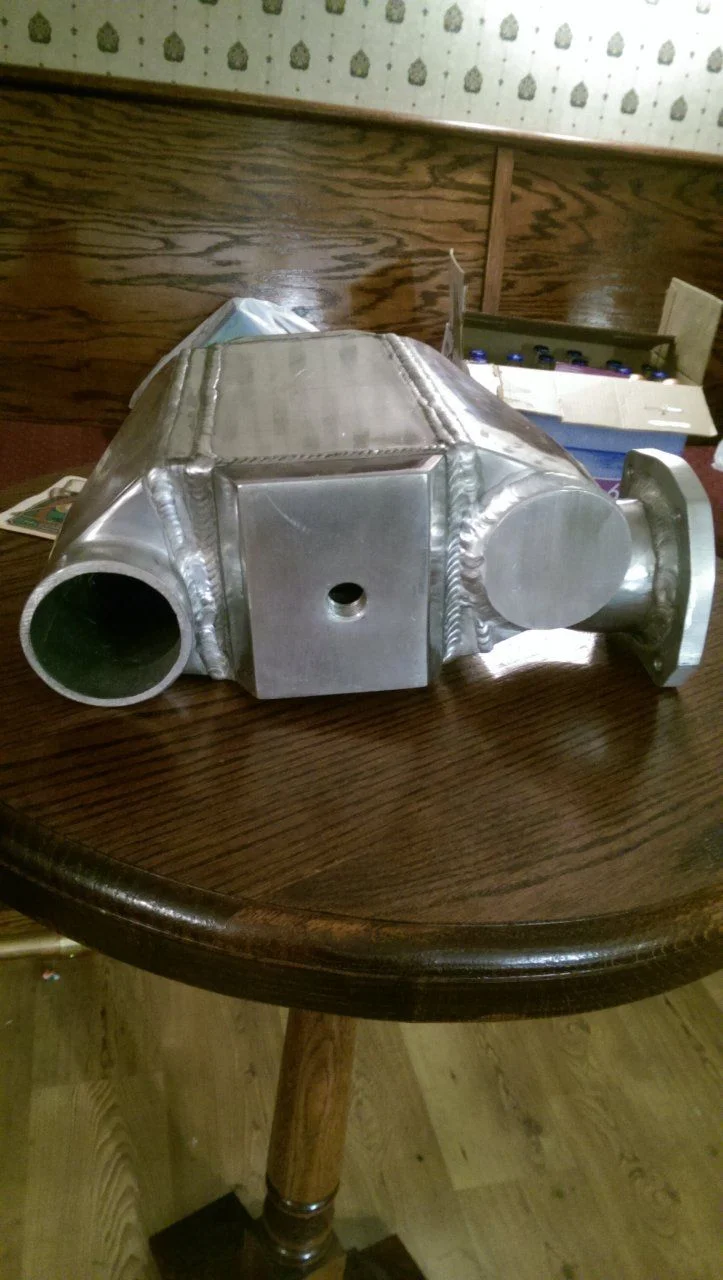

I've been working on one myself. I've gotten as far as the intercooler and designed the tank. It mounts to the top of the engine. Got 6 of these in my basement
Ooooooooo! Joey, my maaaan!
Rick if you get your design all laid out, I would send it to Bell and have them actually make them. The only reason I am saying that is. I have that Frozen Boost 4.5"x4.5" water/air core and it is not great. With a little more use specific shaping I think you should be able to fit a 4"x5.5" or 4.5"x6.5" would be even better.
I've been working on one myself. I've gotten as far as the intercooler and designed the tank. It mounts to the top of the engine. Got 6 of these in my basementView attachment 1300715
Right now I'm working through what I feel is a bigger issue with our trucks when SC'd. But I've got trucks to work on and my truck is tied up at the fabricator on another project.
I'm sure a better core is better but I'm a cheap guy and if a cheaper core is good enough then that is what I'll use. I've posted this pic before and it's really not very high on my priority list at this point. Probably won't be until I decide to go with a smaller pulley and even that is a ways down the road.
