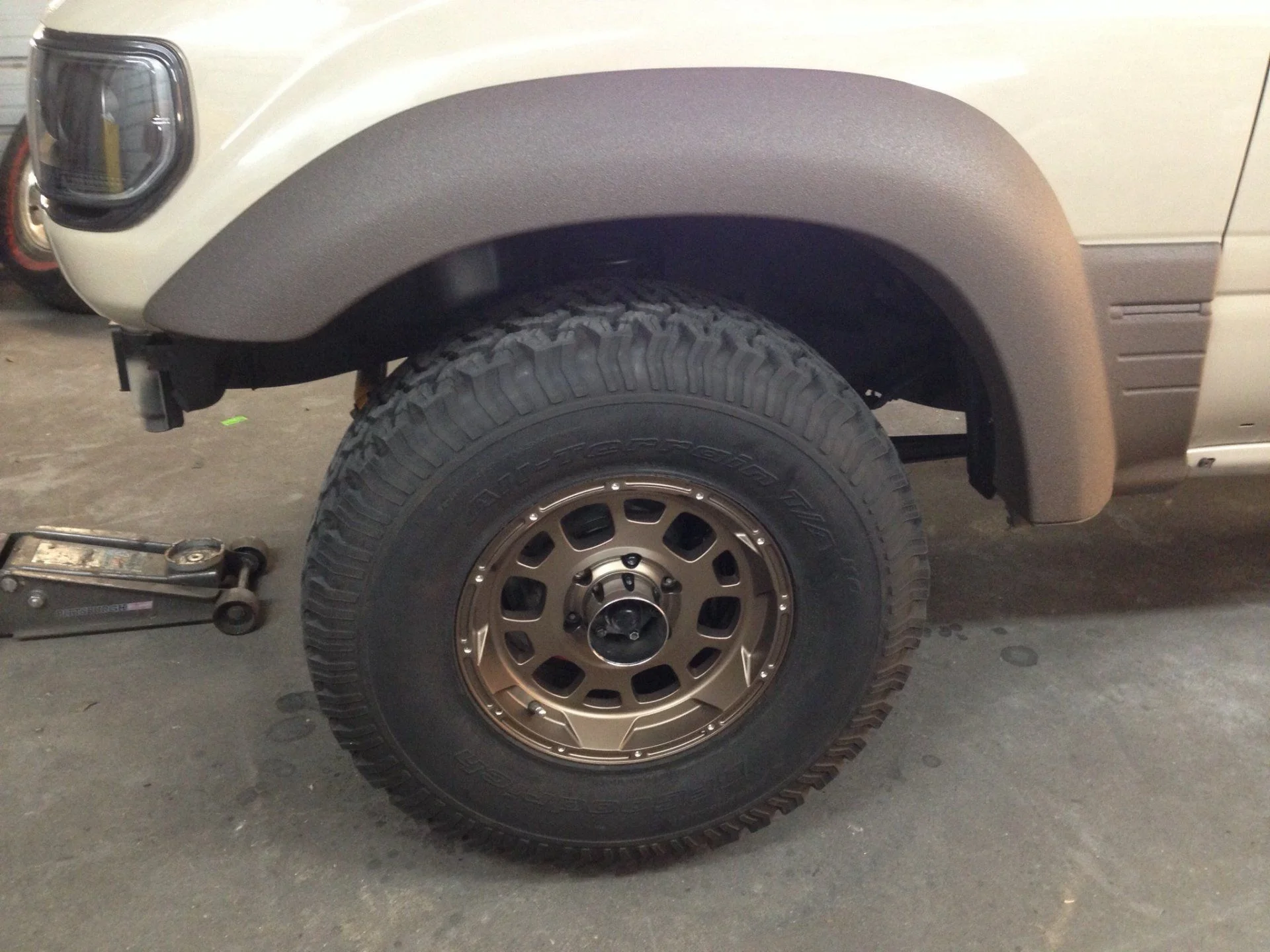

I'm 99% sure they are the same specs as my 4Runner Trail Edition wheels. 17x7.5 with 5 inches of back spacing instead of the 4.5 the 93-97s have. They will bolt up, but center caps will most likely not fit without the use of spacers, and they will be pretty far in the flares. On my 92 with the skinnier flares they are just about perfect. Still a little inset, but that keeps the side of the truck protected.

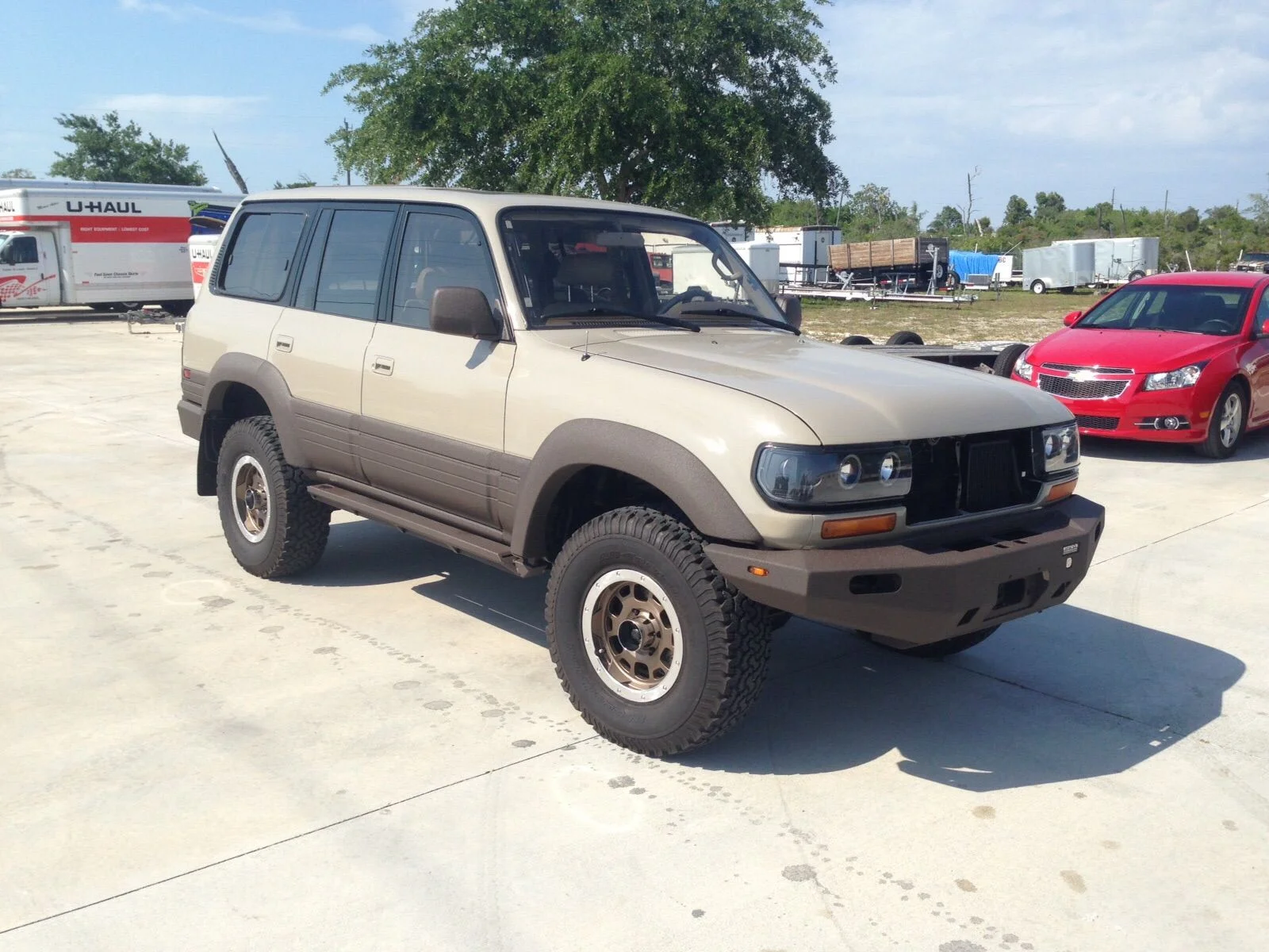

Not exactly the same, but the normal TRD wheels look good on the 80 as well. I couldn't tell you if he had spacers or not, I saw this one in a Home Depot lot in Hillsboro.
Running the same wheels although mine are 16" - no spacers although might do so "some day" just for the look. They fit just fine (I didn't look if the dimensions are the same as those inquired by the OP).
My wheels are slightly different but I bet the dimensions are similar. Mine are 16 inch rims, and I have 1 1/2" spacers. I had to grind a tiny bit of clearance under the center cap area for the six flange bolts on the rear- no big deal. To get the TRD cap to fit the front, I had to pry the metal off the plastic backer, cut a hole in the plastic, and build it up with foam two sided emblem tape. This gave clearance for the dust cap sticking out. The rear caps I run without the little wire retainer and have had no issues

Pretty sure you'll run into the same issues I did with the FJ TRD wheels I used for mine. You'll need to accommodate the larger hub on the 80 axel and you'll need to pace a can in the center for clearance. Pretty sure we used 1.5in spacers for these.
