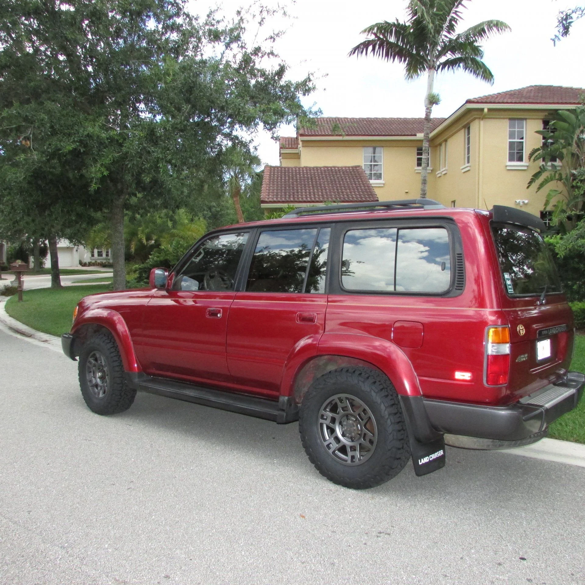

Put a set on my ‘97. Genuine TRD Pros that we’re takeoffs from the dealer. They bolt right up with no mods. These wheels are 7x17 and have less back spacing than other 4Runner wheels, so you don’t need spacers, but the center caps won’t fit. Here’s a pic of my 323,000 mile beater with them on. Tires are 285-70-17 Toyos. Hope this helps!

Hmm, I thought I remembered it coming up. I believe consensus is wheels fit without spacers, however to get caps on requires spacers. Pretty sure this truck has spacers but can’t find the thread.
