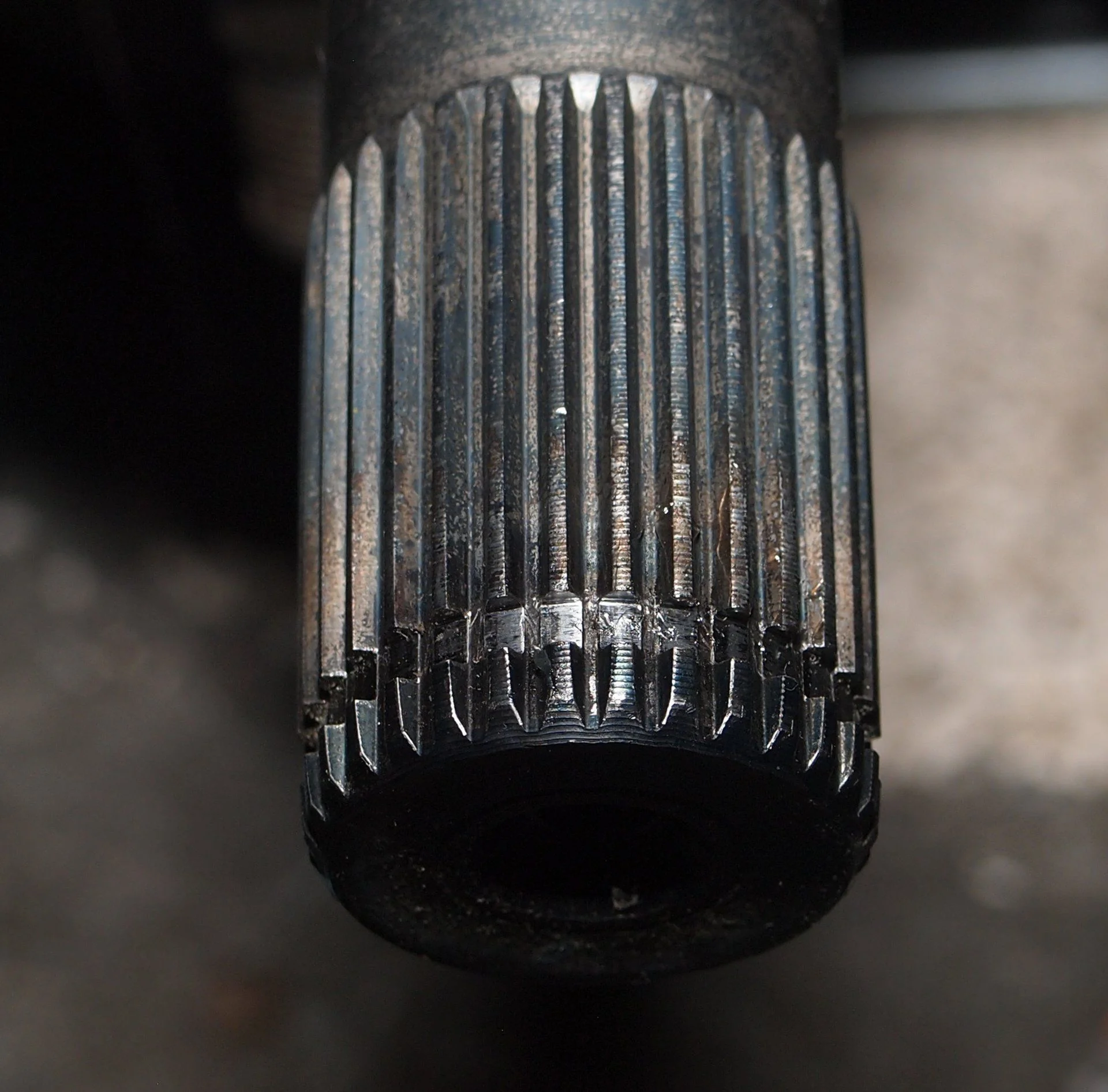

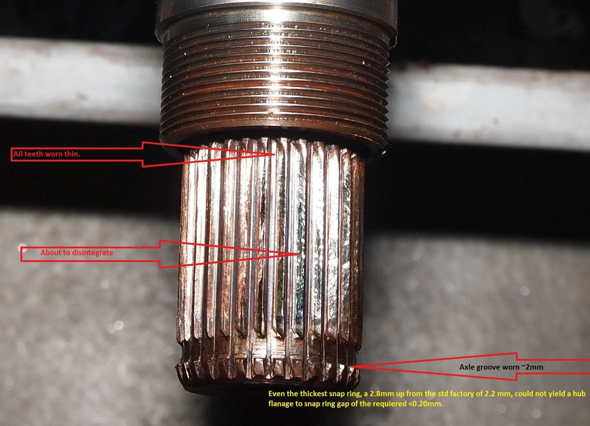

Unfortunately, these stripped hub flanges and damage axle spline are caused by improper wheel bearing service 99.9% of the time. It also requires that the service be done by the book (FSM). All to often wheel bearing service is not done or done improperly.
This is the one result:
When hub flange splines (teeth) worn-out, like below. The axle is also.
New hub flange.
Axle of FDS.
New FDS axle splines (teeth)

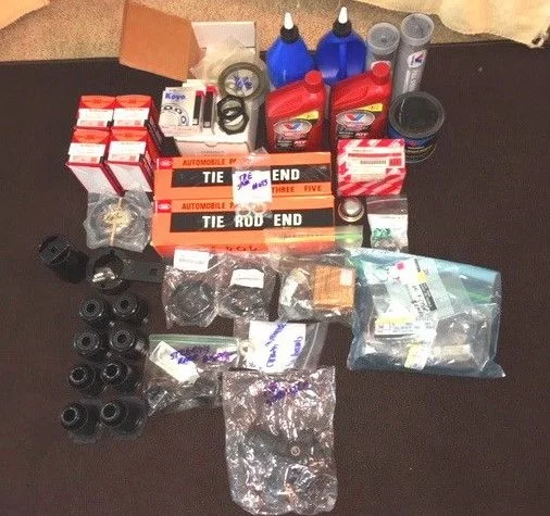

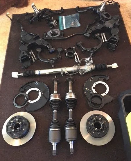

This is the noise of money being stripped out of your wallet. Worse than scratching a chalkboard IMHO
Well... fortunately this happened shortly before I was going to 'go through' the front end anyway.
But yes, copious amounts of money were bled from my wallet.
I opted to replace/refurbish everything....and I do mean everything.
There were components that were still good.....but since I was already deep into the project, just replaced them all.
I'm retired and had the time.
