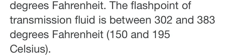

only way I had it come close was on a 86 truck with an auto trans the vent on top was clogged up and back pressure pust the auto trans fuild out the dips stick onto the exhaust, hell all they did was smoke. You would have to get it HOT HOT HOT for it to burn.Wondering if he just burnt the fluid, Not actual flame?
Doubt the transmission would even be functioning at this point:
